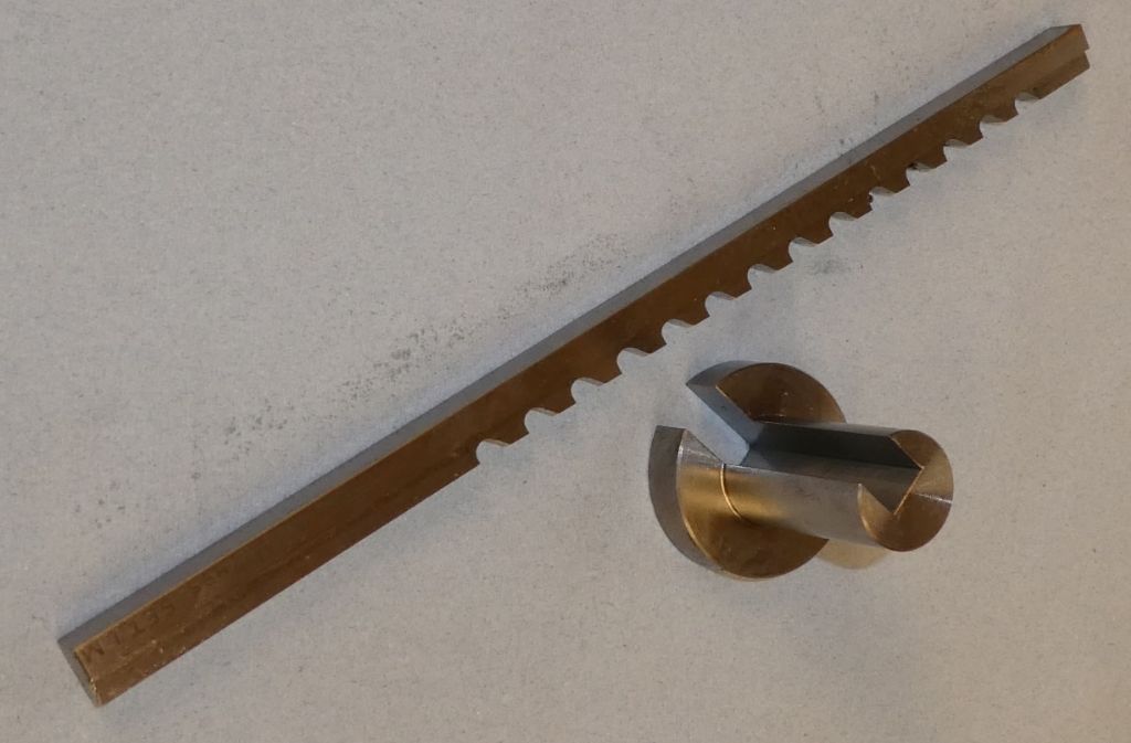

        Latest mod to the lathe completed this afternoon. This was to fit a new 80 teeth gear to replace the 40 teeth gear on the Norton gearbox input shaft in order to reduce the feed rate which on this lathe is to fast for good surface finishes.
        In this instance I bought a ready made gear online and turned of the excess meat to suit. The bore was opened up as well to fit the 18mm diameter gearbox shaft. I don’t know what they made the gear from but it wasn’t mild steel. It was tough stuff and the swarf peeled away blue even with flood coolant. Half a dozen burns later and the job was done. (I must remember not to wear T shirt and shorts when doing this sort of thing!)
        The 5mm wide keyway was next. I was lucky enough to pick up a new 5mm MARLCO broach at a car boot earlier this year for 75p that the seller described as a “file”. I already acquired a decent sized arbour press around three years ago (and have never used since) so I was almost ready for the keyway but for one small thing – I didn’t have a broaching bush the right size.
        A day later I finished making the bush and this afternoon I cut the keyway with the “file”.
        The new gear keyed onto the gear box shaft snugly………

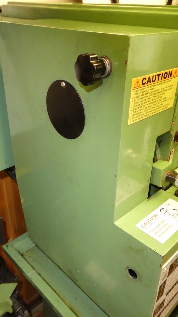

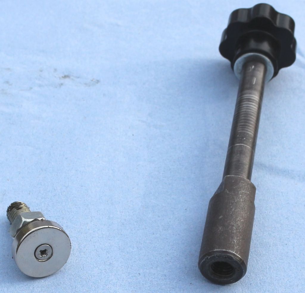

        …………. and that would have been that but for yet another problem. The gear having a much larger diameter than the 40 teeth one it was to replace, fouled on the hinged gear cover closing mechanism preventing the door from shutting.
        I fixed this by modifying the mechanism and re-sighting it on the cover. I was not keen on drilling the headstock casting to take a new stud so instead I made a little adjustable adaptor from an M8 nut and bolt which holds a 3/4” diameter countersunk neodymium magnet. The adaptor screws onto the end of the original closing mechanism.
        It works so well that the door snaps shut when it is ½” from the casting.
        With the greatly reduced feed speed I am easily able achieve a much better finish than before. A satisfyingly successful job and well worth the effort.

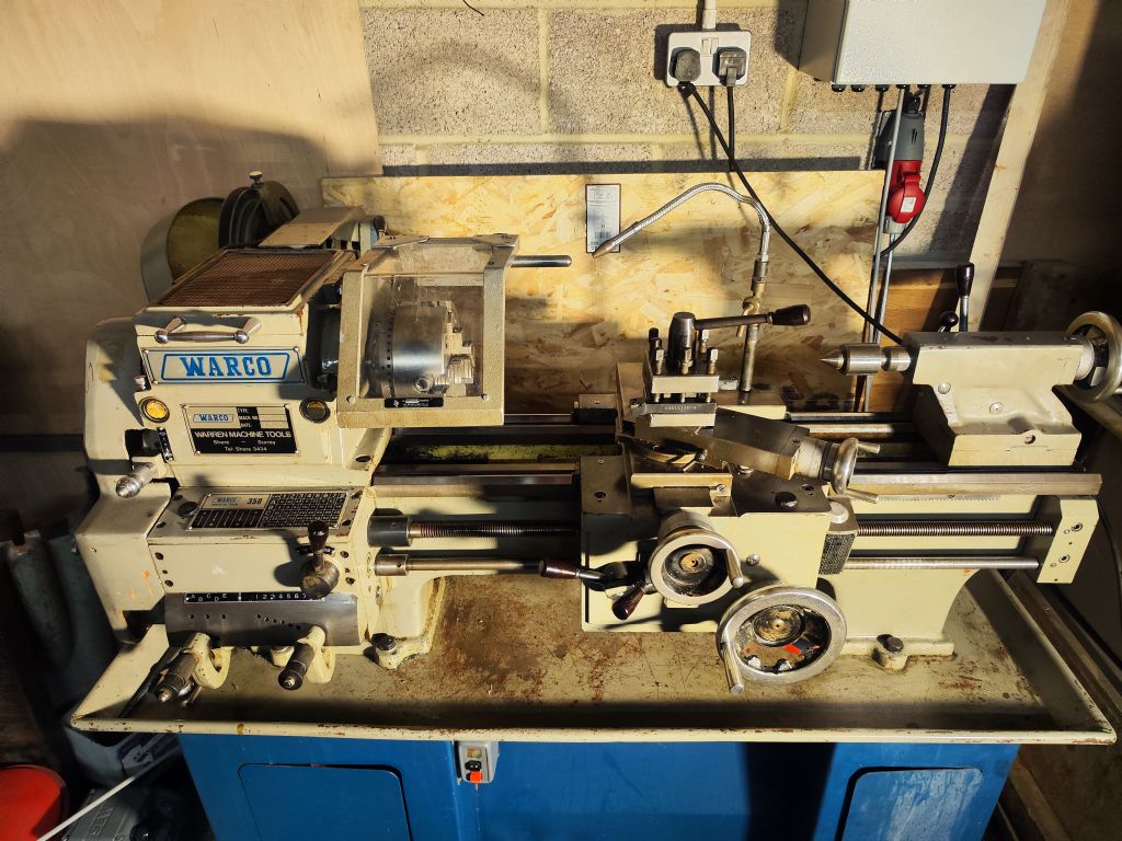

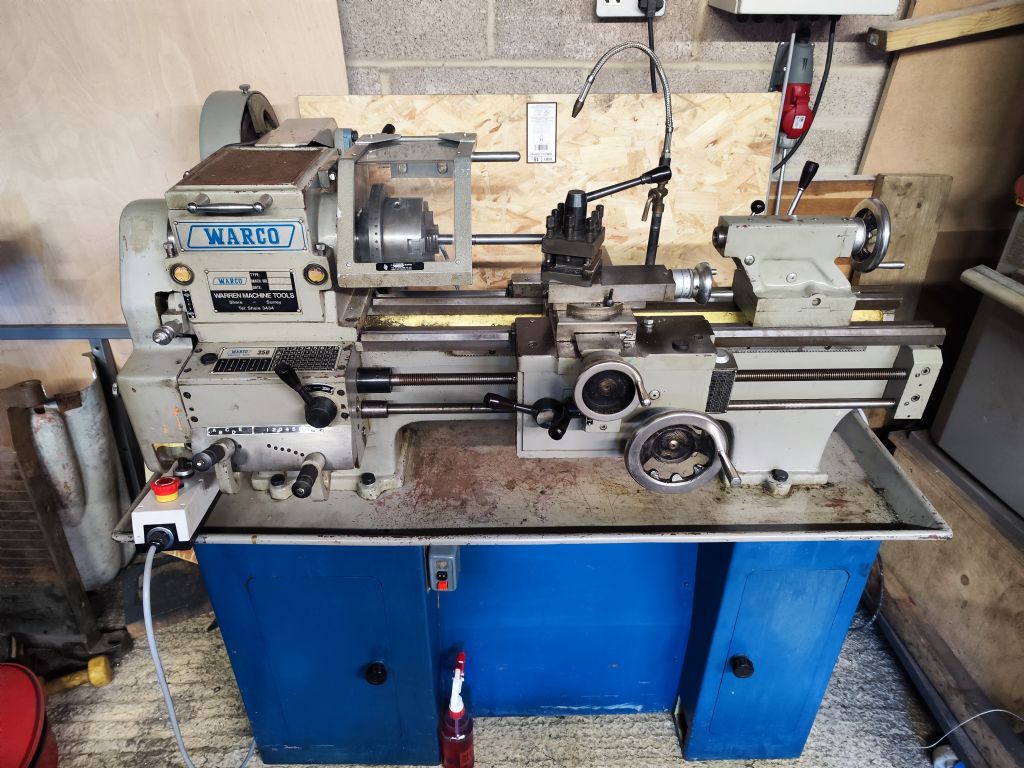

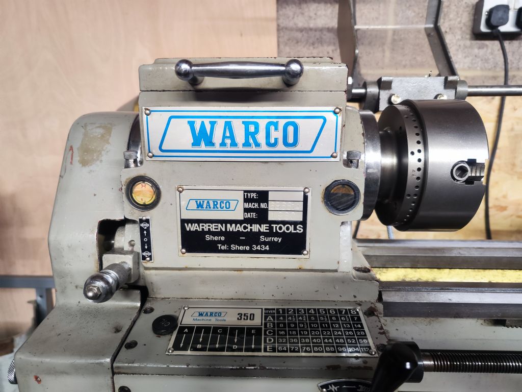

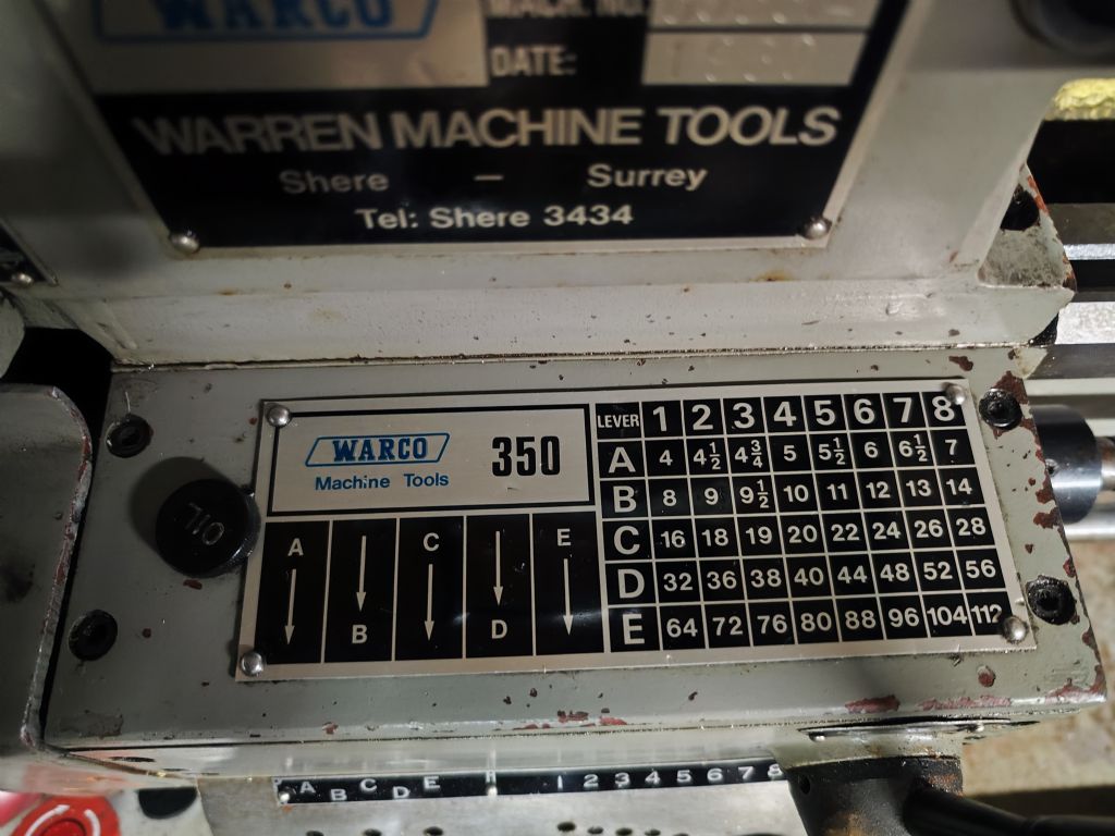

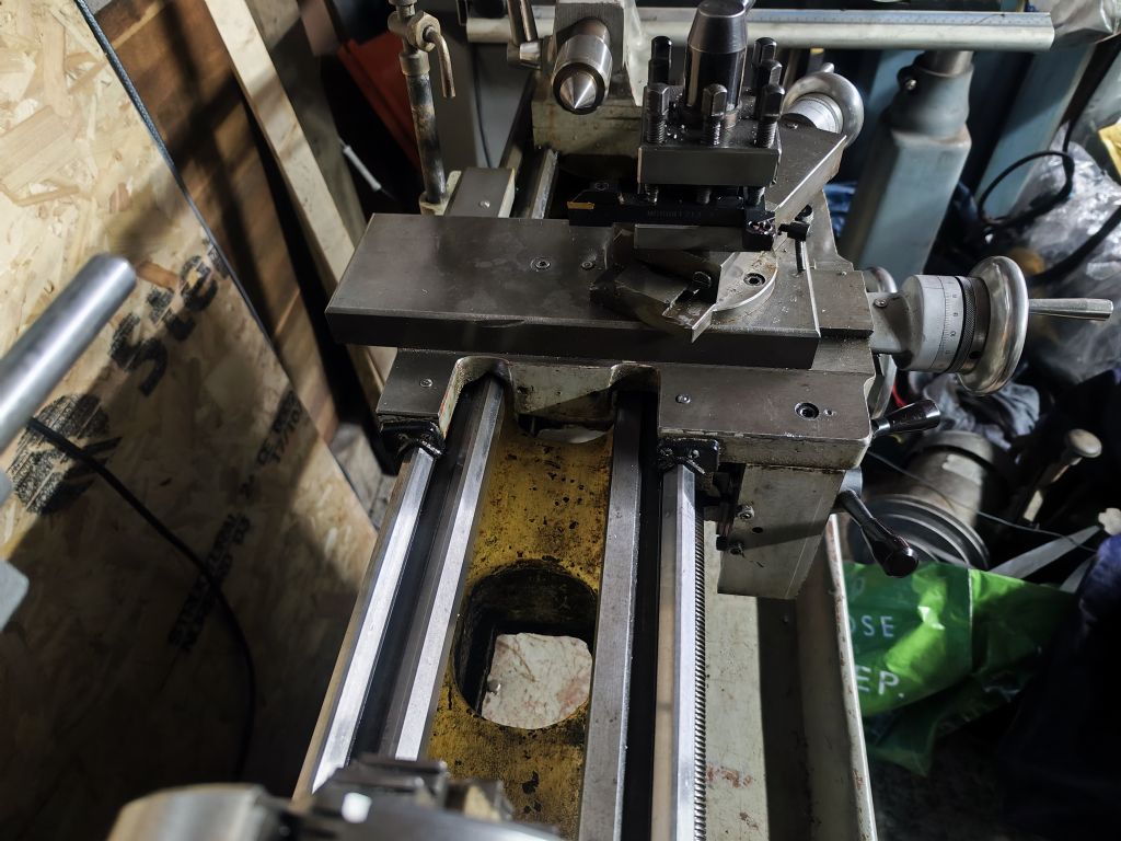

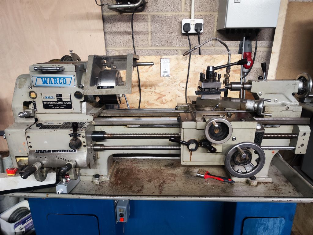

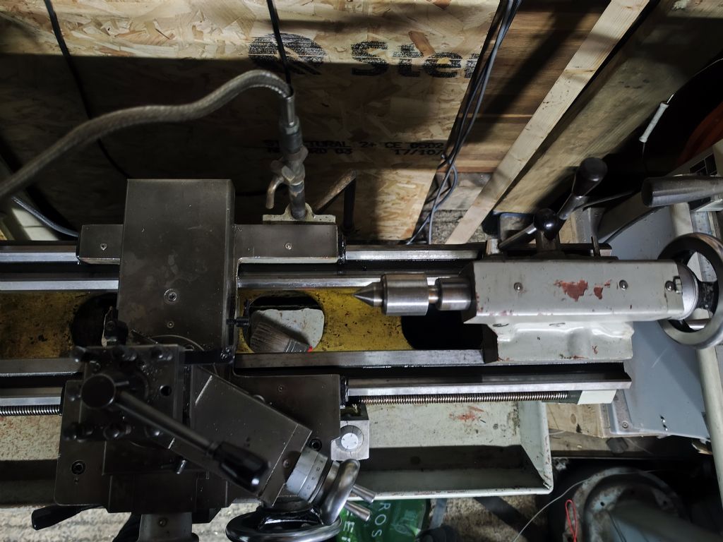

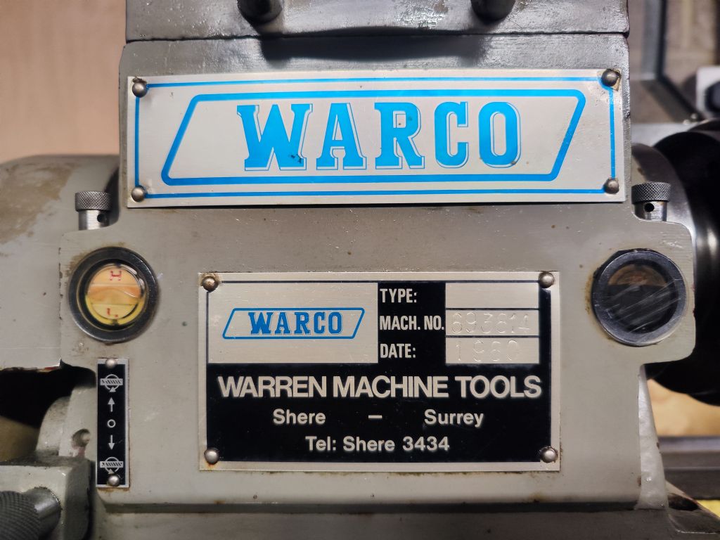

                      I believe mine has been built in Taiwan. It has got three vee guideways and was built in 1980.
                      It looks to be an exact copy of the Lantaine lathe (probably the original manufacturer).
                      Taiwanese lathes
                      I went and took a few photos quickly.
                      The lighting is not great in that part of the garage.
                      Warco 350 Lathe
                      Warco 350 Lathe
                      Warco 350 Lathe
                      Warco 350 Lathe
                      Warco 350 Lathe
                      Warco 350 Lathe
                      Warco 350 Lathe
                      Warco 350 Lathe

                        Jan, thanks for the photos, yes, that is the Iathe I remember. A very good lathe, and the triple vee guidways are a very nice feature.
                        It is the same lathe that was also just branded as the Lantaine, and also branded as Lam as well as other names. A quality Taiwanese belt drive lathe, but the triple vee ways is what distinguishes it from similar versions.
                         Would be interesting to know if it has a similar fine feedrate to Riks much later Chinese BH600, which is clearly descended from it.

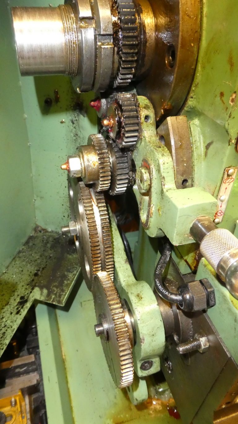

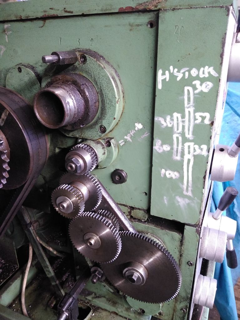

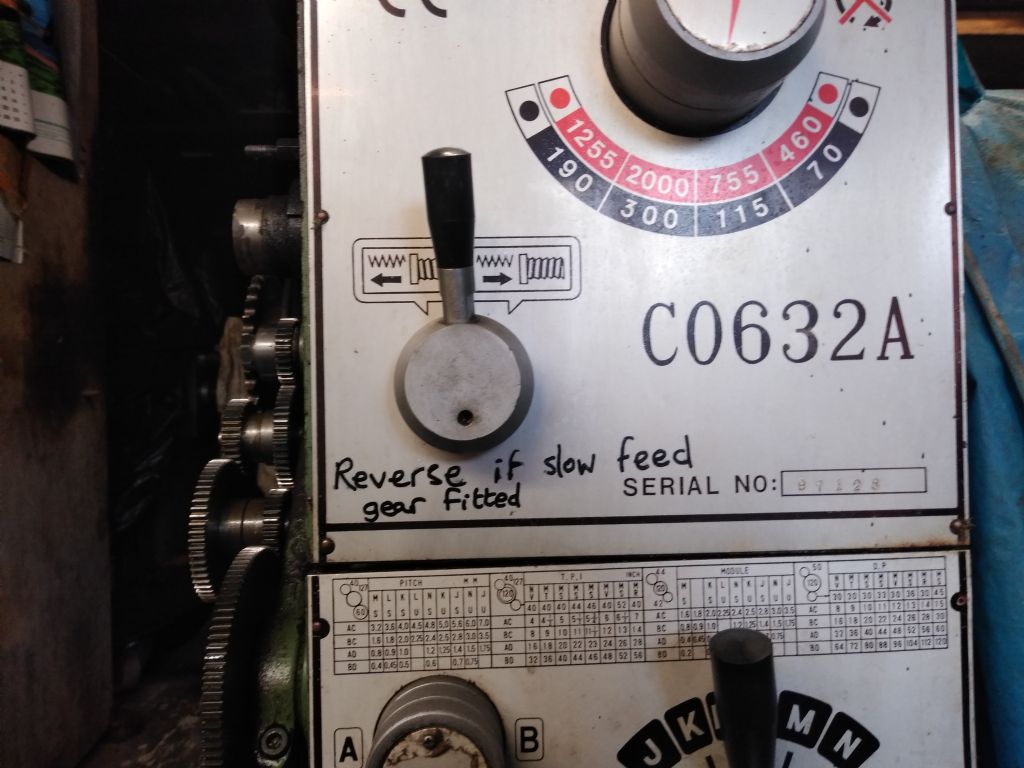

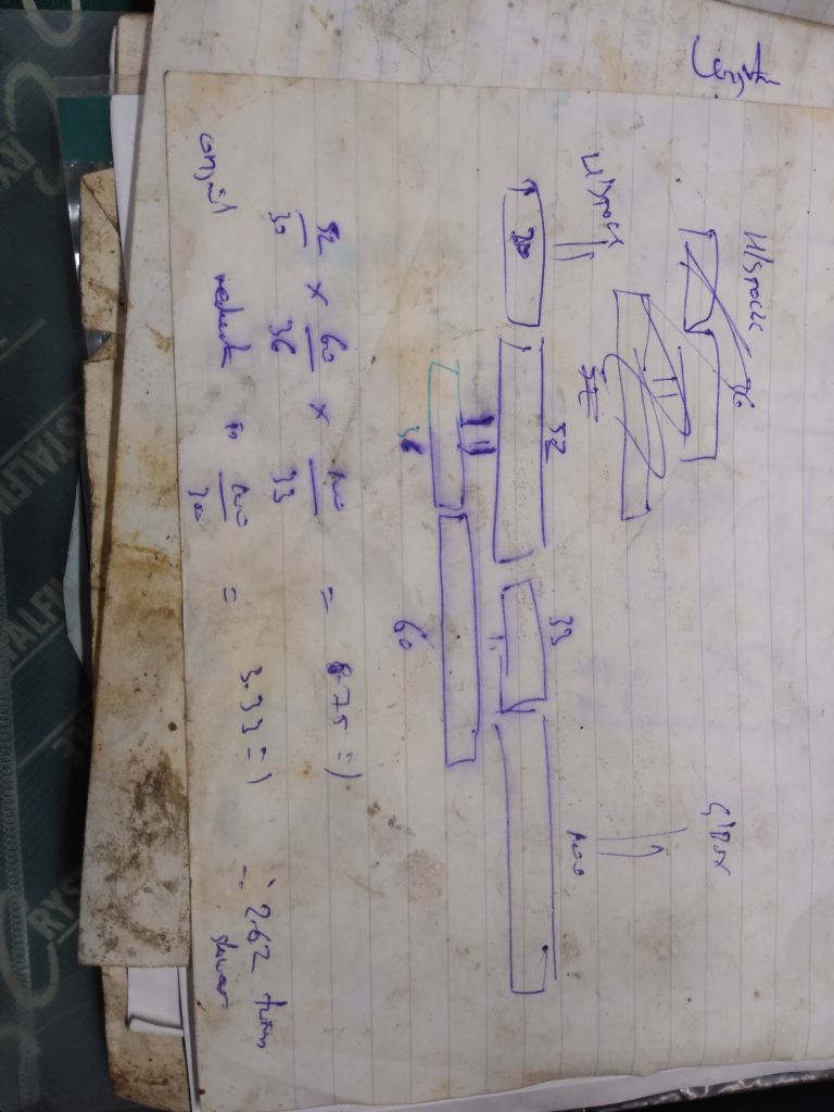

                                  I had a similar problem with the too-fast feed rate on my Chester Coventry 0632A lathe, which is basically (I think) identical to Warco GH1330. My lathe is from 1997 when Chester machines were painted green, the same as Warco. Now of course they are painted grey.
                                  I managed to use gears from the existing set of change gears and arranged a compound gear drive such that the gear ratio was modified by a factor of 2.62 slower than the original set up. I had to make new studs for the gear sets as well as a slight modification to the gear quadrant bracket. The slot in the bracket was lengthened by 7mm in order to just accommodate the gear stud next to the spindle driver gear.
                                  The pictures show the set up, plus a very rough sketch of the layout, which is often how things are made in my workshop! Note that the feed selector lever has to be positioned opposite to as originally marked to drive the saddle or cross slide the correct way.
                                  This may also fit LatheJack's GH1330 lathe
