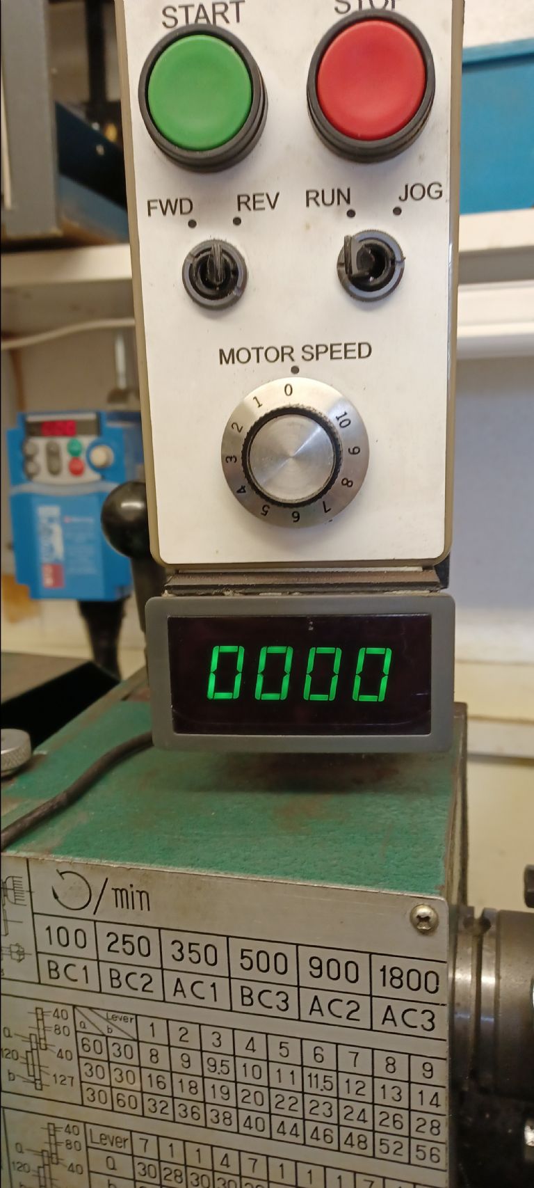

                                      Wally, one useful mod you may want to consider is adding a digital readout for the spindle speed, low cost at around £15 for a set which includes the hall sensor ready wired, the magnet and the display. Easy to fit as can be seen in the pics below, you may just see the small disc magnet sitting on the spindle at the end of the sensor.

                                                  #595890
                                                  Ron Laden
                                                    @ronladen17547
                                                    Hi Paul yes it is useful and reliable also, I got it from a well known auction site there are a number of sellers and the current price is around £16. I put one on my mill as well as the lathe. The only additional part you need to power it is a plug in 12V DC adaptor but they are as cheap as chips off the same site.
                                                    Ron
