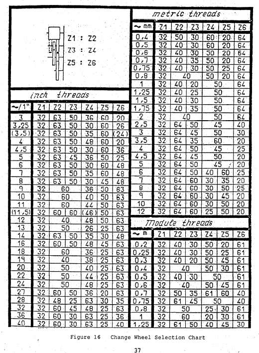

      • Hi I’m new to lathes and I’ve just bought a warco 220 without any change gears I’m having trouble trying to locate a set even warco themselves weren’t very helpful and just said they don’t stock parts for this machine I’m getting desperate now if anyone can help it would be greatly appreciated

              I presume that you have a copy of the manual?  If not you can download a pdf version from here.  (Be aware  – it’s a 25Mb file.)
              It contains, amongst other information, a table of change gear combinations to obtain various metric and Imperial screw threads. This is a screen grab from the manual:
              Warco 220 change gear chart
              That should get you started.  By judicious picking of oft-used threads, you can cherry pick which gears you need to acquire.

                Working through a couple of those gear trains looks like it came with a 4mm pitch lead screw.

                    The manual confirms your suspicions re: the lead screw. It is indeed 4mm pitch.

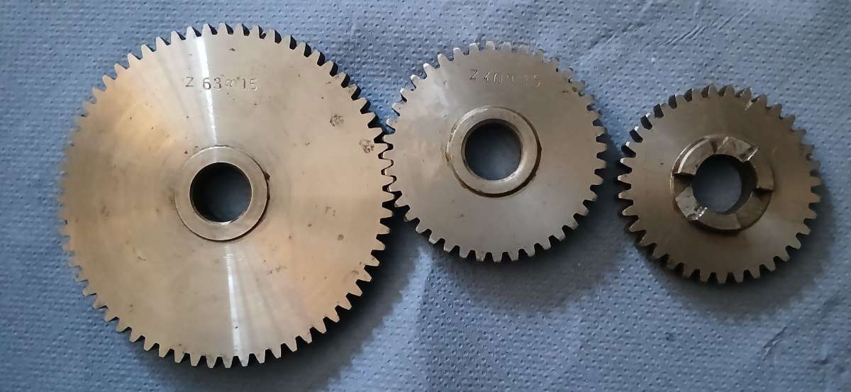

                                      Hi, Howard Lewis is right, the change gears are Module 1.5. The other thing about them is they have three dogs on one side, which interlock them to another one when in a gear chain, the dogs can be seen on the right hand wheel in the photo below.

                                        The relatively cheap imported gears that I suggested generally come either wider than change gears or with a boss so it  not be hard to form the dogs on them. Simpler would be to bore them out larger and cut a keyway and make a sleeve wide enough for to gears with a key. Much like the current Warco etc lathes use.

                                          Hi JasonB, yes there are a few ways of adapting other gears, but these have a bore length of 19mm when two are ganged together, with a gap of 4mm between each pair, and the wheels are 7mm thick with a raised portion of about 0.44mm, but I’m sure they could be accommodated to fit. However, if these ELS systems are flying off the shelves, there should be plenty of original change gears available somewhere, I guess.
