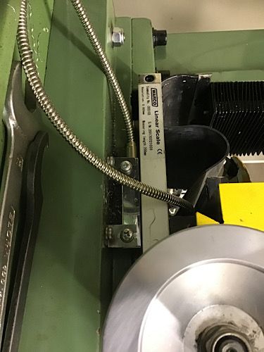

                    I have just taken delivery of a new WM16B and wish to fit a DRO. However, the base is a square shape rather than the tapered shape of Warco's other similar machines. Although Warco's website offers the WM16B with a DRO, their guide to fitting a DRO only shows the Y axis encoder on a tapered base. I'm waiting a reply from Warco about the Y axis DRO on a WM16B.
                    Hope this makes sense.

                      Photo of dro on y axis on y WM16B fitted by Warco. Hope it helps.ea54d793-1d09-4860-b98f-a33fb2723eca.jpeg

                        Thank you JD2.

                          I have a Warco-fitted DRO too. They use their branded scales which are small and fit in very well. Warco don't fit them with the protective cover as the seals face down, and the Y scale hits the wall behind the machine as fitted, so I hope to make some small improvements just because I can. I bullied Warco into sending me the covers as shown in the webpage.
