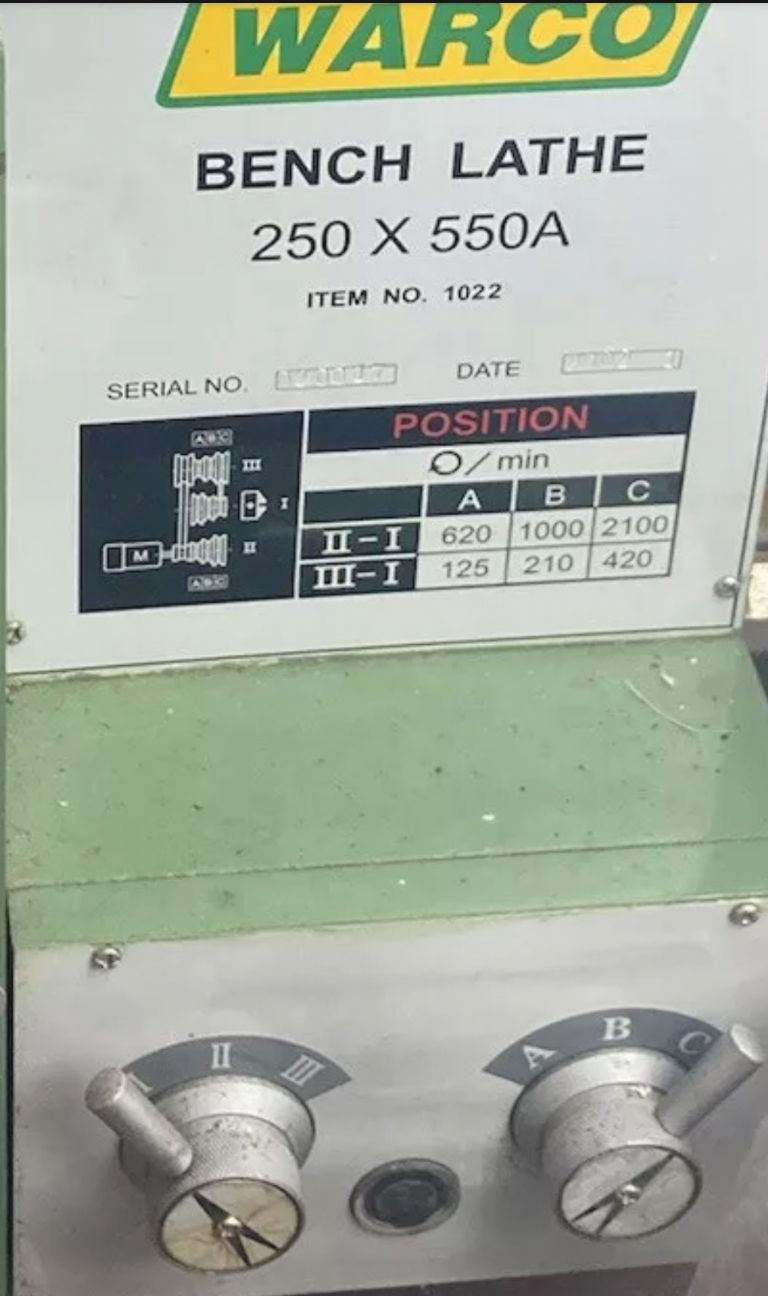

                Thanks for the replies, The lathe has never been used and the belts lost by the previous owner. Its v belt and toothed belt drive, not variable inverter controlled.
                I have added an image of what its says on the headstock, Warco 250 x 550A item 1022, maybe this can give the correct identification for procurement of new drive belts.

                    Thanks for the catalogue page, that definitely confirms its a Warco 1022 for the early 2000's, hopefully with that information Warco can still supply belts.
