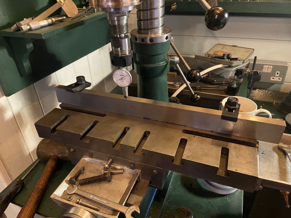

        Hi
        Now trying to learn to set up my Dore Westbury mill (got from eBay and refurbed)
        I trammed the head yesterday and got it to .001 – happy with that.
        I need to make some jaws for the vise, and I have some gauge plate for that. Before I cut the gauge plate I thought I’d indicate in the vise so I can mill the end of the gauge plate square. But I find that when I put the DTI on the vise and wind the table from left to right, the table wanders by about .005 on each turn of the wheel. I have tightened up the gibs but it seemed to make no difference. I had the table apart, nothing is obviously worn and everything seems in very good condition. I cleaned and oiled it and put it back together.
        it seems to happen more when the table is at either extremity.
        Is there something I don’t know about tightening gibs? When I tighten the gibs on the lathe carriage, I can’t move it. But on the mill, it still runs smoothly. Something doesn’t seem quite right.
        Any ideas?
        Thanks
        Steve

          How do you know that it's the table and not the vice that is off?
          Andrew

              before I took it to bits, I was getting about .010 movement. I could see the corner of the table wandering, also, it corresponded with a stiffness at a particular point when I turned the wheel.
              I also used some gauge plate for the DTI. I wasn’t sure if the “outer jaws” of the vise were flat enough, they have some grinding marks on them,
              So I’m pretty sure it’s the table and something to do with the gibs/feed screw

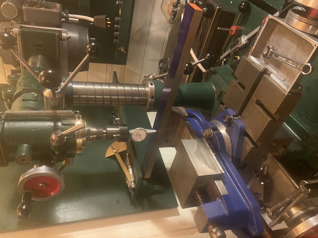

                      What's holding that bit of bar you have the clock running against? looks like it's just stood on top of the fixed jaw.
                      To take out some variables try it with the clock on the edge of the central tee slot.
                      Can you also confirm that when you say 0.005" movement you are talking of wobble or just the steady change in reading from one point to another.
                      I assume you are loosening the locknuts then adjusting teh gib screws before finally locking the nuts again? If they are making no difference then something is wrong as they should lock the table if done up too tight.
                      It's a large vice for that machine, at least consider taking it off the swivel base if for nothing else to regain some Z height.
                        nothing, it was just an experiment to check it wasn’t imperfections in the surface of the cast iron on the vise. Same results.
                        wobble, it is “wobbling around a steady change” if you see what I mean
                        as Michael also suggested I will take the vise off and eliminate that as a variable.

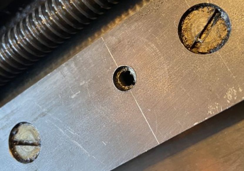

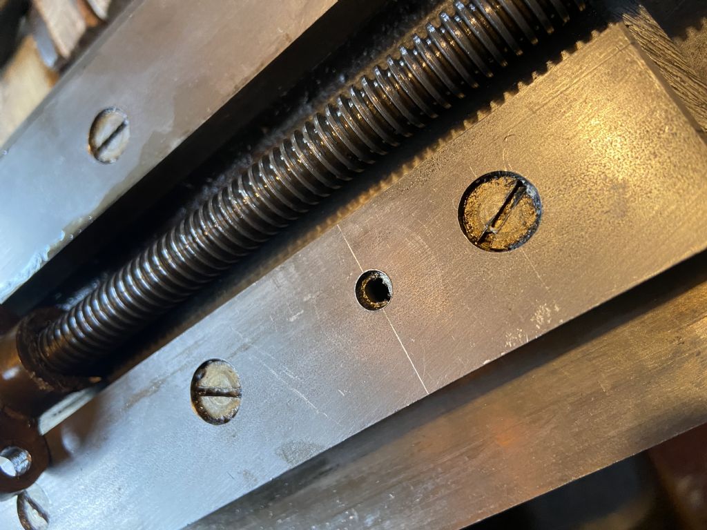

                            I have it apart again, the strips are all tight and seemingly in good nick. I am wondering about those spring dowels. I can’t seem to post pics of the drawings here, but I can’t find anything about them on the drawings except the holes in which they go.
                            see pic below, do you think that looks right? I can’t see the point of those holes myself, so Is something missing perhaps?

                                From your photo it looks like the spring dowel or 'roll-pin' is in place.

                                  Going back to the gibs, does that locking screw (third hole) lock the table?

                                    That looks as if it is ok as noted previously by Journeyman , have you checked also the gib strip adjustment on the Y axis slide way, try the test with the Y axis lock tightened.

                                      No, it doesn’t seem to, and I can get them all as tight as they will reasonably go and the table will still move. Getting stiff, but it moves. I’m thinking perhaps the gibs are installed incorrectly.

                                        Yes, from memory over 40 years ago when I made one. The OP said tightening the gib screws made no difference, they should certainly lock the table if snugged right up. The gib in my Dore Westbury was just a flat strip of metal so hard to make or fit incorrectly but possible?

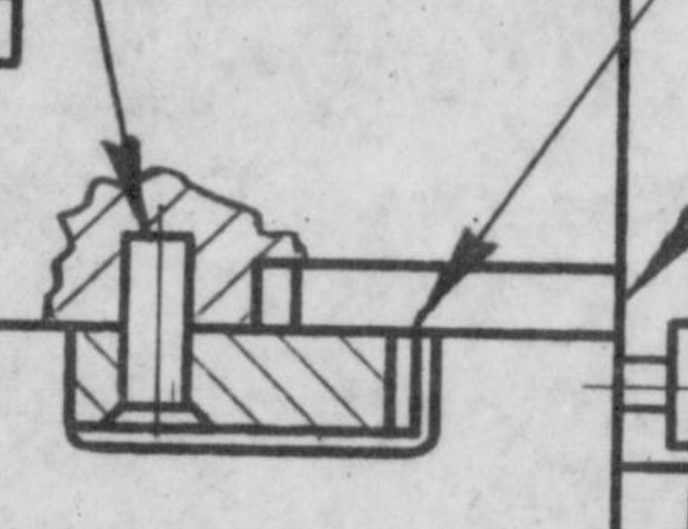

                                          Looking at the drawing, perhaps the gib is supposed to be “raised”, when I’ve installed it it just slots in and settles on the bed. It feels right, but according to the drawing it isn’t. I will have a go at that next.

                                            Steve355, the gib screws & the locking screw should go into dimples in the gib strip.

                                              Yes indeed, but in this case it looks like they can sit in the dimples in two ways.
                                              If the gibs sit on the bed, the gib screws will push the upper side of the dimple, and only the top inner corner of the gib will make contact with the slideway. Looks like that’s why the gibs weren’t locking the table.
                                              if the gibs sit about 1mm above the bed, the screw fully engages in the dimple and the entire gib contacts the slideway, providing a lot more friction. I’ve now got it like this and the gibs can lock the table properly. I can also not move the table at all in the hoizontal plane.
                                              But there is also a vertical component. I think I was turning the handle too roughly, which seems to flex the table – only very slightly, obviously. But it doesn’t take much to create a .002” movement on the DTI. The gauge plate I was using was very slightly off square to the table, so a slight vertical movement moved the DTI needle.
                                              I think I’m getting there.
