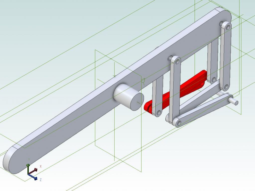

      Recently started a Vulcan beam engine and not having done a beam engine before, but had read a few builds and comments etc.
      Drilling the beam – and the bosses for the pivot points were not all positioned well, similar to other builds. – So If drilled as per dimension for mine, the hole for the parallel motion link would not have been centred in the boss. Drawings indicated 1-7/8 equal spaced between centre pivot and end pivot. Parallel motion links are all 1-7/8 including the 'tie' links to the entablature.
      After the adjustment to centre the pivot in the boss, dimensions are now 1.910 (end closest to end pivot) and 1.840 from that to the centre pivot.
      I assume that lengths of parallel motion links all now need to be the same, at 1.910. I also assume this includes the (tie) links that anchor the parallel motion to the entablature?
      Any guidance on this is appreciated.

          There have been a couple of threads in recent months on parallel motion links on beam engines, going into the geometry at some depth. The Google search halfway down the forum homepage should find them.
          But I believe you are right in thinking the links need to be the same length.
          #637497
            Would be best to draw it out and make sure nothing else is affected but on the face of it all four bridle links need to be the same

                Having the straight line motion attachment at other than half way along the beam will distort the piston rod motion. To correct this, the tie links would have to be not 1.91, and the attachment to the entablature would not be on the piston rod centre. Probably only very small differences, but I'd investigate Martin's suggestion first.

                  Seems also important for the pivot point for the 'tie' link attachment on the entablature to be in line with the piston rod. seems that way provided the bridle links are same length it keeps things in-line.

                    As I said above, if the half way boss isn't actually half way, then the entablature anchor should not be on piston rod centre. Sanderson is a extreme example.

                      I plotted the alterations to beam pivot onto the sketch I did the other week and if all 4 links are extended by the same amount (red)you get about 9 thou more lean of the piston rod from one extreme of it's travel to the other if entablature pivot is not altered

                        How long are the droppers?
                        #637668
                          The drop links on that engine were the same 1.75!" will most likely get a different result with the shorter 1.125" Vulcan ones but shows it will not be the same. Also did not work out where the Vulcan entablature pivots will be as that again will affect geometry. Suggest OP does it in CAD either on the 'puter or Card and Drawing Pin method

                            Using the OP's beam dimensions and 1.125" drop links, I make it that the fixed end of the tie links (where it connects to the entablature) should be 0.135" nearer to and 0.013" above the main beam pivot. The tie bars should then be 1.775" long. This gives the piston rod connection on centre top of stroke, middle and bottom. The drawing is a bit confusing as the drop links equal half the stroke, but if anyone wants a copy as a dwg just let me know.
                            I'd still take up Martin's suggestion.

                              Thanks Jason and Duncan, appreciate the numbers as I don't have CAD. and how accurate can you get with a pin and card?
                              due to the nature of the casting I didn't fancy trying to re-machine the boss so have already drilled.
                              Duncan – don't quite understand re the 0.013 'above the beam pivot' – do you mean the main centre pivot on the beam? otherwise Im not sure what you mean, or how it would be possible to have the entablature pivot above the beam pivot. copy of the drawing may be useful thanks.

                                  Yes, I mean the main beam pivot. In reality I can't see the 0.013 dimension being critical. Send me your email via pm and I'll send you my drawing. Dxf or dwg?
                                  I'd still do Martin's mod, blob some JBWeld around the boss where it will be short and machine using ball nose cutter, or even a round top tool in a boring head
