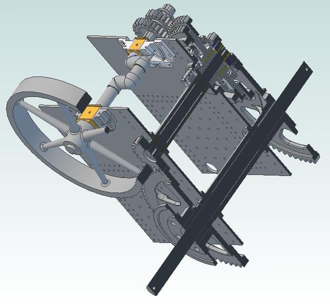

        Seconded! Here's one of my less complicated assemblies:
        Drive Train Assembly
        I've also modelled the valve gear in 3D CAD, and will be using a motion simulator to re-design the valve gear, once I get to grips with what the valve gear actually needs to do.

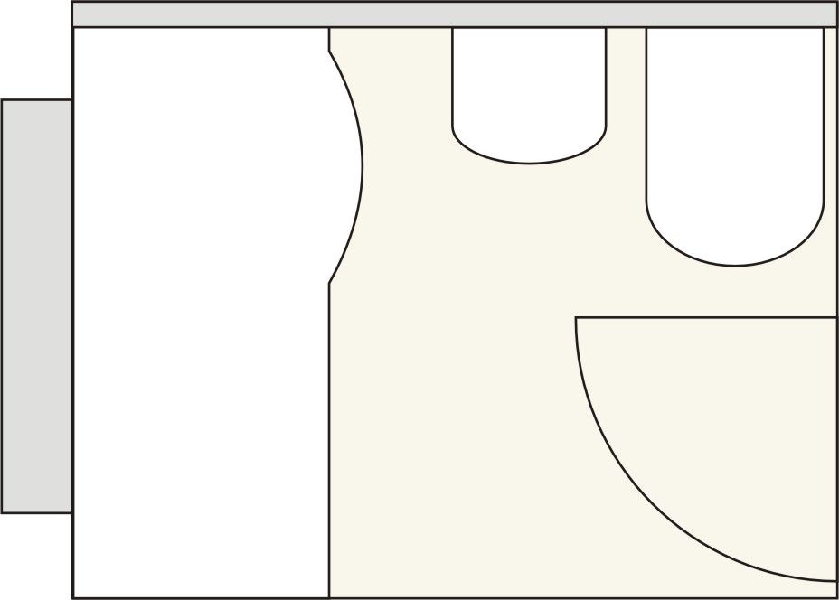

                  Afraid my skills aren't quite up to those of the rest of this community! Still, after discovering the new bath is 6" wider than the old one at the bulge and suffering from a particularly large basin and loo good old Corel Draw gave me the tools to try ten arrangements.
                  One clear winner, but it means a showerproof window blind and a false wall (I have a 4" space in which to fit a 110mm soil pipe… at least i save the extra cost on not buying a new basin!
                  #140593
                    I hope you have got a narrow bum, that pan looks very close to the wall
                    And don't forget that you need to add about another 10mm to the 110mm for any solvent weld fittings and 25mm for pushfit, If you are lucky you should be able to hack off teh existing plaster behind the soil pipe to gain a bit more. At least it will make it easy to fit teh shower valve. Also worth having a cupboard set flush into the false wall above the basin with mirrored door.

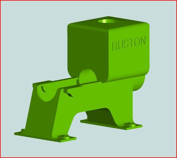

                    I started to sketch this out last night, 1/3rd scale Ruston Hornsby BPR

                      That's the width of the cistern, the (bog standard ho! ho!) pan is a fair bit narrower.
                      Because Pipe has to fit between bath and wall I have almost exactly 100mm less thickness of tiles.
                      so
                      > 25mm for pushfit,
                      got me worried!
                      Fortunately any joints will be hidden behind the loo or under the bath, except a strap on joint for a basin waste which will add hardly anything.
                      I rcekon I can get an extra inch by hacking away at the lathe and plaster though.
                      neat idea, although it will be quite shallow.

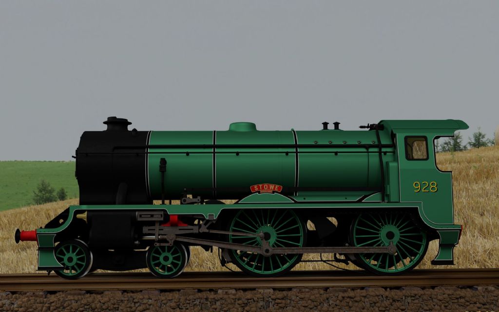

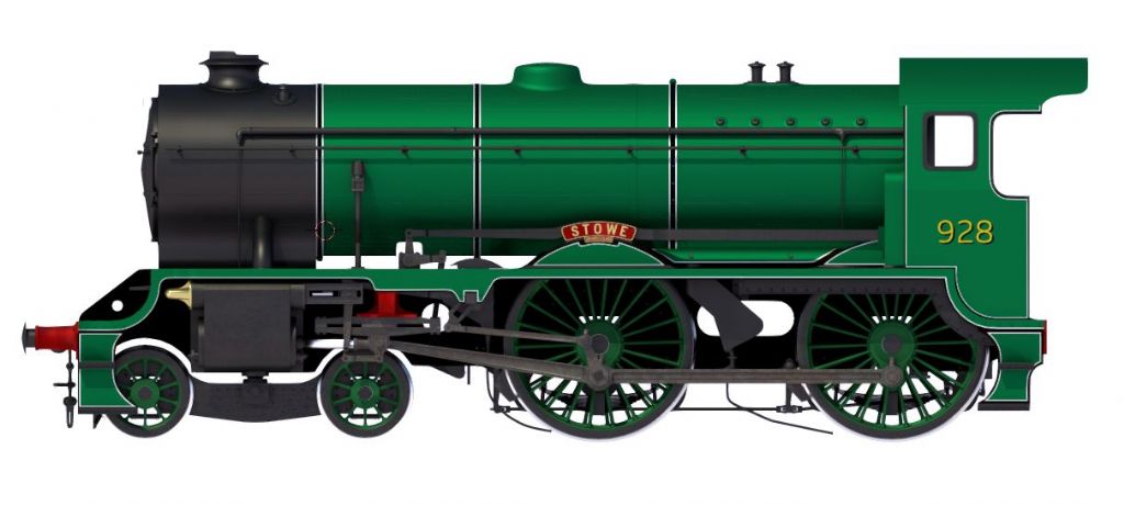

                                  and first probe to put in real enviroment
                                  now I do tender but still nothing to show here
