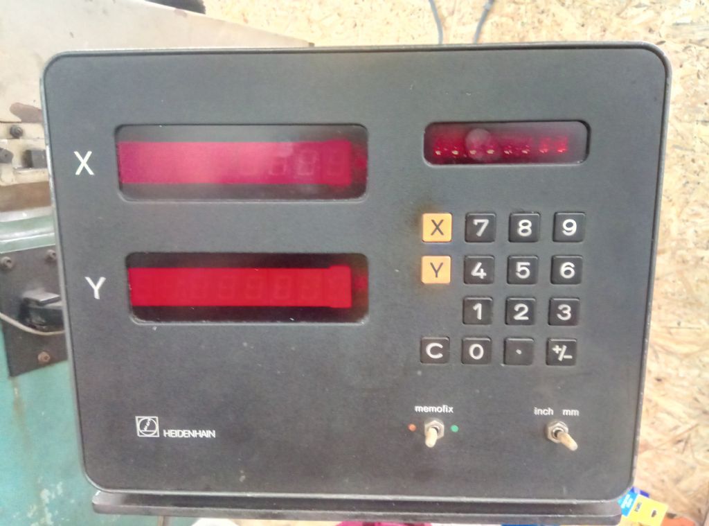

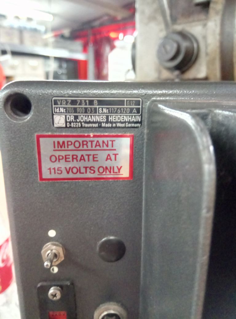

      Has anyone come across or used one of these before.
      I am struggling a bit with working out the functionality beyond the basic readout function (which itself has some foibles, like not being able to change the value of the existing position information when you switch between inch and mm), and preset system.
      To their credit Heidenhain does have the manual for this 33+ year old DRO on their website, but the description of how to use the memofix system is pretty obtuse to say the least.
      Given that it's a product of West Germany it is throughly before my time, but it occurs to me that quite a few forumites may well have experience from using these dating back to when they were still state of the art.
      There's a distinct temptation to just swap it for a modern DRO, but it seems a shame whilst it still works.
      With it being Heidenhain (and old) it uses sine-wave scales, it would mean new low-profile scales or sine-wave to TTL conversion boxes, neither of which would be be cheap (or buying a compatible counter unit from Newall, Mititoyo or Heidenhain for more than I paid for the mill itself!).
      If I find it workable I will most likely just get a cheap single axis Sino DRO to add z-axis, (possibly using a summing interface and scales on both knee and quill).

          Realistically its just a pretty set of LED numbers to be used in place of the dials.
          Important to remember that these things are not a DRO in the modern sense. They are basically just position measuring devices using optical scales and pulse counters rather than lines on dials or rulers. I've used the single axis versions in scientific and engineering devices. Marginally simpler but still a right headache.
          For all practical purposes you drive the machine in the same way as you do with dials making notes of the readings where appropriate. About the only gain is that you don't have to count turns as the readout counter scale is continuous.
          Preset and memofix functions are basically designed to cause your brains to leak out of your ears! Setting things up to get the results you want takes major league concentration and keeping track of what you have set is even harder.
          The issue is that for all practical purposes the display and its driver is completely separate to the counter gubbins which in turn is completely separate to the actual scale drive and sine wave to square conversion circuitry. The counter just increments up or down from wherever it is depending on direction.
          The display driver just holds the last value. Inch or mm output conversion is done on the fly by selecting a suitable divider chain in the counter side of things. Which is why it can't convert a position. The display only knows the number.
          Preset simply allows you to force number into the display driver which subsequently goes up and down following what the counter does.
          Memofix lets you define the counter starting point from a fixed, reference, position on the scale. You can put your own values in to offset it as need be. The red light in memofix mode essentially means that the counter doesn't pass any values to the display once it has passed over the reference mark on the scale. So you can preset anything you like and the number won't change however much you move the scale. Green light means the scale output is being counted but it doesn't increment the display until you go over the reference mark again.

                It's a fairly basic DRO. Used one 15-23 years ago on a Bridgeport. It is OK when you get used to it. Basically you can just add or subtract enetered values from the current reading.
                Memofix uses a electrically signalled reference position, typically center of travel. Passing this can stop or start the counter. It can be used offset a zero datum. Basically you zero at the reference, touch of you datum and then subtract the difference from the reading. I never found it usefull.

                  As Robert says using preset /memo-fix is essentially no different to setting adjustable dials so you have a convenient number to finish or start a cut from. Such as my common practice of setting dials on the lathe to "finish on zero".
                  Memofix is machine referenced whilst preset is work referenced.
                  If dials is all you have or have used it is step up., But a small one. Like the cheap capacitive scales based on digital caliber technology.
                  Risky to keep the scales as you don't know how much life the illuminator has left. Underun bulb as standard in the old ones so they last a long time but changing is tricky and, as I understand it, the proper bulb is expensive. Folk talk about LED conversions but how good / easy that is I know not. The scale needs a very even illumination to function properly.
                  Agree with Baz that the Heidenhain reputation somewhat exceeds the reality of execution. The scales and probes are excellent but the electronics more than little clunky.

                            I had a Heidenhain DRO even older that yours, mine used a 4040 microprocessor, look to see what yours uses because it might be quite valuable. The 4004 was the very first microprocessor in 1970.

                              I have a 731 without memofix, very basic, had to replace a bulb with an led. it now only works reliably in one direction and loose track on the return.

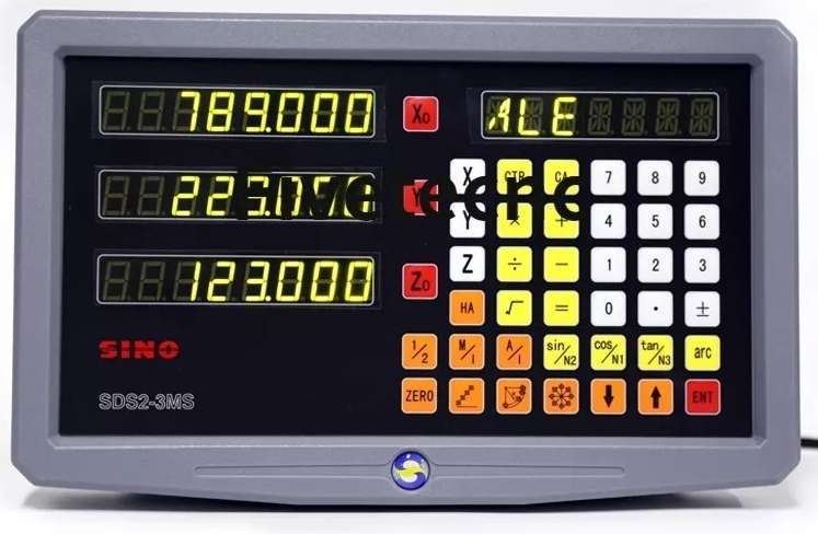

                                  So it’s only been 18 months, and I have finally got round to dealing with this, and bought a new Sino DRO to match the other machines.
                                  1000004733
                                  I put it off as I didn’t want to spend money on new scales, to replace the old Heidenhain Sine-Wave type with modern TTL ones.

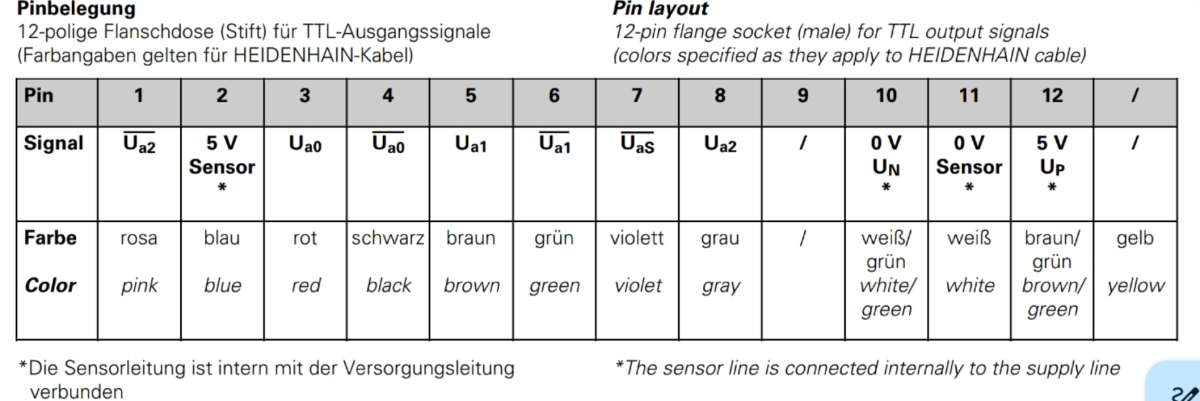

                                  However, I managed to pick up two Heidenhain EXE 610 signal interpolators for a song the other day, which will take the old school 11μAcc sine wave signal, and convert to TTL, which makes things easier.
                                  download
                                  Unfortunately I am struggling to interpret between the differing nomenclature in the German and Chinese documentation.
                                  The EXE 610’s TTL output goes to a GX20-12 pin round connector, according to this Pinout:

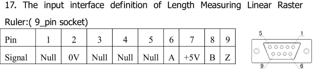

                                  Meanwhile the Sino counter takes its input via a DB9 connector, according to this Pinout:
                                  1000004728
                                  I have both the GX20 and DB9 connectors, and a reel of shielded Cat-6 cable that I can use to make up a connector lead, but can’t work out how to connect them up.
                                  Can anyone advise which pins on the Heideinhain pinout, would correspond to the A, B and Z signals for the counter?

                                    Just figured it out, hopefully this will help someone else in the future.
                                    Of the needed pins for the DB9:
                                    Uₐ₀: absolute reference signal, corresponds to Z on the Sino pinout,
                                    Uₐ₁: Square wave 1 signal, corresponds to A on Sino,
                                    Uₐ₂: Square wave 2 signal, corresponds to B on Sino.
                                    Of the other pins:
                                    U̅ₐ̅₀̅: inverse of Uₐ₀, unused by Sino,
                                    U̅ₐ̅₁̅: inverse of Uₐ₁, unused by Sino,
                                    U̅ₐ̅₂̅: inverse of Uₐ₂, unused by Sino,
                                    U̅ₛ̅: fault detection signal, unused by Sino,
                                    0V Uₙ: duplicate of ground, appears to be unnecessary based on Heidenhain note,
                                    5V Uₚ: duplicate of common, appears to be unnecessary based on Heidenhain note.

                                      Further note for anyone else facing this issue:
                                      It’s not actually GX20 connector, it’s an M23 Sensor Connector, available from CPC Farnell or RS Components quite easily.
