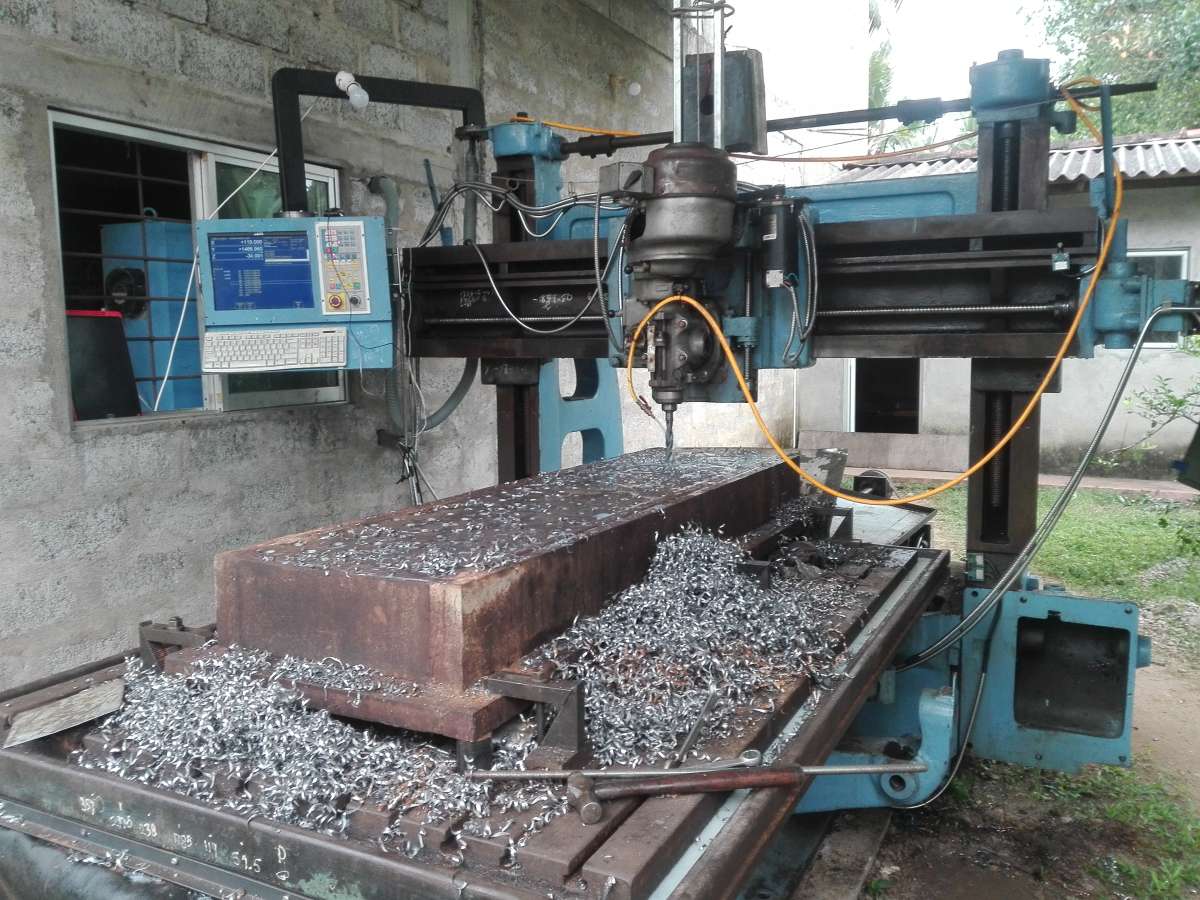

      Hello every one in UK, I am from Sri Lanka. Happened to get hold ofba 7ton vintage(perhaps 1900 or later, Planer Milling Machine made by Smith and Coventry Ltd, Manchester. Removed a ton of line shafts, flat pulleys, heavy gears and fitted ball screws, Servo Motors,  Servo drives and now working o heavy milling. The old head was replaced with a bridgeport mill head. The control used is a US made Centroid CNC with MPU11 + GP104D card. dc Servo drives were AMC 30/8 and AMC100/80.
      Motors we old DC servos Fanuc and centroid.

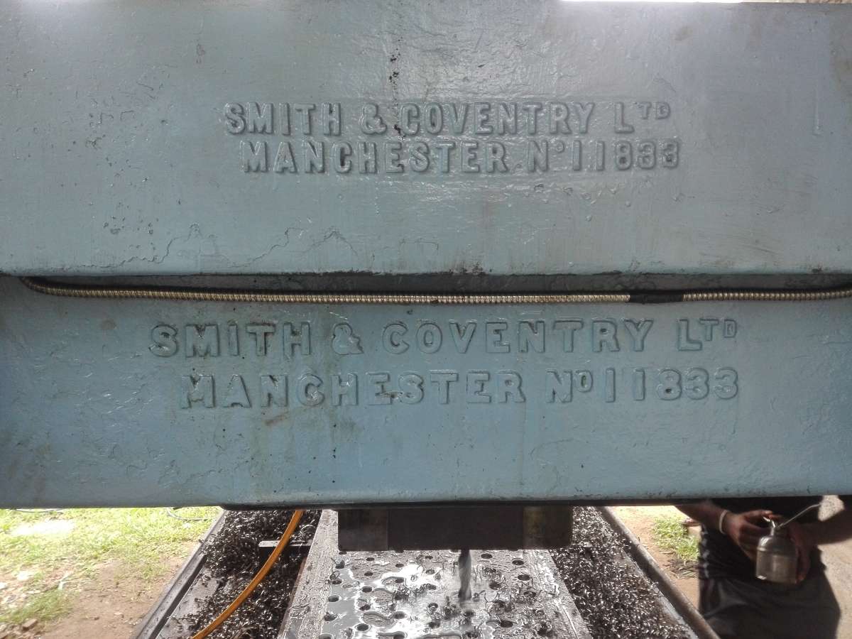

      <p style=”text-align: left;”>I need some help in findig the History of this machine please. Can any one help pls?IMG_20231127_164818IMG_20231127_164835. I am 79.</p>

        Fabulous upgrade … breathes new life into a fine old machine !!
        https://player.bfi.org.uk/free/film/watch-workforce-leaving-smith-coventry-works-ordsall-lane-salford-c1901-1901-online
        There is also [pathetically scant] information about the company on the Science Museum website:
        https://collection.sciencemuseumgroup.org.uk/objects/co8412067/smith-coventry-capstan-lathe-lathe

          All of the old UK kit is a CNC project away from re-use
          The big issue is dealing with the backlash, either through the G-coding process or fitting ballscrews
          an independent measuring input system would be best but I’m unaware of any obvious systems at the moment
