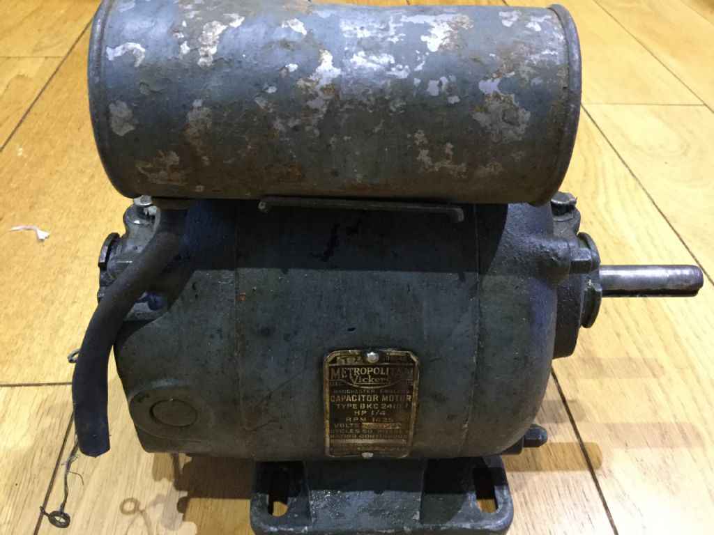

      Dear Friends
      I'm new to this forum. My Father was a very keen enthusiast of Model Engineer, I inherited a large pillar drill from him. I'd love to get it working again.
      He purchased the single phase equipment in the 1950's while we were living opposite the RAE at Farnborough.
      It last worked in the 1970's but has not been connected since. I'm nervous of the capacitor! I suspect that it would be safer to start with a replacement.
      What is it? Is it a just a start capacitor or does it assist with the running? No visible markings on the capacitor. All ideas for a replacement welcome.

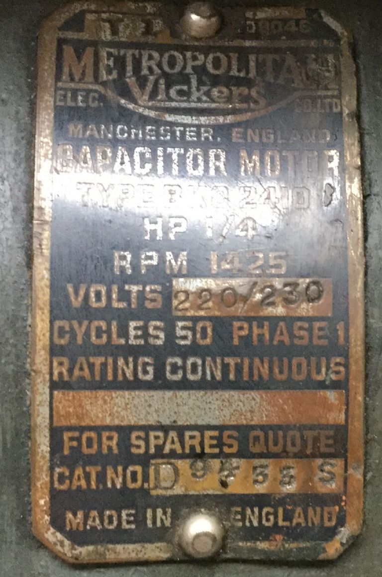

                Try https://www.model-engineer.co.uk/forums/postings.asp?th=103028 to see how to post – a photo of motor plate showing power etc would be a good guide – often the size of a cap is marked on these plates.

                    First , Welcome to the party ! There are several options, 1 just plug it in. If the motor spins up to running speed , your laughing ! 2 it tries to go but rotates slowly, cap is below spec ! 3 It goes bang, cap short circuit or motor fault ! 2 replace cap ! 3 check motor for fault, ie short to ground, or cap replacement. If you want to replace the cap but do not know the value it may be found on the side or base as a uf value or a good multimeter will read the value assuming it has not gone off spec ! As has been said you may find the cap value on the spec plate, not so common ! If the unit has rubber covered wiring I would replace it. Good luck, come back if you have problems. Noel.

                          Thank you for all the helpful thoughts. I shall procced with care and have decided to carefully open the motor to inspect and make an initial clean. I’ll check the bearings wirings and grounding etc. I think it will be difficult to get the end caps off, I’ll have to try but I won’t go too far! I also need to work out the terminal wiring.
                          It is definitely a Start Capacitor, probably about 40 uF. There are some stamped rusted markings but they just seem to relate to a catalogue number or similar (731092-2) and it also says START. Capacitor is in very poor condition with rubber sleaves perished as you would expect.
                          Data Plate below, anyone have Cat No.D 9453 S?
