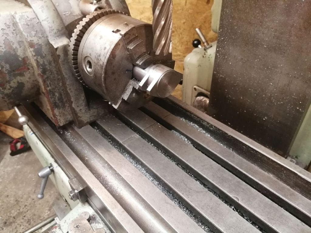

          Hi all, Pete thanks for the pictures and thanks guy's for the ideas on the interrupted threads, will be interesting to have a go at making the Howitzers breech, I've got plenty of time before getting to that, but ideas are flying around in my head, well small bit more done on the cannon last couple of days I have decided to have a go making the spade next, very similar to the one in the first picture ,this digs in on firm ground to help keeping the cannon on target, started of with the wings, to get the small lip around the out side I made some 10mm former plates sandwiched the part in between some heat and a bit of hammering to get the result i wanted couple of pics below.
          Thanks Mal.img_20190909_185155.jpgimg_20190911_191652.jpgimg_20190911_191848.jpgimg_20190911_193957.jpgimg_20190911_195021.jpgimg_20190911_195214.jpg

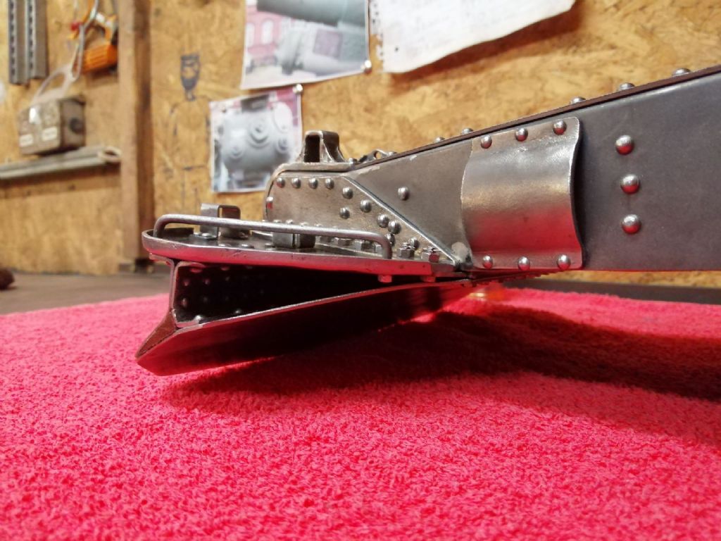

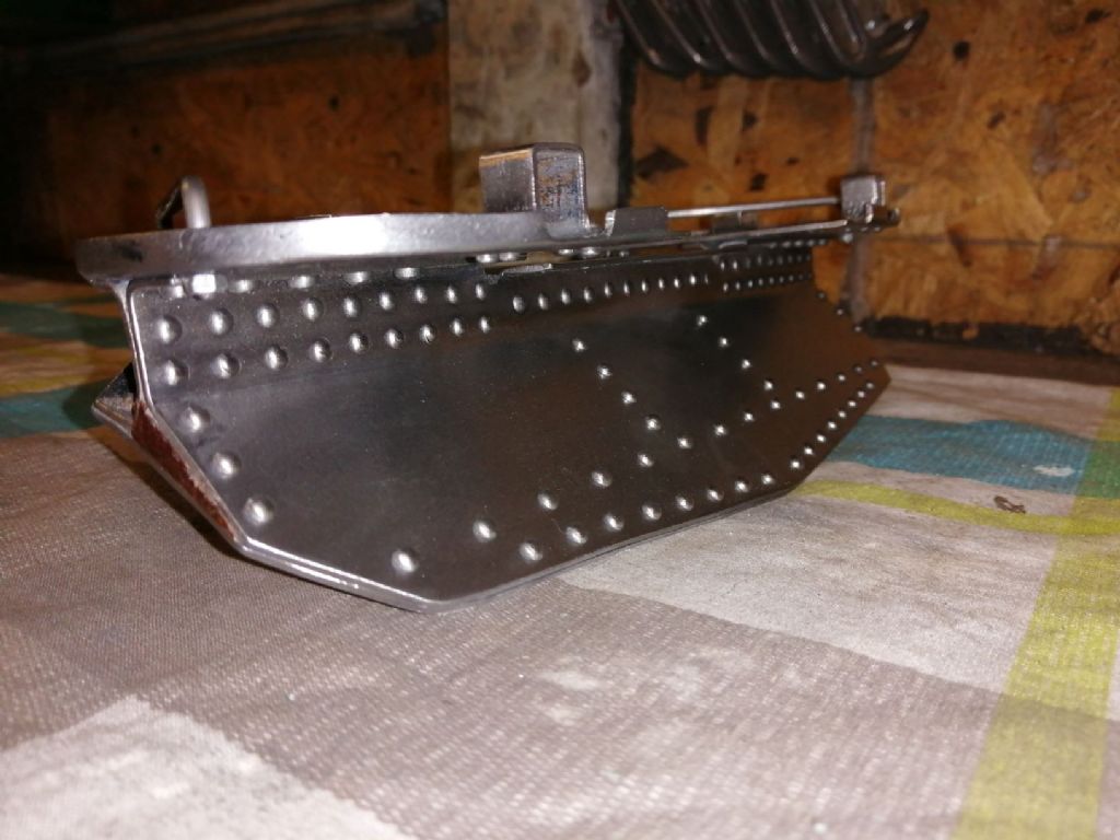

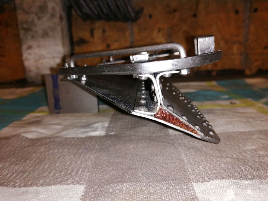

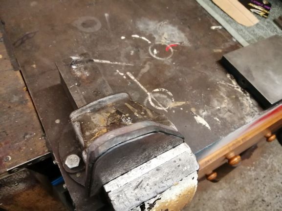

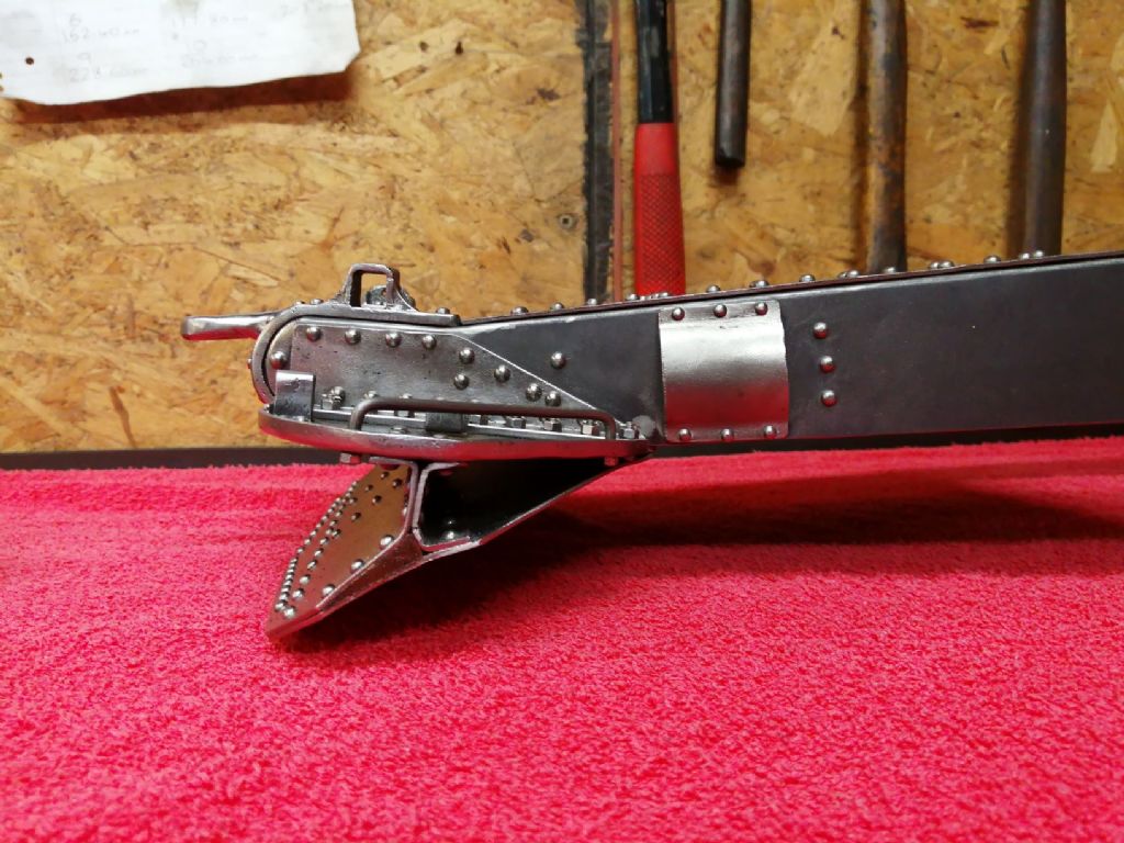

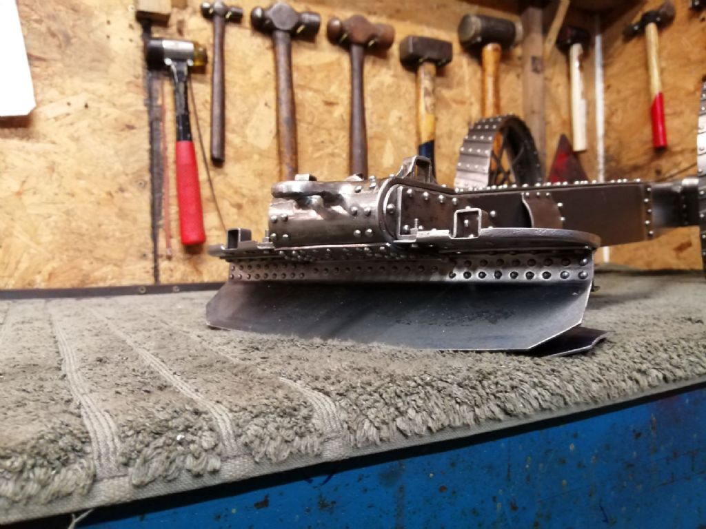

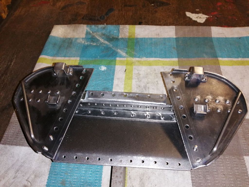

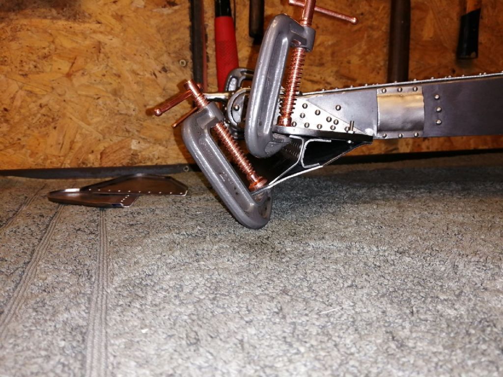

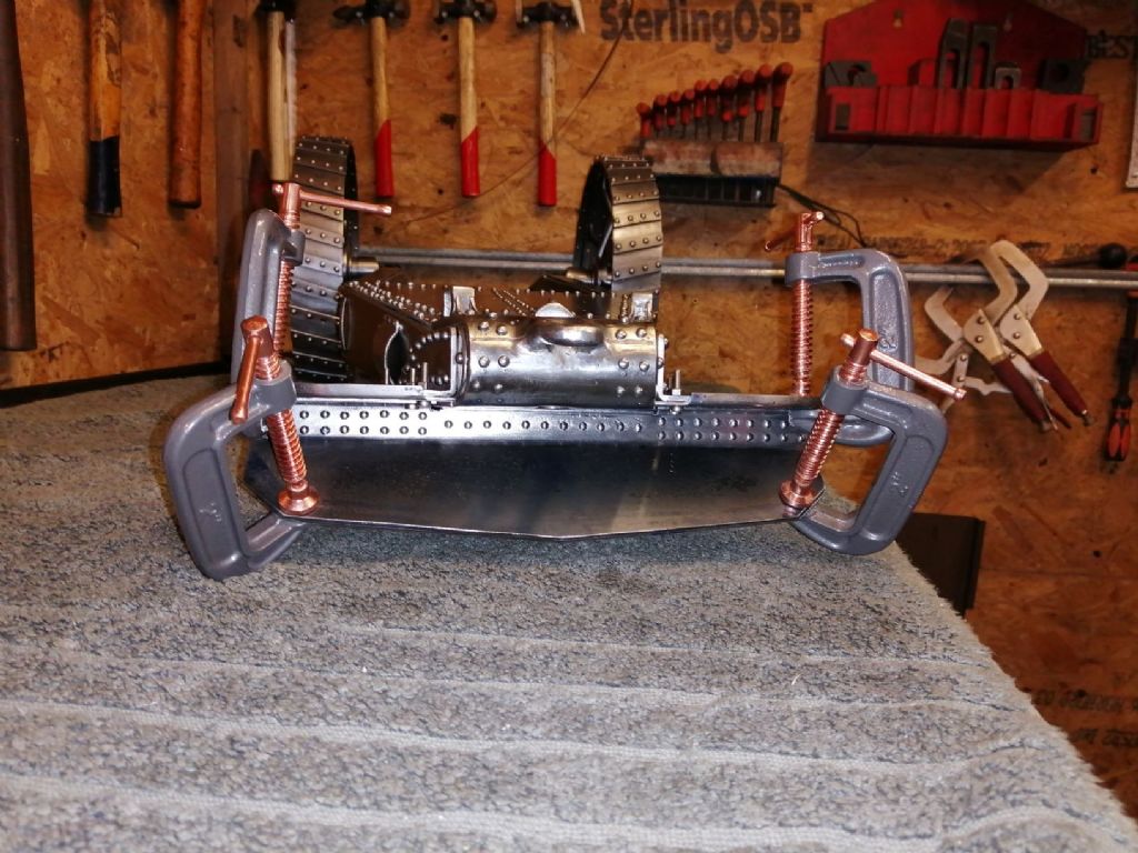

                    Hi all ,little bit more done on the Howitzer well one step backwards I had to remake the sole plate wings as they were to wide and would not let the carriage that carries the air compressor to turn on full lock without hitting them first ,so after getting them wright started on the spade lots of hammering later and came up with what you see in the pictures, some awkward rivets and bolts to get done in the next couple of days, looking forward to having a bash at these interrupted threads but plenty to do first .
                    Thanks Mal.img_20190919_202057.jpgimg_20190921_000903.jpgimg_20190922_154001.jpgimg_20190922_153946.jpg

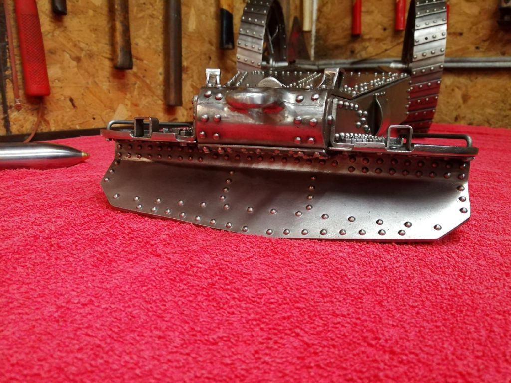

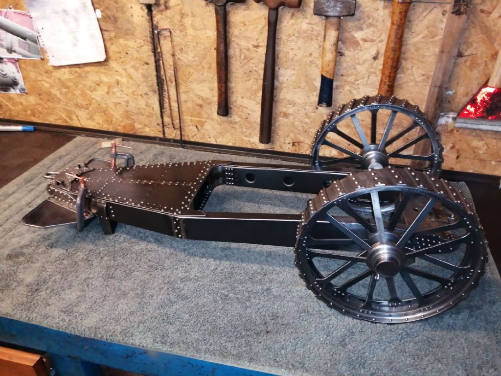

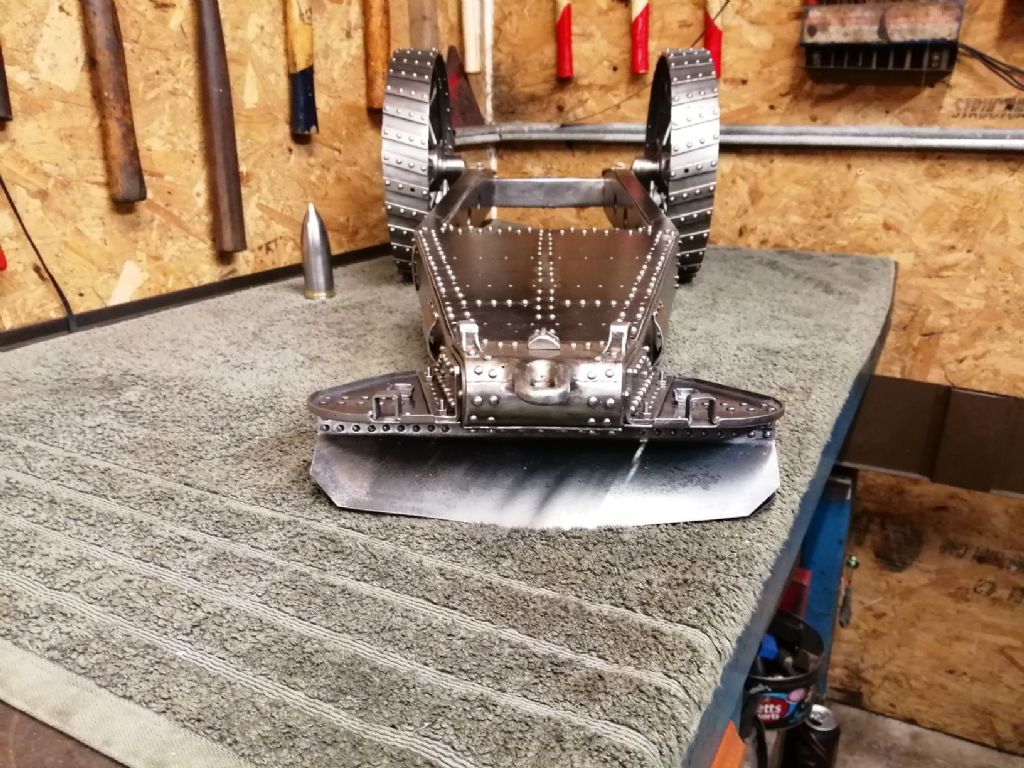

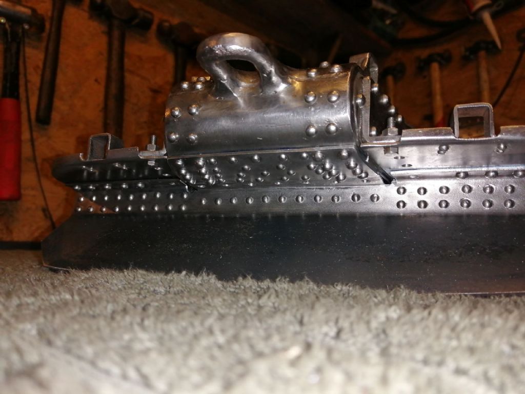

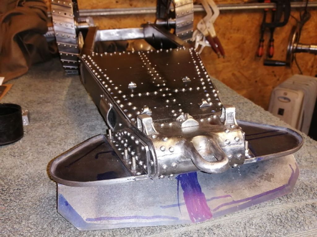

                      Hi all,thought I would rivet on the cover plate that goes over the joint of the trail and the sole plate this is just for underside detail as the model does not really need it, on the float plates [not sole plate wings that I called them] managed to rivet the spade on and some brackets which are there to help movement of the cannon ,still plenty to do on the spade like more rivets and the front part of the spade to be attached ,couple of pics below on how things are looking.
                      Thanks Mal.
                      img_20190926_200714.jpgimg_20191001_212133.jpgimg_20191001_212148.jpgimg_20191001_212109.jpg

                        Absolutely brilliant, not so much a model but more a work of art. I look forward to each installment.

                          Superb piece of model engineering Mal; I would not be ashamed to put it into an exhibition as is under 'work in progress'
                          George.

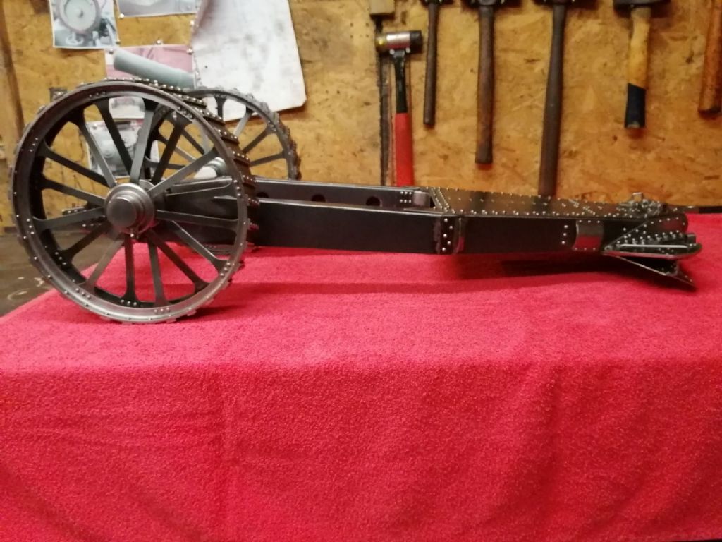

                            Hi all,thanks Martin, George thank you but maybe next year I will see how the Howitzer is looking at that stage, well iv'e been busy in the shed for the last week or so mostly riveting and fabrication with a small bit of woodwork, while waiting for materials to turn up for the spade I decided to add some under side detail to the transom which I think makes the front more interesting, after that when the materials turned up for the spade with some more riveting and some detail work managed to finish that as well and fit it to the trail ,there's quite a few pics to see how things are coming along.
                            Thanks Mal.
                            img_20191013_122507.jpgimg_20191012_195641.jpgimg_20191012_195634.jpgimg_20191012_195652.jpgimg_20191012_195716.jpg

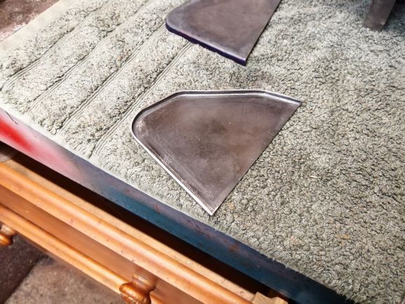

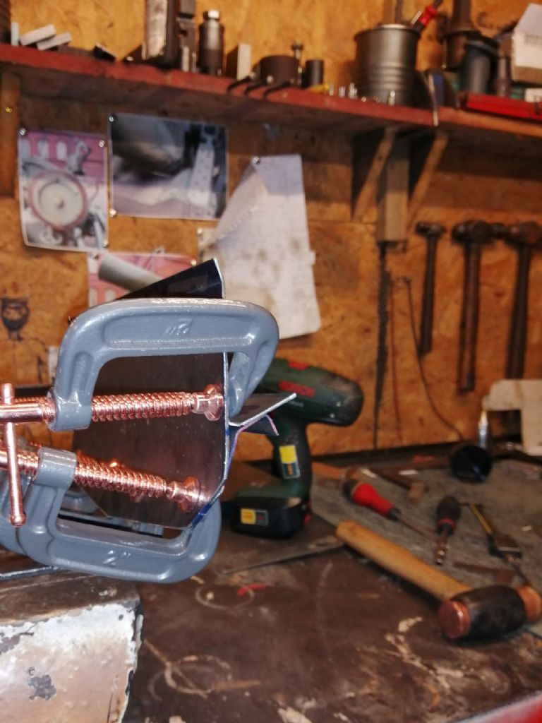

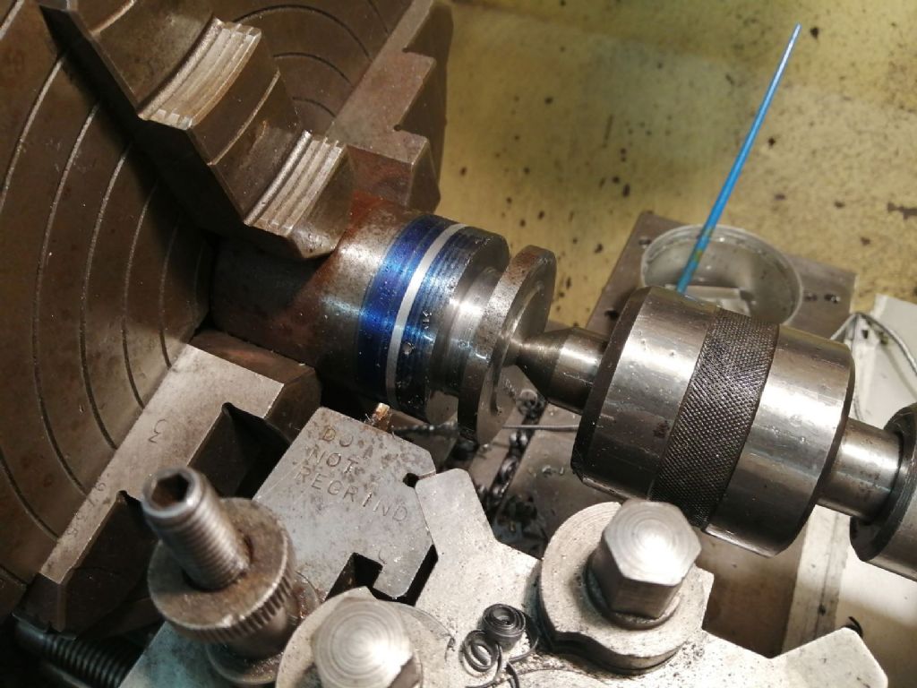

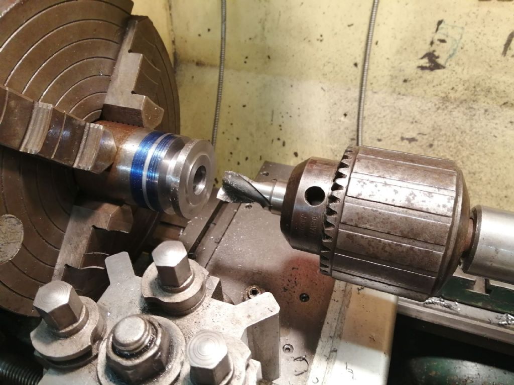

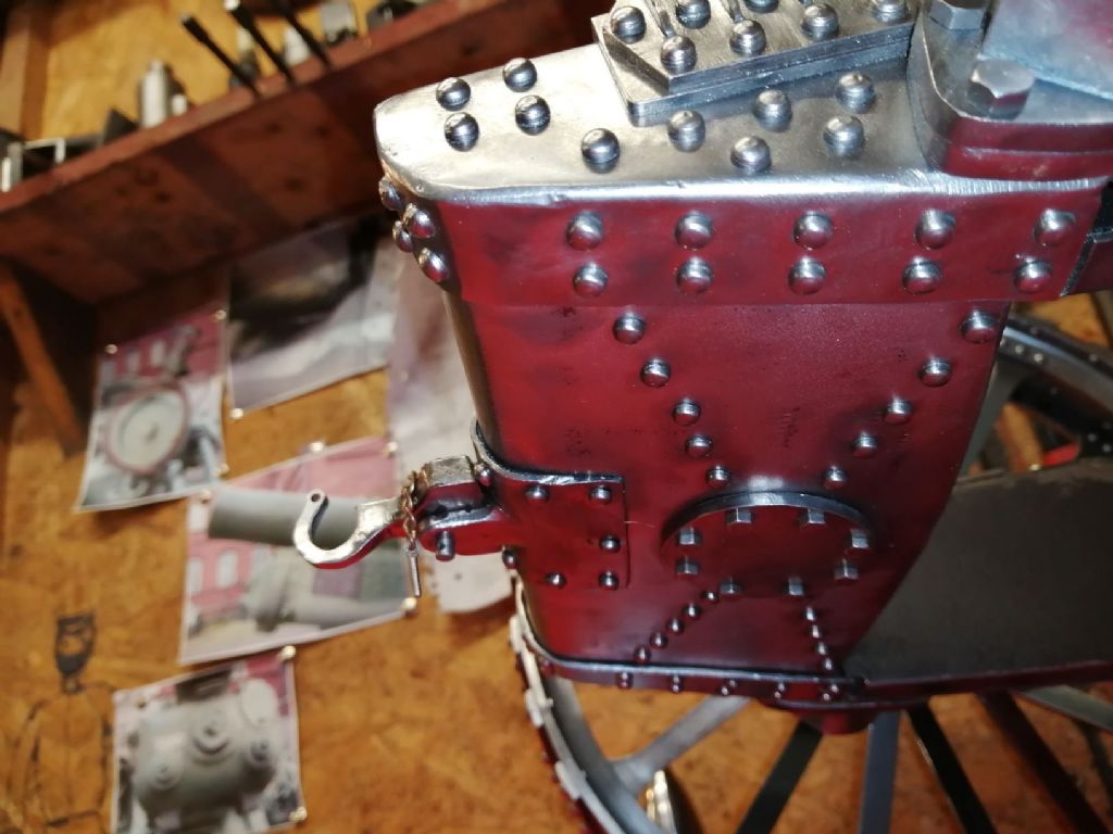

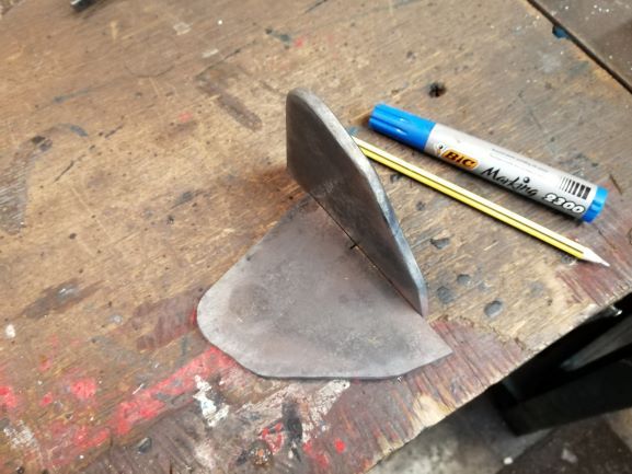

                                Hello all, while waiting on some materials to turn up for the brake bands on the wheels I thought a start on some of the carriage components would be next, decided on having a go at the carriage bearings so dug out some 60mm bar and into the lathe to bore out and get the basic shape after that it was into the dividing head on the mill to finish the bearings shape, roughed the centre up with the dremel to try and make it look a cast piece and more interesting .
                                Thanks Mal.img_20191028_225026.jpgimg_20191027_124645.jpgimg_20191027_131642.jpgimg_20191028_163927.jpgimg_20191028_212810.jpg

                                      Posted by mal webber on 29/10/2019 00:04:26:
                                      …roughed the centre up with the dremel to try and make it look a cast piece and more interesting .
                                      That looks very effective indeed. How did you do it? I can't quite visualise. Hold the Dremel by hand with one of those small pointy grindstones in its chuck?
                                      Edited By Mick B1 on 29/10/2019 08:22:22
                                      #435128
                                      mal webber
                                        @malwebber91786
                                        Thanks guy's Mick the centre was milled out and then I used the dremel with a small grinding stone to rough up the finish. sorry after reading what I had said makes it sound like i removed all the centre with a dremel.
