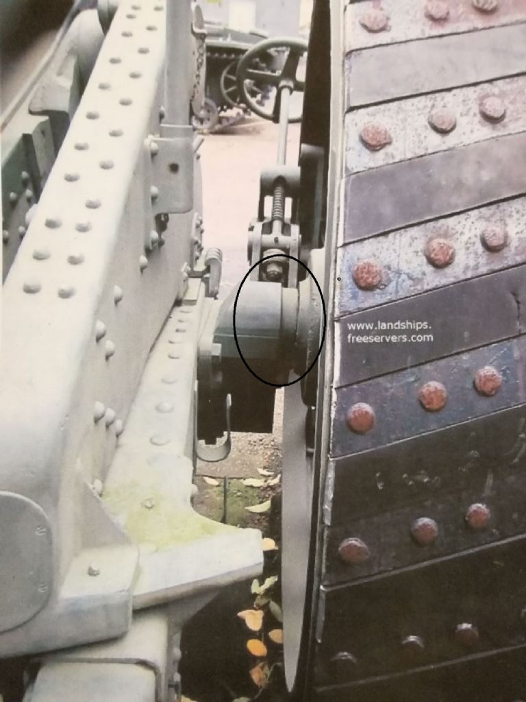

              Posted by SillyOldDuffer on 16/04/2019 13:23:57:
              The gun appears to be emplaced on a slope, and I think the ramps are there to stop it rolling back. Unlike other WW1 artillery, I don't think the 8" howitzer needed ramps to help absorb recoil on the flat. Anyone know?
              This picture is commercial copyright so I won't reproduce it. It shows the gun in a workshop with a smaller ramp at the front as well. I guess it's to stop the gun rolling away if it needed to be fired on a down slope.
              smiley
              The front ramps are to limit forward run when rolling down out of recoil, so might well be used on flat ground too. Might perhaps not be required when firing from a reverse slope, but I'd guess that would only have been done if there was no time to emplace properly. I think the increasing use of motor tractors might have made this happen more often towards the end of the war – I'm thinking of the 'hurrying batteries' mentioned in poetry suggesting that movement was used progressively more than emplacement as a quicker, easier and more certain way to frustrate counterfire

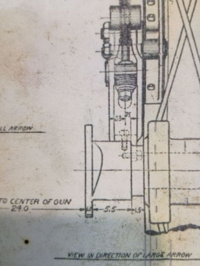

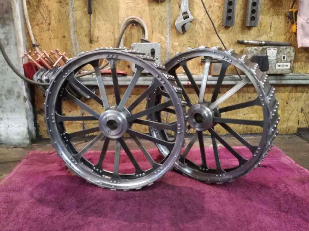

                Hi all thanks for the info and import on the Howitzer cannon, Dave the cannon in the picture is a howitzer mk I to mk V and weighed in at a heavy 13.5 tons [first two pictures below] ,Niloch the howitzer cannons were moved around with tractors with the caterpillar design,traction engines [last picture] horses [the pulling ring on the outer part of the hub was used for] ,I think the soldiers at that time would use any means to their disposal. The Howitzer that i'am trying to build is a mk VI to VII [bottom two pictures] which was a lighter cannon and weighed in at just under 9 tons, first gun rolled of the assembly line 1 march 1916 still moved around by the same means earlier on in WW1 ,when compared to the earlier versions it had a better recoil system but still needed ramps under its wheels to control the rest of its considerable recoil, i'am no expert on these cannons its just what I have read up on them before starting the build so i could be wrong.
                Thanks Mal.

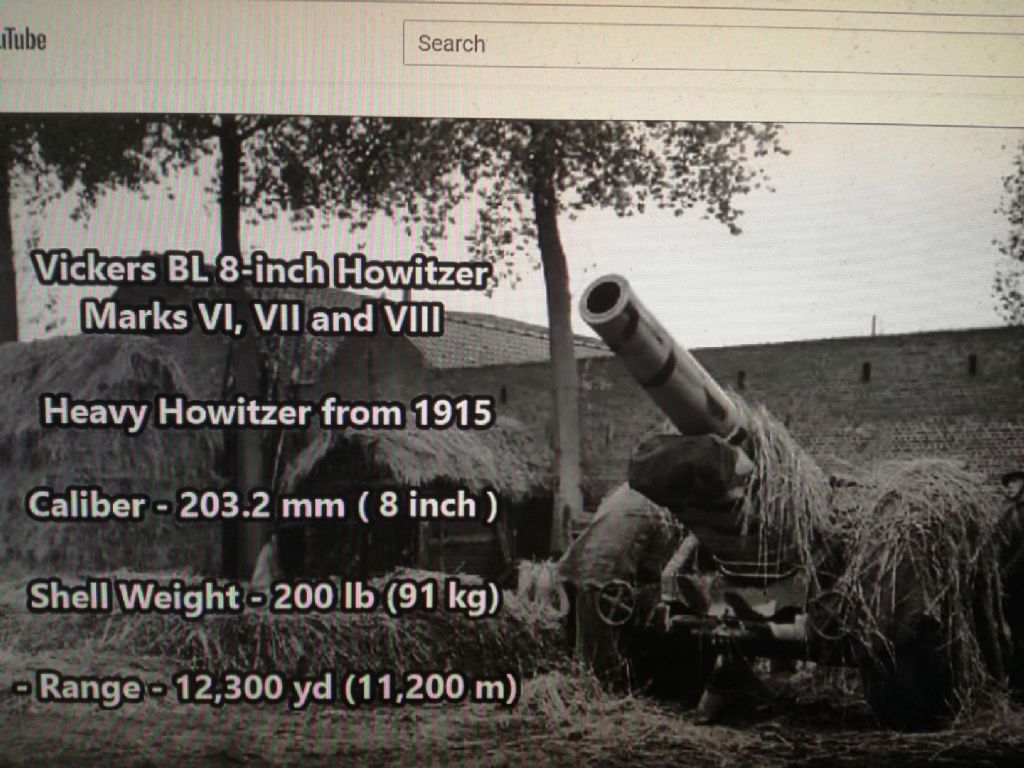

                  Interesting to note from the above that the Mk VI, VII & VIII saw a range improvement of 1,800yds over the Mk I-V using the same calibre and weight of shell. Why might that be, improvements in explosive technology perhaps ?
                    DaveD
                    Another 2 5/8 calibres added to barrel length and 200 fps more muzzle velocity. Don't know, but I'd guess the extra barrel length might've been enough to produce that improvement without changing the propellant charge.

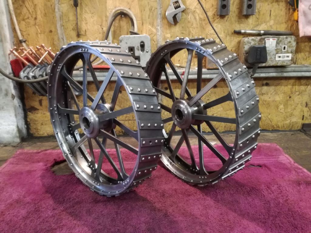

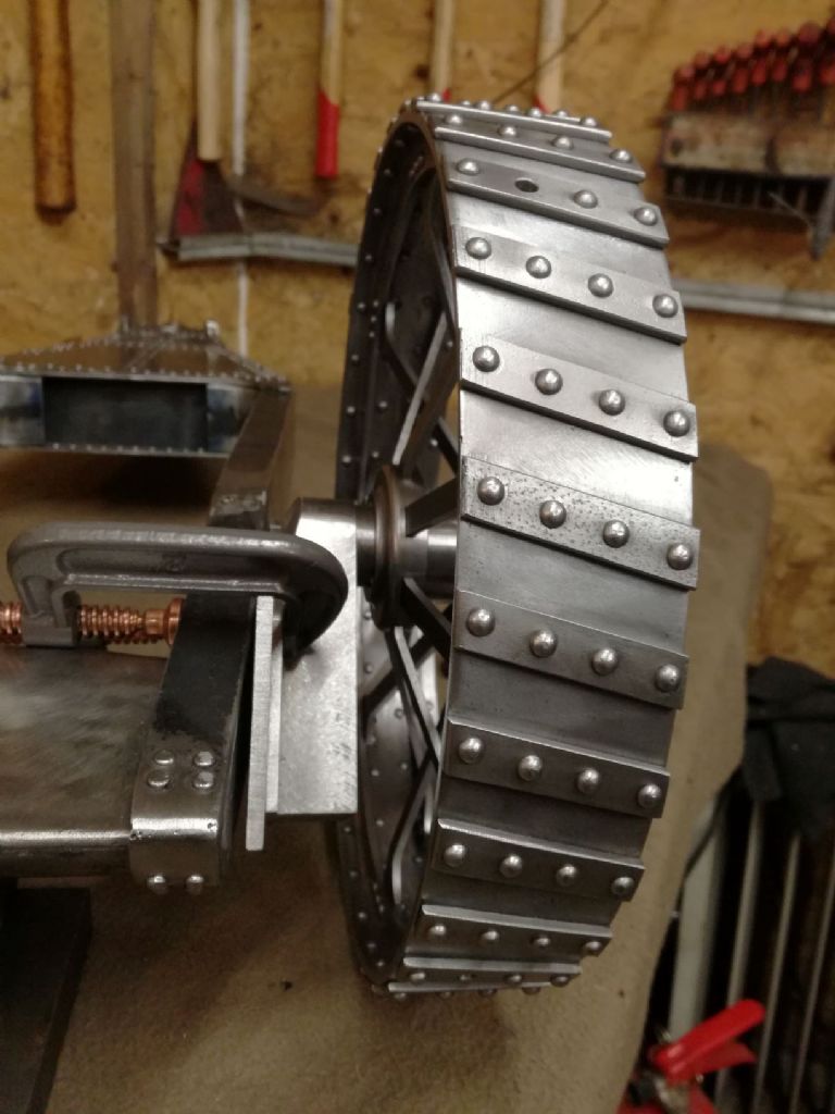

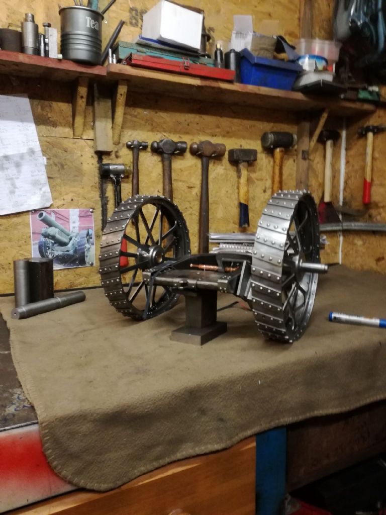

                                  Hi all, interesting reading guy's. DaveD the Howitzer mk VI had a range of 10,745y ,,9,825m and a barrel length of 14.7 calibres 117.7 inches [which is the one i'am trying to build ], now the mk VII and VIII had a range of 12,300y but the barrel length of 17.3 calibres 138.4 inches . I think Mick has this right and its just down to the barrel. Managed to get some more work done on the wheels last couple of days, hubs in place and rivets on the wheels finished next a bronze bearing in the hubs ,couple of picture below to see how things look …..
                                  Thanks Mal.
                                  img_20190422_143035.jpgimg_20190422_143020.jpgimg_20190422_143535.jpgimg_20190422_143546.jpg
                                  #406040
                                  Eric Cox
                                    @ericcox50497
                                    Looking at the spokes being milled took me back to my apprenticeship and milling steel samples ready for tensile testing. It was the dread of every apprentice.
                                    #406047

                                      Looking better every day, super work Mal.

                                        Thanks MickB1 and Mal for the explanation. Great work Mal.

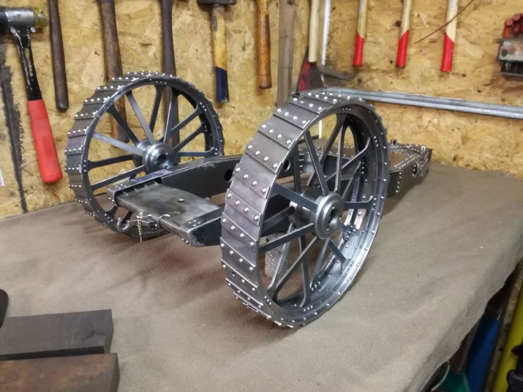

                                              #407549

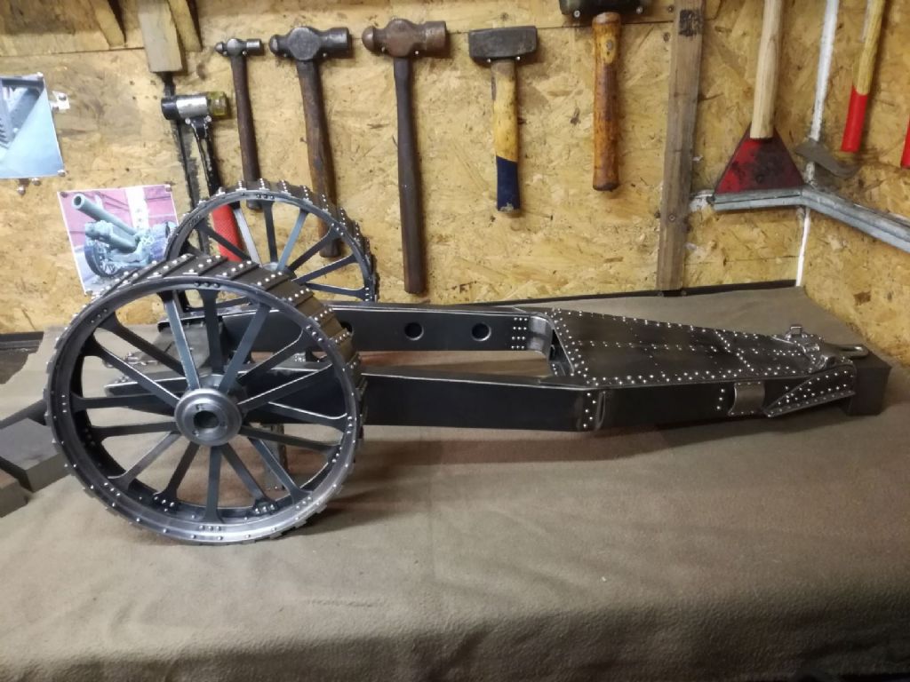

                                              mal webber
                                                @malwebber91786

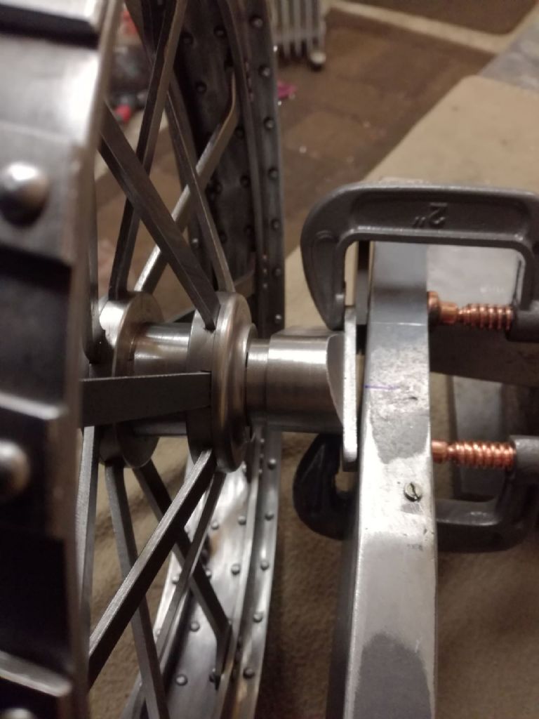

                                                Hello all ,next part on the Howitzer build are the stub axles ,now started on the first one going on the drawings in picture 2 and all was looking good to me, until I looked at a couple of pictures where I noticed the hubs look a different size, maybe it's because the one in the picture is a later model made in the U.S and the one in the drawing is an early model made in the U.K ,what do you think go with the one i've made or back to the drawing board and have another go with different sizes to match the stub axle in the picture.
                                                Thanks Mal. img_20190502_152941.jpgimg_20190502_155519.jpgimg_20190502_194948.jpgimg_20190502_195006.jpgimg_20190502_195936_5.jpg
                                                #407556
                                                Simon Collier
                                                  @simoncollier74340
                                                  Wonderful project Mal. I hope to see it on the cover of Model Engineer when it is finished.
