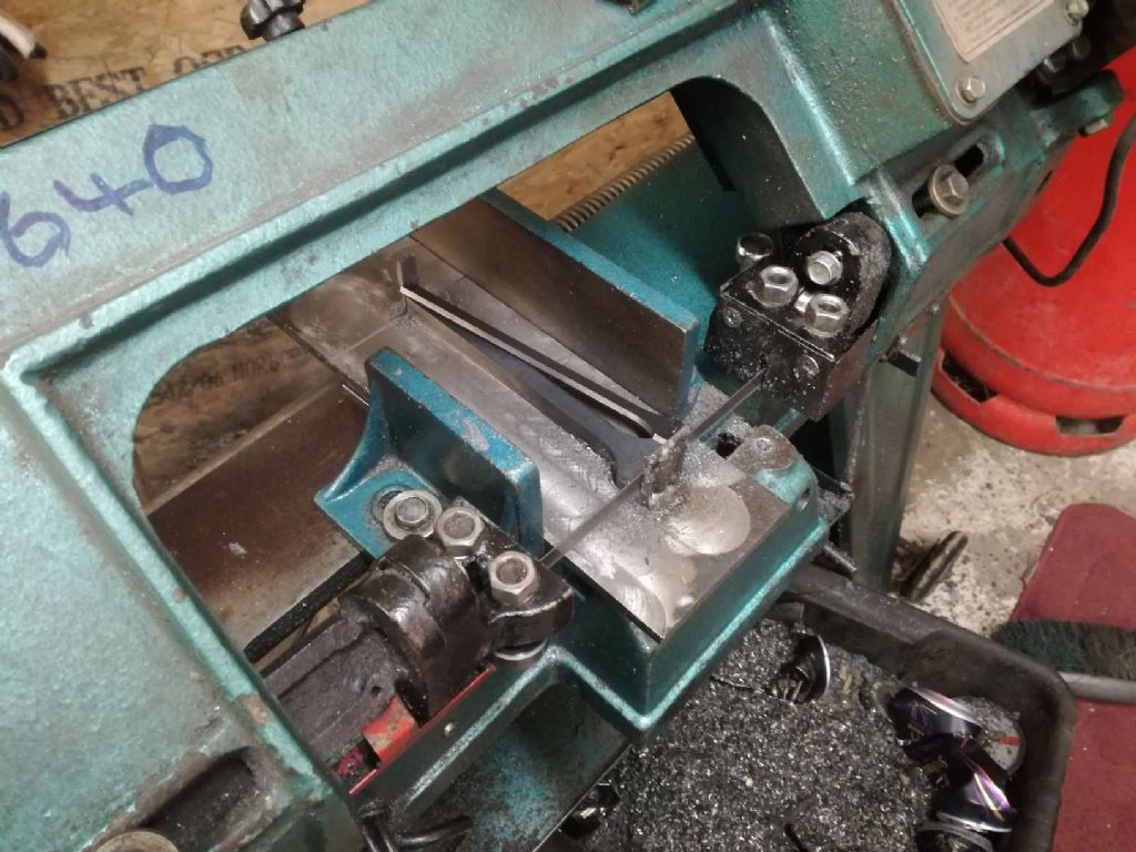

                                Hi all ,still on the wheels been busy milling the spokes for the last few days did think about getting these laser cut but where is the fun in that ,so all 32 spokes done and milled the slots in the hubs, now to put all parts together and make a wheel, couple pics below on how i got along .
                                Thanks Mal.
                                img_20190410_141008.jpgimg_20190410_112638.jpgimg_20190411_190622.jpgimg_20190410_135659.jpgimg_20190412_171542.jpgimg_20190412_173502.jpg
