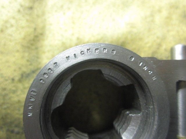

      Breech Block for 20mm chamber

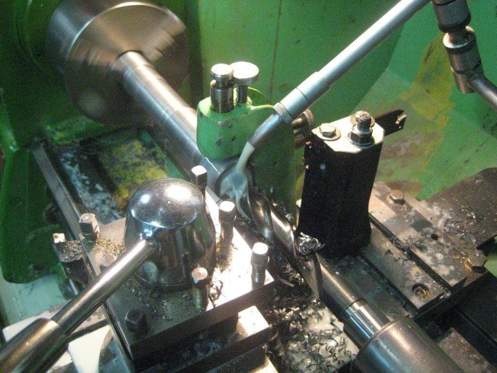

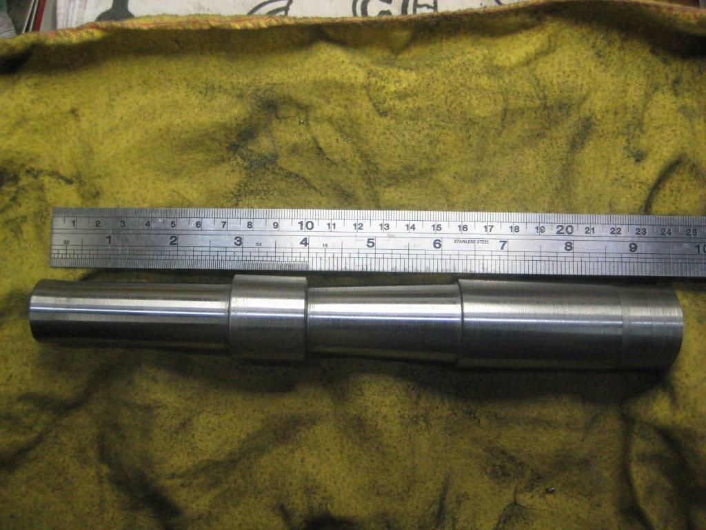

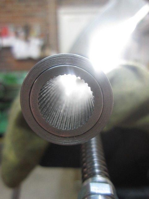

          @bobgould42821

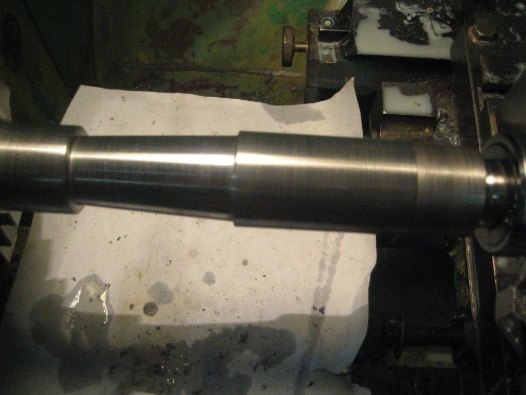

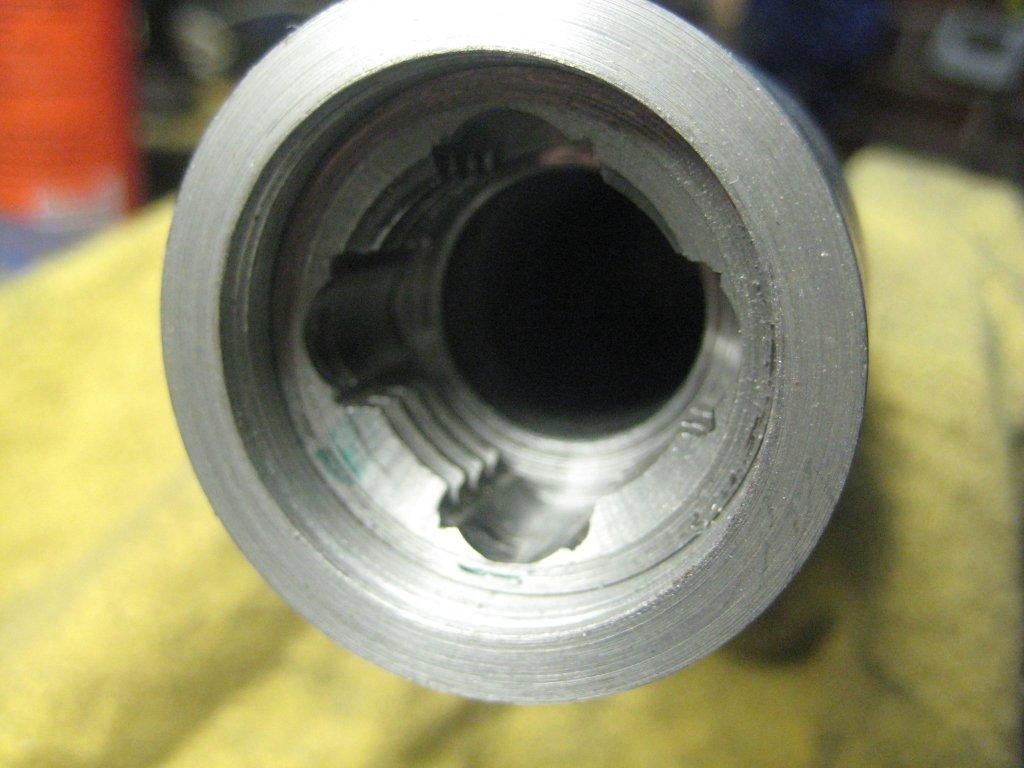

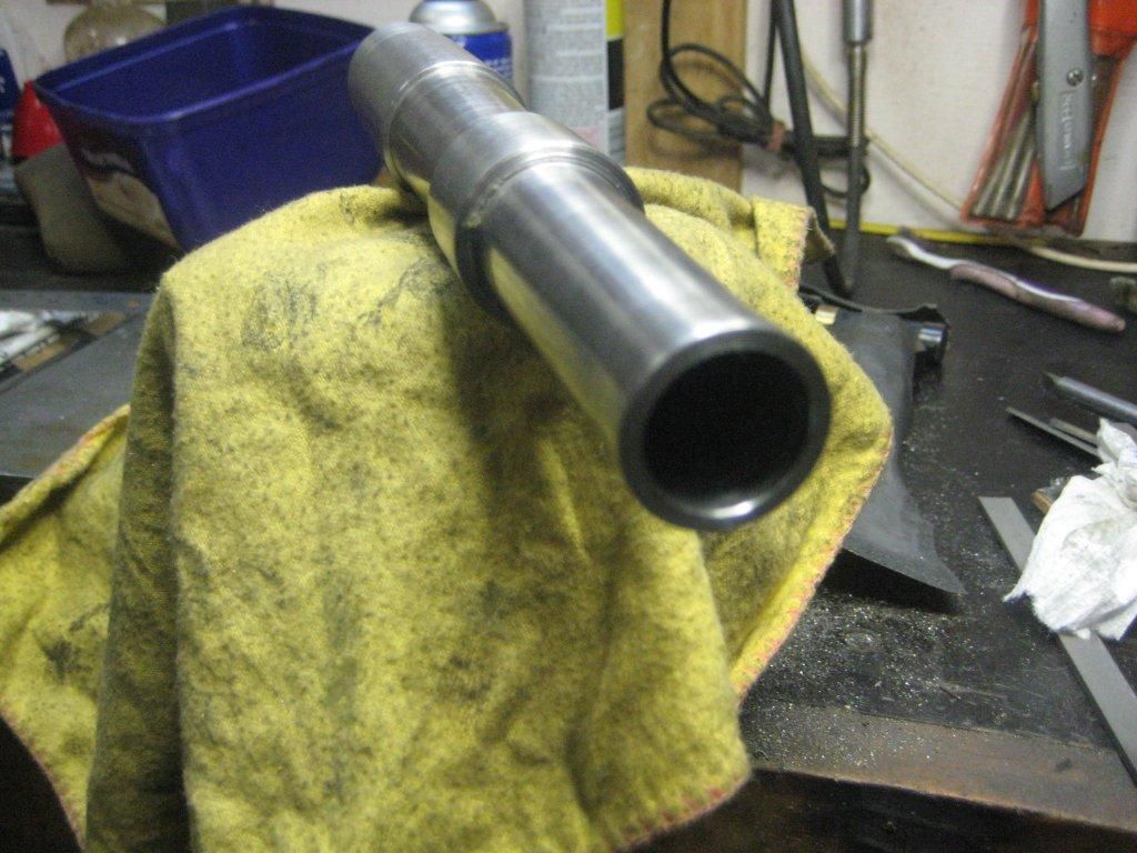

          Barrel boring. There will be a rifled insert as the real thing.
          Edited By bob gould on 20/04/2013 22:35:29
          #117444
          bob gould
            @bobgould42821

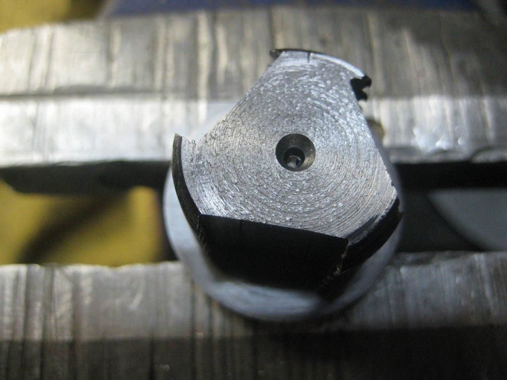

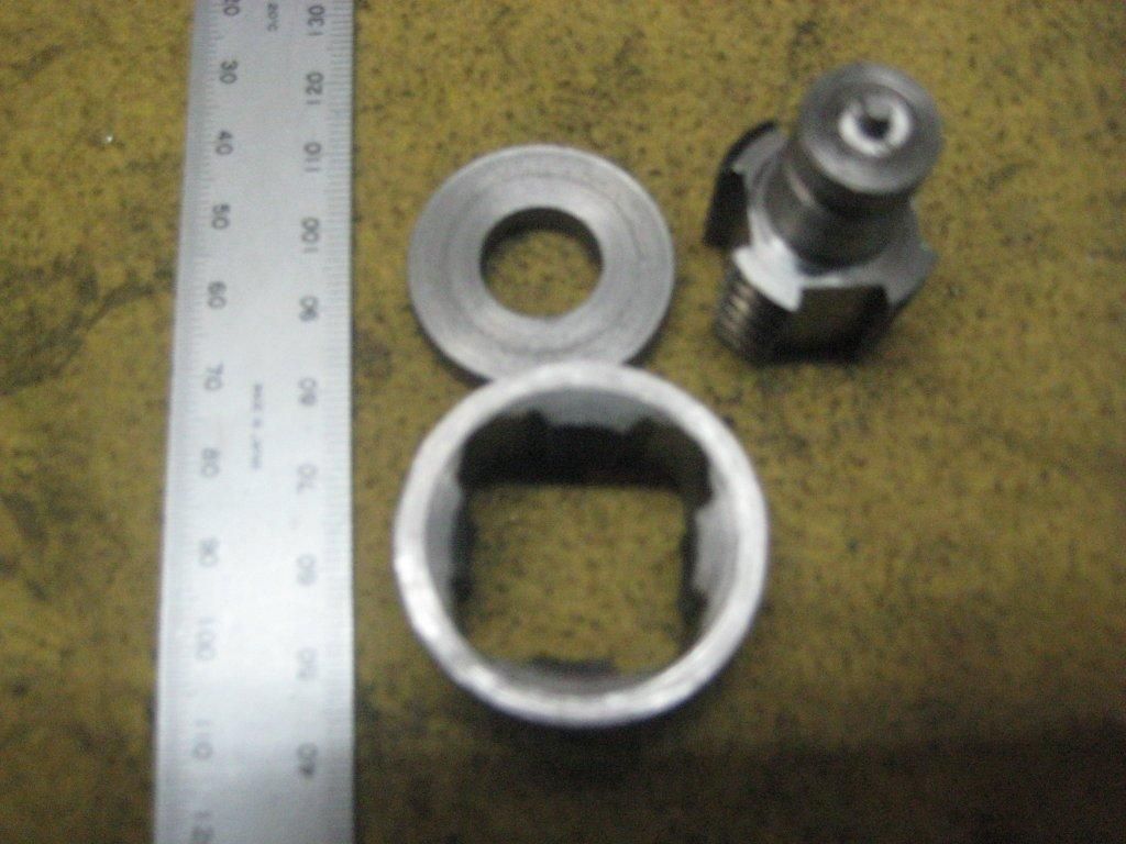

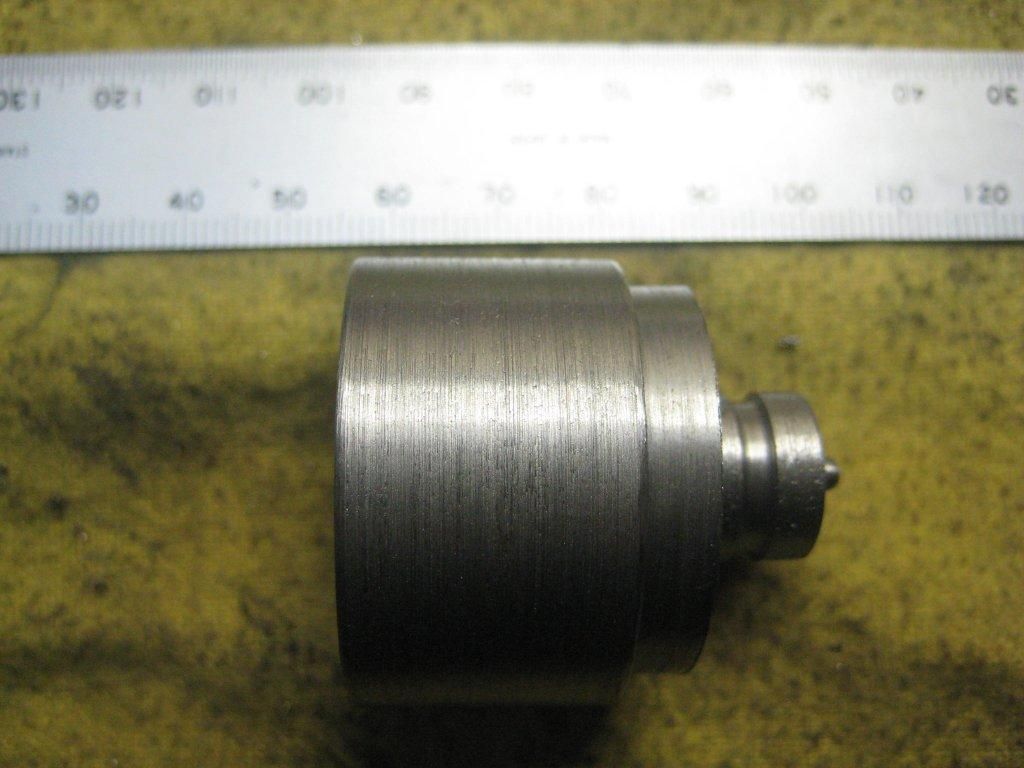

                The breech operating shaft and cam requires a 45 deg turn but the first breech was a 3 segment which uses 60 deg turn to unlock. New breech block is 8 segment so it will only require a 45 deg turn.
                1. assembly
                2. parts

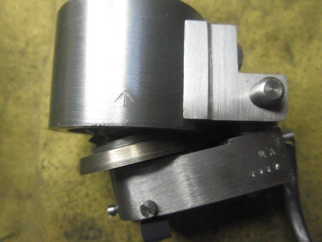

                #117609
                bob gould
                  @bobgould42821

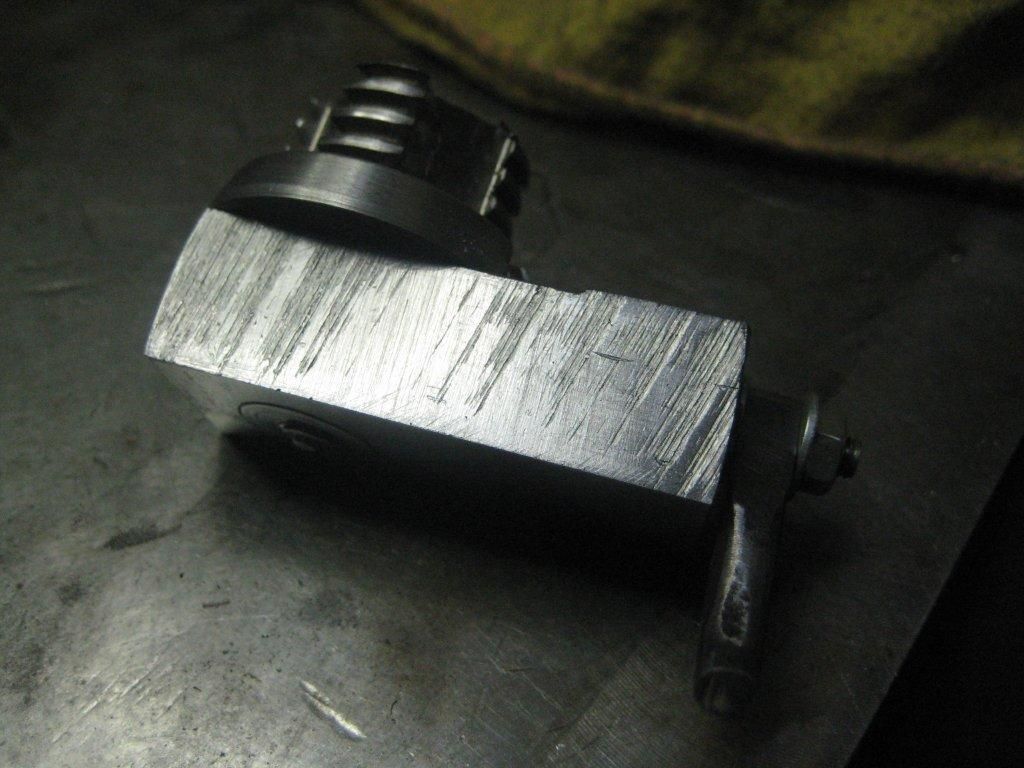

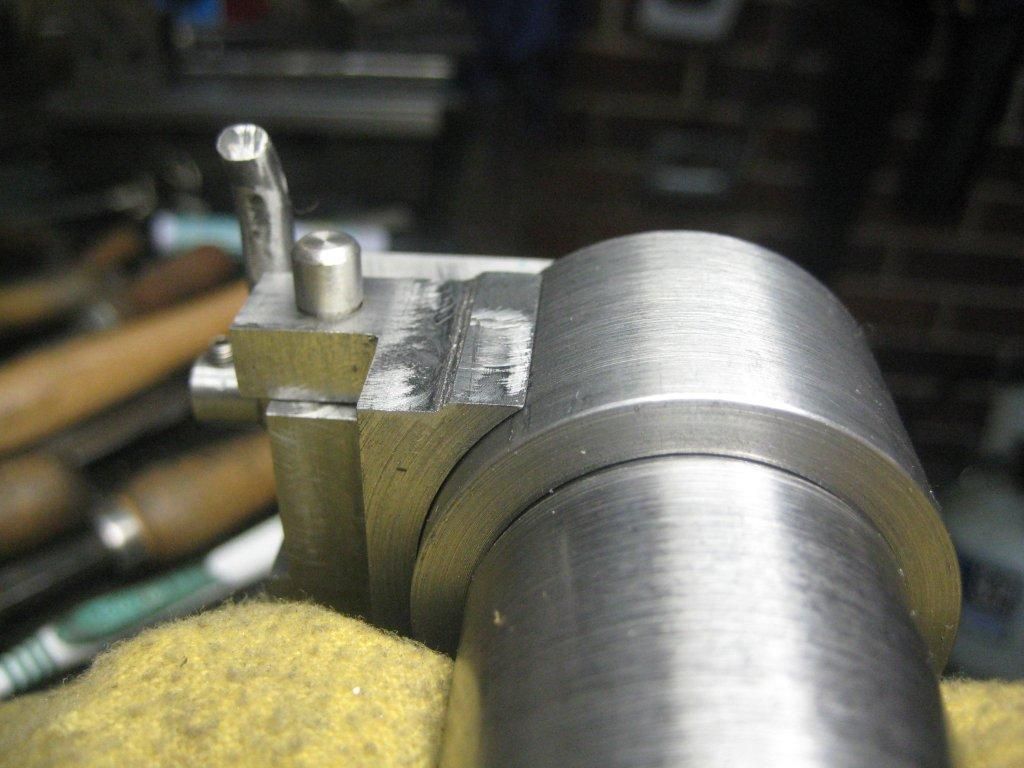

                  Breech testing. Finishing required
                  Breech housing
                  Breech assembly
                  Handle in open position
                  Handle in closed position

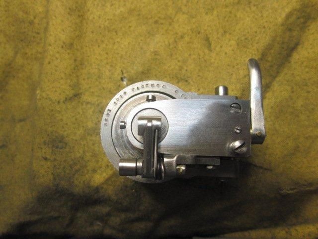

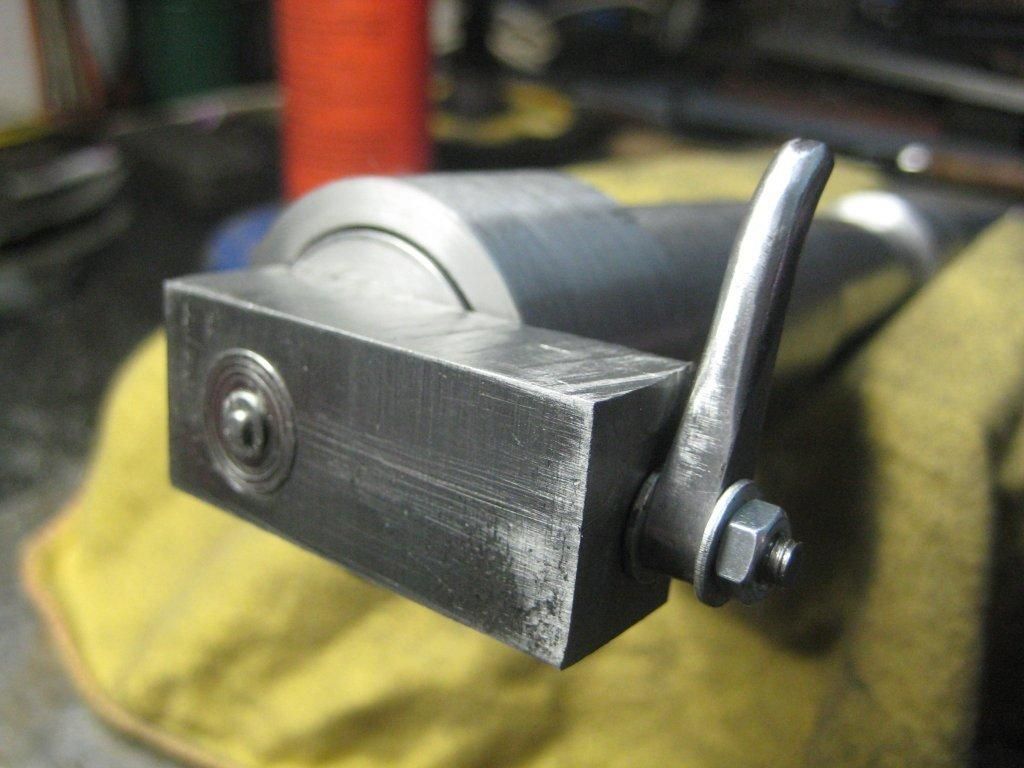

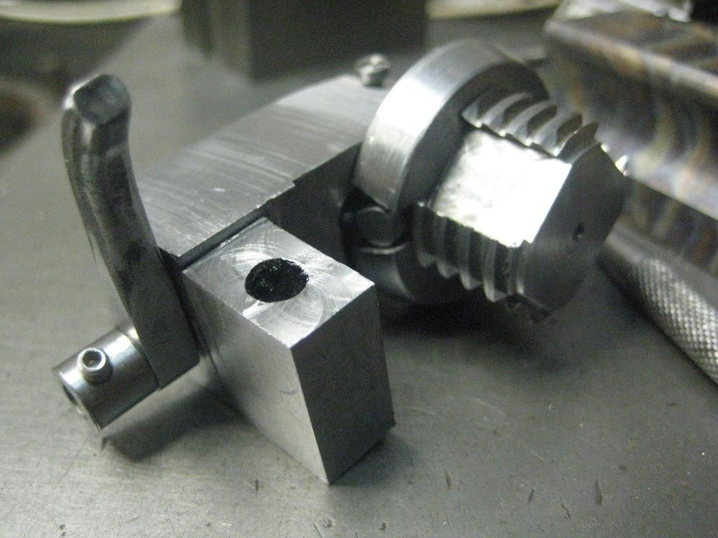

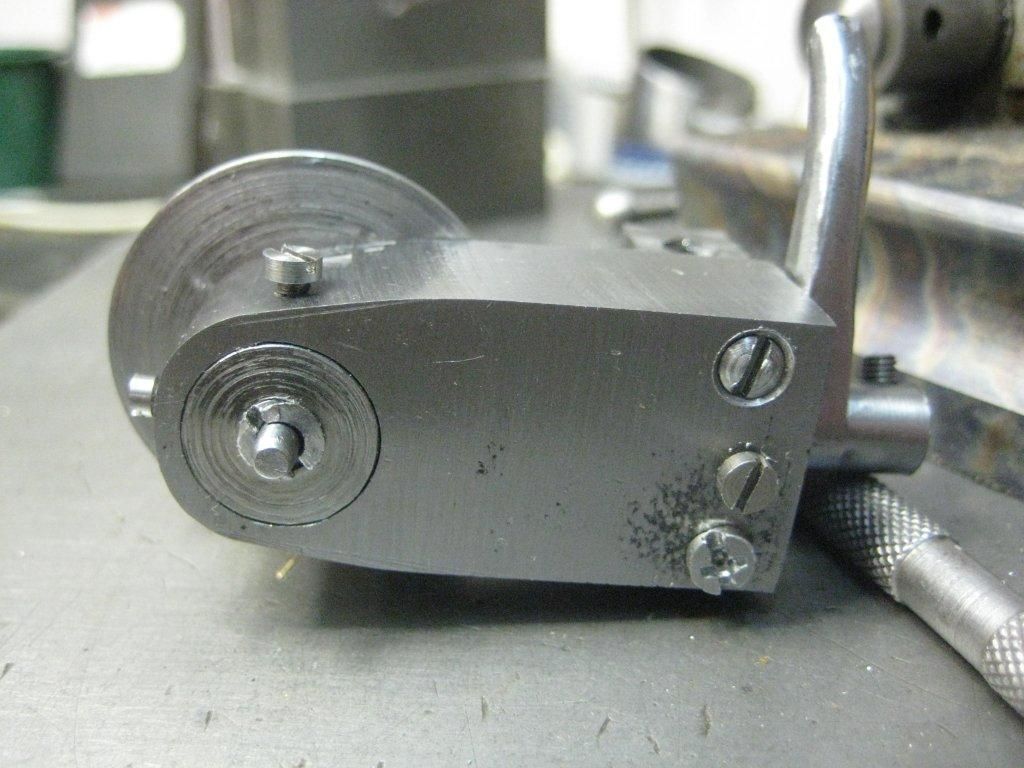

                                The following pics are of the working breech assy. It needs tyding up yet. The handle moves the cam which rotates the breech block, and the arm swings it away. Operation is smooth.
                                #117801
                                bob gould
                                  @bobgould42821
                                  functional

                                                Model engineering at its finest
                                                Original Vickers muzzle
                                                My models muzzle
                                                awesome

                                                  Looks a pretty good match to me. Im glad that i can see right through or i would think some one had caught up with me!!!!!!!
