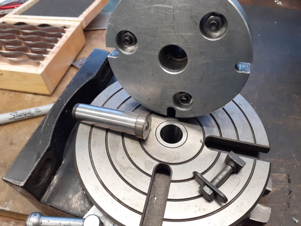

                Posted by larry phelan 1 on 10/11/2020 12:25:31:
                Jason,
                Would be interested to know how you clamp your chuck to your rotary table.
                Seems to fit very snug..
                Not sure how this got into a vice thread but here goes.
                When I bought the Soba Chonos also did a 3" chuck and backplate to go with it, bit limiting on size but can be handy when the table is vertical and you are working on small items as the quill/collet nut does not hit the chuck. The rear mount chuck screws on from the bottom of the backplate and is held on by tee nuts and bolts with curved "washers". There is a hole in the backplate which I use to ctr it with the aid of a turned down MT2 blank end arbor and a sleeve, downside is you can't then hold long stock as the hole in the R/T is plugged but if need be it can be centred up by other means.
                The Rotary table from ARC comes complete with a backplate as standard, similar method of attaching chuck to backplate but it is drilled and counterbored for the suppled cap head screws and tee nuts. The underside of the backplate has a short spigot on it that locates in a recess in the R/T's face so easy to centre and you can still put long work through the table.
