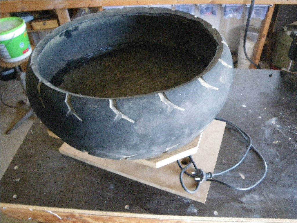

      Hello good people,
      I am building (almost finished) a vibratory tumbler using a rear scooter tire and an old electric motor from a car buffer machine.
      I live in Cyprus and I am having great trouble finding the right material as media. I want to use the machine to clean and debur small stainless steel parts I am making.
      Does anybody out there have a good idea what I can use? I was thinking of just trying sand with a little water. They also have a lot of granite grit here, will that do?
      The problem of course is that I might be able to find the nice ceramic cutting piramids etc, but I will have to order on-line and the postage to the island just makes that far too expensive.
      Looking forward to your comments and suggestions. Thank you in advance.

                          The idea with the scooter tire looks interesting to mee. Is it possibel to get a picture of your creation ? I use rubber lined PVC tubes as barrel for my rotary tumbler but it wears rather quikly. I think rubber from tires is more wear resistant. I use small ( about 1 cm ) triangles cut from stainless or brass cut offs with a spoon of sharp sand and soap water. This gives a very nice satin finish without rounding the corners to much. The best advice is : Try everything what possibly works and keep the best.

                            Do you have some ridges on the inside of the tyre? Otherwise it just slides round.

                              OK, Here are some photo's.
                              The tumbler is not finished yet, still want to add covers and I also need to add a central pillar inside the tire. So that stuff will rotate nicely.
                              Then I need to fill it up with medium and product and start to tune the counterweight and speed to get the right vibration going.
                              More images in the Album, Images by Lykle

                                Thanks for the photo's. They tell me more than 100 words. The project looks promissing. Perhaps is suspention by steel springs a better solution.They don't absorb so much energy as swing rubbers. I am very curious about the results. Please keep us informed.
