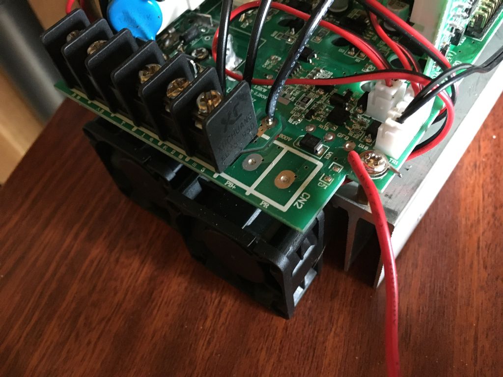

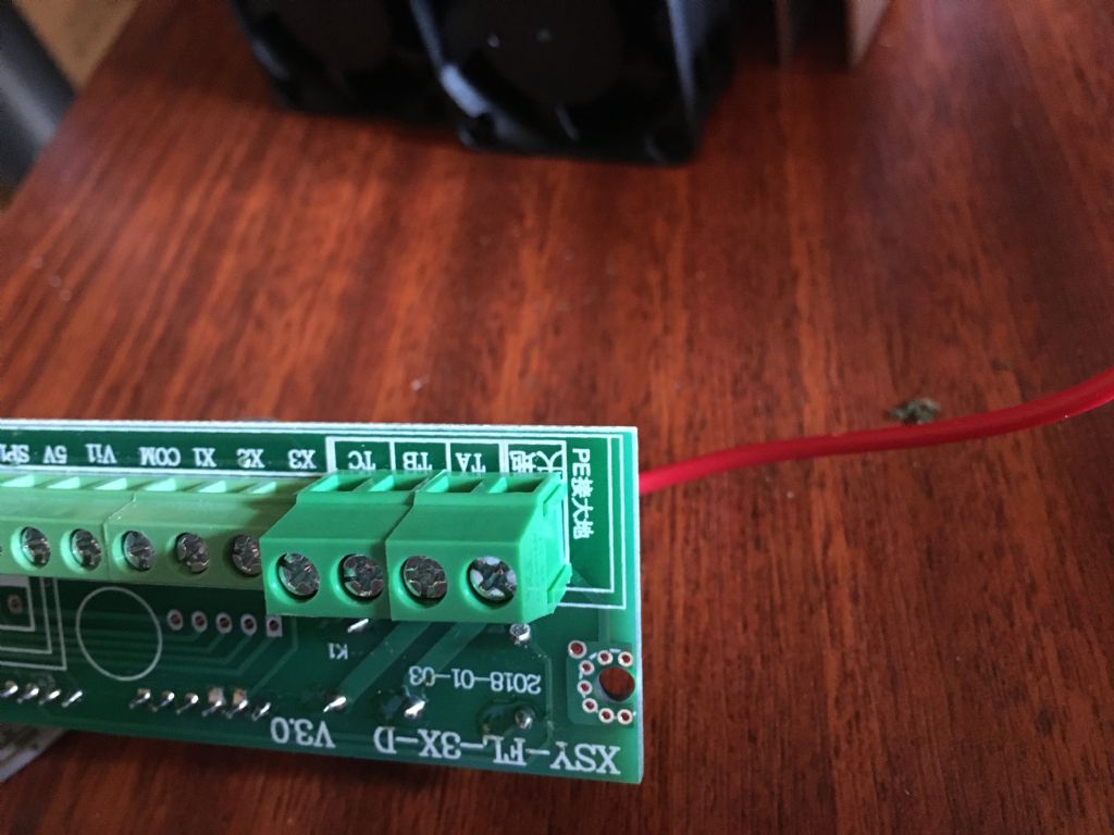

      Robert Atkinson 2
        @robertatkinson2
        Posted by Andrew Firman on 24/05/2020 14:49:47:
        Many thanks Martin,
        The PE terminal is quite easy to see when the board is removed from the case. There is a red wire that connects the terminal and the main board and then through the brass board supports to the fins
        The pot is new with a measured resistance of 10.7K . It seems ok but I don’t have any others to swap it with – awaiting a couple from China. I have set P10 and P11 to 2.
        I’ve checked the voltage between fins and a mains supply earth connected to the PE terminal and now get a reading of 3v ac down from 85v. Don’t know why it’s not zero but I guess one can live with 3v
        I’ve gone through all the “as supplied” parameters (including those not listed on the manual) on one vdf and once I’ve done it for the second one I’ll post a list listing all parameter settings “as supplied” .
        That protective earth (PE) connection looks pretty scary. Red insulation and a straght bit of solder tinned wire under a PCB mounting screw, The wire clearly is not large enough to carry fault currents on a system fused for 3kW (13A). Solder tinned wires (tin plated is different) should never be used under screw or crimp connections, The solder cold flows under pressure and a bad joint results. Used to be common with mains leads before pre-fitted plugs to find the leads solder tinned but this was found to be the cause of loose connetions and over-heaing plugs. Red wire on a PE is a technical breach of the acceptable standards.
        These things are a liability. As a minimum they must be inside a suitable enclosure. The user is legally responsible for making sure the installation is compliant with all relevant safety and EMI/EMC standards. In practice this does not happen.

                  Posted by Robert Atkinson 2 on 03/08/2020 11:43:44:
                  Robert G8RPI.
                  Hey Rob,
                  could you pls have a look at this:
                  **LINK**
                  What do you suggest what to do? I kind of figured I ground my motor to the VFD's PE, but you kinda made me change my mind. (This is the only ref point that I could call GND.)
                  What shall I Do?
                  Thanks, Greg

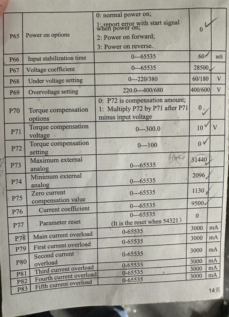

                                        I've just joined this Forum because this thread gave me an answer – which I have yet to check – to the same problem that the Original Poster asked – why does the internal potentiometer allows me to run a 4 pole 3 ph motor up to 100Hz but the external pot will only go up to 50 Hz.
                                        In my case I have a motor which is a 2 pole / 4 pole combination to allow 2 speed operation with an appropriate switching of the windings – there are 6 leads coming form the motor. I have done the internal change from star to delta on a previous motor but the thought of dismantling this motor and attempting to locate the star points put me off particularly when I found the AT4 – again a couple of years ago and have only got round now to trying it out.
                                        So thanks to all of you who previously fully discussed this out, and I am hoping the guidance will work.
                                        Rob
                                        #657131
                                        Robert Graham
                                          @robertgraham80849
                                          Yep – the guidance works!! Again so many thanks even if those in the 2020 discussion are no longer seeing this.
                                          The relevent list came from James Walker's posting of 25/05/2020, with particular reference to the settings for P73 and P74 – just how anyone found that these particular parameters are the key ones for this I just gasp at !!!
                                          Rob

                                              James Walker
                                                @jameswalker31828
                                                @Robert G – On my mill the turret moor is is a Dahlander motor which means it is dual speed without having two windings. Anyway I leveraged those two full speed ranges with the VFD by adding a mechanical switch to switch the winding connections. It means I can leverage a lower speed while keeping the VFD stresses down on the old motor.
                                                This is possible with the AT4 as it is a simple Voltage/Hz style VFD which are able to run multiple motors of the same type at once. As compared to a Vector VFD which is tuned to the specific motor parameters. And when you switch poles those parameters change.
                                                There is one rule you need to live by so you dont blow your VFD, NEVER CHANGE THE POLES WHEN THE VFD IS DRIVIG THE MOTOR. The motor must be stationary and the VFD idle.
                                                cheers – James.
                                                #657171
                                                Robert Graham
                                                  @robertgraham80849
                                                  Many thanks James for your comments and guidance.
                                                  I did expect this motor for driving the thicknesser rollers of the machine to be a Dahlander winding, but measurements show two seperate sets of coils; seemingly this is quite a popular format for large cooling fans, where a simple thermostat, and no electronics, will enable a higher cooling rate when required.
                                                  The motor, perhaps like yours, is probably classifiable as old but as it was also capable of running at 2800rpm, I'm using the 4 pole windings and taking the top frequency up to 100Hz. It's not going to be used on a commercial basis, just amateur, so won't get used heavily.
                                                  Out of interest how did you discover that it was P73 and P74 that had to be changed to get the external variable voltage to the bigger range?
                                                  Rob
                                                  #657173
                                                  James Walker
                                                    @jameswalker31828
                                                    Based on the description in my manual I figured that was probably what is was. Did some tests which proved my interpretation correct.
                                                    VFD Manual Page
