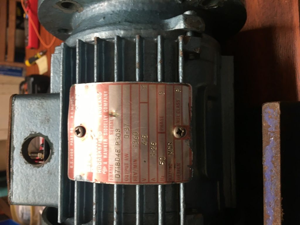

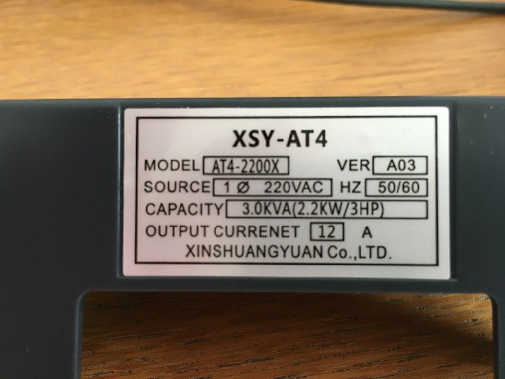

                          I tried using your P00 to P07 parameters but was unable to lower P03 below 4.0 so left all at the manual default settings. I changed P73 to P76 the manual defaults. Everything seems to work as it should except for the vibration when using Vfd#1.
                          I'm wondering whether we have the same versions of the AT4. Mine is version A03. I purchased mine in March 2019 and am only now getting round to checking them!
                          As mentioned before one of my AT4s (both setup with identical parameters) seems to cause a pronounced lowish frequency vibration. I've tried to illustrate in the linked videos
                          Video motor noise using different AT4s
                          at 50hz
                          #1Vdf ( noisy one) has a panel indicated current of 2.122 amps and clamp meter measured 1.32, 1.43 and 1.11 amps for W, V and U
                          #2Vdf has a panel indicated current of 1.985 amps and clamp meter measured 1.44, 1.51 and 1.50 amps for W, V and U
                          All measured currents are above the motor plate 1.26 amps rating. Should I be concerned about this?
                          Would the significantly unbalanced outputs currents on #1Vfd be the cause of the vibration? I guess there is no way of balancing the output currents?

                            If it is of any comfort, my devices all bear that label, but I wouldn't set any great significance to that. I doubt the QA extends to identifying the numerous production variants. Once the box has left the factory, you are on your own and up the creek…. Just sayin!
                            Until you really know if you need to modify the torque curve, best keep it linear as per the defaults. Shovelling more amps and volts into the motor at its most vulnerable (reduced RPM) is a good way to shorten its life.
                            wouldn't worry to much about the indicated currents as long as the motor isn't overheating. I doubt this device samples or filters the values so you are seeing the peaks.
                            Strange that one of the phases is 20% out. If true, and happens on all motors, that is quite significant and could be a cause of rough running. Not encountered this problem before.
                            You could see if making small changes to the carrier frequency P22 on VFD1 makes any difference ( no more than + or – 5 from the default value of 10 in either direction). Beware that increasing the frequency significantly will increase the running temperature of the motor (but make it quieter as somebody has pointed out). And vice versa.
                            Sometimes you just have to fiddle and even that doesn't always do the trick!

                              I suppose a better way of determining the version would be to compare dates printed on the pcbs.
                              Reducing P22 from 10 to 6 but it didn’t seem to make an apparent difference to the vibration.
                              I was reluctant to go above 10 because not knowing the normal operating temp of the test motor. I was a little concerned about the motor casing temperatures I’d measured. Running at 50hz with no load for 10 minutes, the case temp increased from ambient 25c to 46C in 10 minutes. At which time I cut power to the motor and the temp continued to rise to 51C at 15 min before dropping to 44C at 29 mins after commencing the test.
                              I guess the next step for me is to complete the enclosures, control panels, wiring and fit to my new to me T S M1 and start making chips 😊
