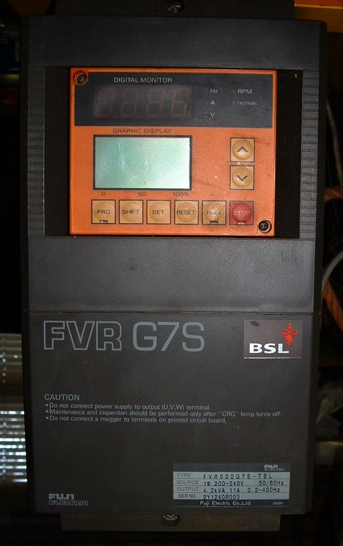

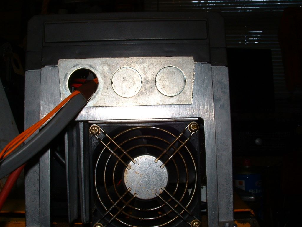

                                          Pictured a Fuji VFD removed from a frozen food factory, it was surface mounted without further protection adjacent to and controlling a flat belt conveyor from a blast freezer carrying frozen potato chips through a metal detector and discoloured chips that removed the discoloured chips and of course any metal fragments, they were removed from the belt by a pneumatic arm.
                                          The belt and detector were on a mezzanine floor so any removed bits fell into a chute to a waste bin, the product carried on and discharged into another chute that went to a Euro pallet size 1.5M high plastic bag lined wooden crate and then to the frozen product cold store to await packaging in another part of the site.
                                          I don't know the date of manufacture but I removed it around 1995, last time I used it was to test run a motor after fitting new bearings about 3 years ago when it worked OK, you will see the test cables coming out of the gland plate, pity I didn't fit at least a grommet.
                                          I believe this would have been purchased mid 1980's so now 35+years old, a top of the range and high cost VFD when purchased so it does give a thumbs up to reliability of the more expensive unit.

                                          #578136
                                          Mike Poole
                                            @mikepoole82104
                                            Emgee
                                            That has done exceptionally well to still be alive after 35 years, it looks to be quite an effective standalone case but would not be sufficient in a car factory body shop, apart from the metallic particles of weld expulsions from spot welding a hoseing from failed water cooling or a weld tip being pulled off has to be protected against, ideally the pressure and flow monitoring should shut the water off but not always effective. Inverters were not at a stage where they were ready for large scale installation in our factory around 1980 and Demag micro speed units were widely used for applications where a VFD would be first choice now. By the mid nineties VFDs were in favour and when the MINI line was installed in 2000 the standard was SEW Eurodrive VFDs and motors which are very sophisticated drives. The German car industry has much influence on their suppliers and SEW now build a complete module to control a main hoist motor with absolute encoder positioning and all the other motors for centralisers and track locks etc. Many hundreds of drives are used in a body shop and a wide range of sizes of motor, although we standardised on a limited range of sizes of VFD to make the spares inventory sensible. The largest drive was for a 100hp motor for a body side turntable, probably a few tons of jigs being rotated and positioned in a few seconds. Something of a contrast from the oldest drive I ever worked on which was a Ward Leonard control for the table drive of a Stirk Planer, the control cabinet had a slate backplane the front panel door was a cast iron frame and glazed, the controls were brass handwheels. It was funny that this was probably from the 1920s or 30s and was next to a 1970s Droop & Rein numerically controlled mill that also used Ward Leonard control for the axis drives. Technology seems to be moving at a phenomenal pace and to have an electronic drive in a home workshop would have been unimaginable not so long ago and now even an industrial spec drive is within reach without needing super deep pockets and I suspect would be the best choice rather than the very cheapest option but even if the extraordinarily cheap version lasts a few years and does the job it could be happy days.
                                            Mike

                                            Emgee
                                              @emgee
                                              Mike
                                              The VFD was mounted at around 4ft high and separated from the belt by a 3ft walkway, however the location IMO needed IP66 equipment which of course that VFD isn't, low pressure water used for clean down of the belt at the end of each of 3 8hr shifts.
                                              Emgee
