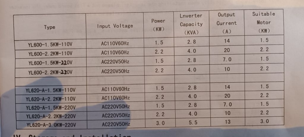

        I'm running a 3hp 3 phase lathe via a VFD. I matched the VFD to the motor but on reasonable sized cuts 1.8mm off the diameter (on steel) it trips. Is this likely to be one of ghe settings or is it better to oversize the VFD?

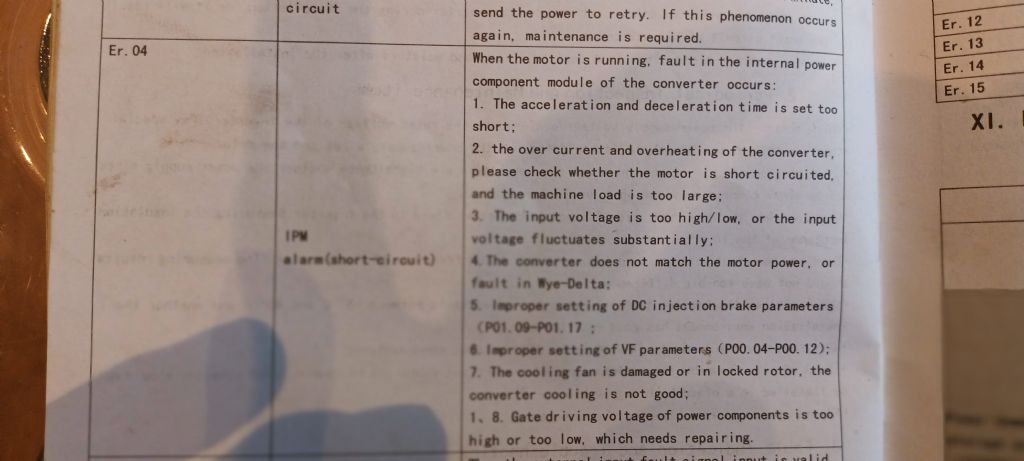

                It is tripping on error code 4 which covers a load of sins one of which is over current
                Just saying it trips with an overcurrent fault does not tell us much. For the particular setting that is currently programmed into the VFD, 'over current' could be 0.5A.
                As Mike says, the maximum current value is normally a user-settable parameter in the VFD. Read the manual or post a link to it and the VFD here and we can advise further. Try to measure the current the motor is actually pulling: separate one of the phase wires from the others and put a cheap current clamp meter on it.
                Make sure the ingoing supply to the VFD is adequate – cross-sectional area of wires and length of cable, even more so if you decide to pursue your 'somewhat oversize' route.
                Is the output of the VFD wired directly to the motor?

                  Looking at all possibilities (your fault is more likely with the VFD settings or installation) are the motor phase windings equal? An imbalance could lead to tripping. Is the motor a dual voltage machine?
                  A couple of mm depth of cut is not the whole story, by any means. Diameter, rotational speed and feed rate will all affect the power loading – as would the sharpness of the cutter and the material being worked.
                  The VFD may be too small (particularly if cheap chinese) as a 3 HP motor should deliver that power (2.2kW) but will require a greater input power, depending on the motor efficiency.

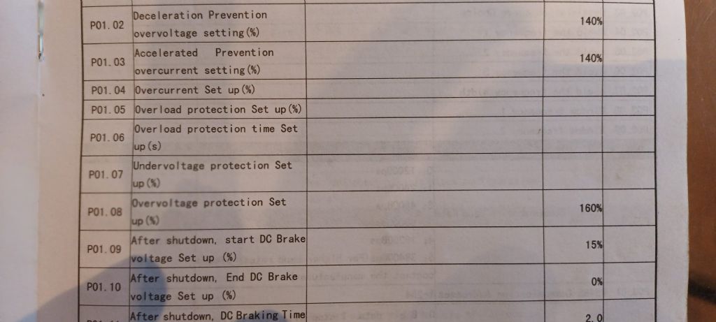

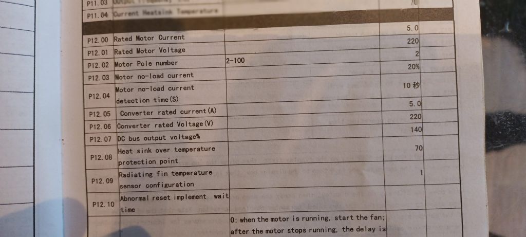

                      img_20211106_081920.jpgimg_20211106_081901.jpgimg_20211106_081754.jpgimg_20211106_081451.jpgI'm happy that the motor is operating OK as best I can. All the insulation resistance was checked on installation. I'm OK with the incoming feed. Its on a stand alone ring (2.5mm twin core and earth) and is no more than 5m from the main box. It all runs fine when I am taking it easy but starts to trip when the tool loading goes up. I do struggle understanding the manual I've copied what I think are the relevant sections below. At the moment the display is set to frequency I think this can be reconfigured to motor current would this be equivalent to actually measuring one of the phases?

                        Id seriously be checking some of the basic settings, particularly your motor parameters in the VFD. Maybe I missed it, but what 'kw' is your VFD rated to 2.2kw ? – thats possibly a bit low.
                        And I assume your motor is set up in the connection box to 'delta' – output voltage for the phases to the motor needs to be 230v.
                        I have set up a few of these now and the only time I had problems was when I didn't have some of the basics right. A good manual helps though.

                                        I reconfigured the motor to 220v 3phase. I sized the vfd on a simple 3 hp motor is 2.2 kW so I bought a vfd rated at 2.2 kW. I am seriously wondering because I went cheap it's only going to be good for 2.2kw on a good day. My lathe is nearly 50 and driving through a similar aged variator. I think I might just go better quality and a bit bigger say 3.5kw and get a bit spare in the bag.

                                          Colin before running out and buying a new VFD check that P12 is set to around 8 amps

                                            What is the actual current setting on the VFD? This is P12.0 (motor) and P12.5 (drive). The tables you show say 5A set but that a 2.2kW VFD output is 10A max.
