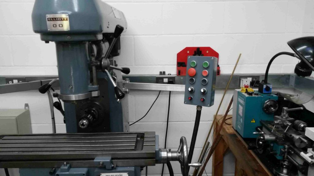

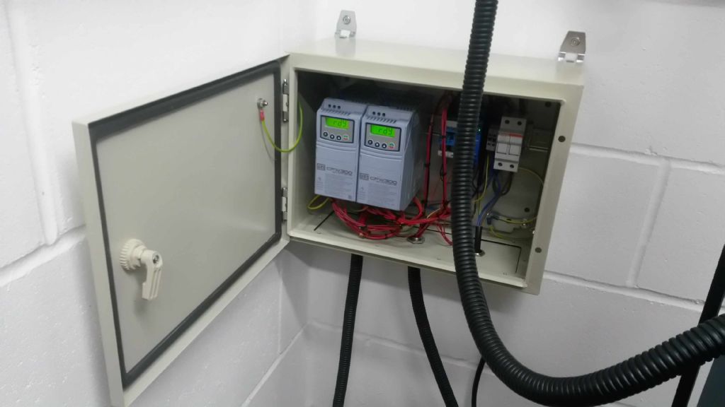

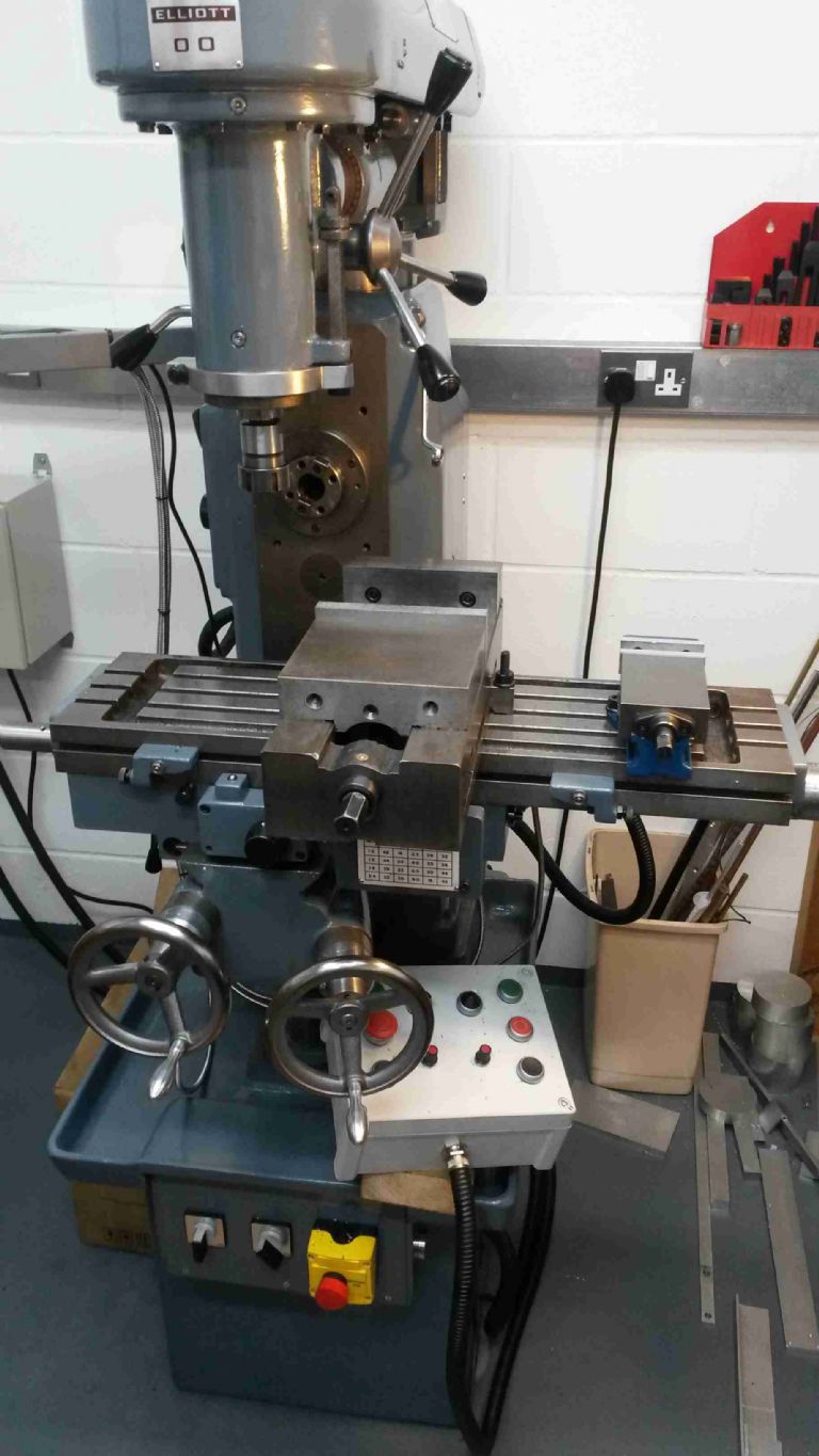

                                                Sounds like you want to do a similar thing that I did to my Elliot mill. In my case, I stripped out the spaghetti that was the original wiring, junked the original control switches and effectively started from scratch with the electrics.
                                                I started with a pair of WEG inverters – 230V types. The motors are not reconfigurable to delta, so I used the tehcnique described in the inverterdrive.com link to set the parameters. One VFD drives the horiz/vert spindle motors (a 3 pole 2-way switch changes over the motor connected to the VFD but you can't change whilst it's running – but why would you!), the other drives the table feed motor. I located the VFDs, fuses and a NVR relay in a wall mounted enclosure with two umbilical conduits – one carries 3 phase to the motors and the other carries all the control wires to the control box. I relocated the controls (the original controls were at knee-height which brings your face closer to the "action" when turning on/off). I had two goes at the design of the control box before I was happy with it.
                                                I chose the WEG inverters as the control inputs enabled me to control the motors as I wanted – start, stop, jog (rapid feed for table) fwd/rev and a speed control pot. I have a separate switch to disable everything at knee height for safety/emergency.
                                                For the coolant pump, which works but I haven't used it yet in anger, I used a Steinmetz capacitor to provide the 3rd phase. Cheaper than a VFD and you don't need the variable speed on the coolant!
                                                Some pictures for reference:
                                                Rob

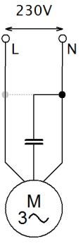

                                                    Hi Peter, If you run two motors on one VFD you'll probably have to start and stop them at the same time. VFDs don't like switched loads downstream.
                                                    The coolant pump is probably <100W – mine is – and all you need to get that to spin is a capacitor and a double pole switch. The connection is as follows:
                                                    The capacitor value I used was 8uF, 440Vac. I used a motor run capacitor from RS, which will only cost you a fiver plus the switch. My pump motor has 440V star connected windings with no provision for configuring to delta, but it still runs just fine on 240V.
                                                    This will enable you to optimize the VFD settings for the main motor (startup, run-down time). I wouldn't be without the variable speed – it saves a lot of belt changing – and if you have chatter you can drop the speed quickly without having to stop a cut, so I'd stick with the 3-phase motor and a VFD rather than go single phase.
