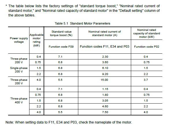

                                        Not sure what you mean? This is from the manual for my inverter, the engilsh is a bit stilted but later it specifically says that if the motor won't start (under load) increase torque boost F09:
                                        Manual torque boost
                                        In manual torque boost mode, the inverter maintains the output at a constant level
                                        regardless of the load. When you use this mode, select the appropriate V/f pattern
                                        (square reduction torque or constant torque characteristics) with Select Load (F37).
                                        To keep the motor starting torque, manually select optimal inverter output voltage
                                        for the motor and load by setting an optimal torque boost rate to F09 in accordance
                                        with the motor and its load.
                                        Setting an excessive torque boost rate may result in over-excitation and overheat of
                                        the motor during light or no load operation.
                                        Manual torque boost keeps the output voltage constant even if the load varies,
                                        assuring stable motor operation.

                                        • The F09 data setting is effective when F37 (Load Selection/Auto
                                        Torque Boost/Auto Energy Saving Operation) is set to 0, 1, 3, or 4.

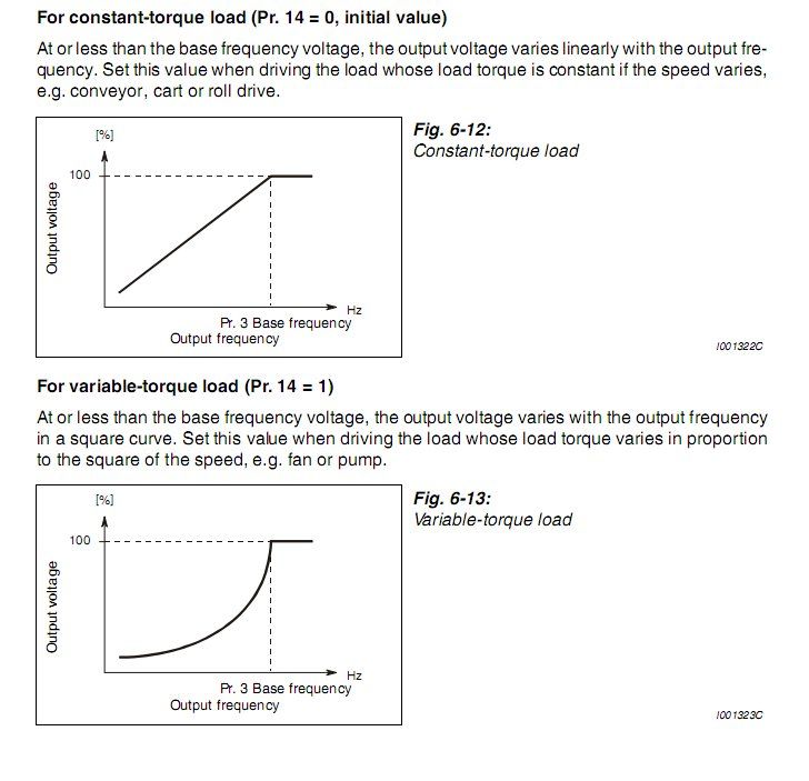

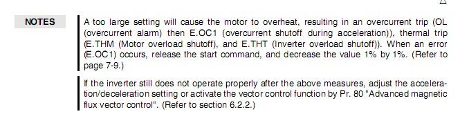

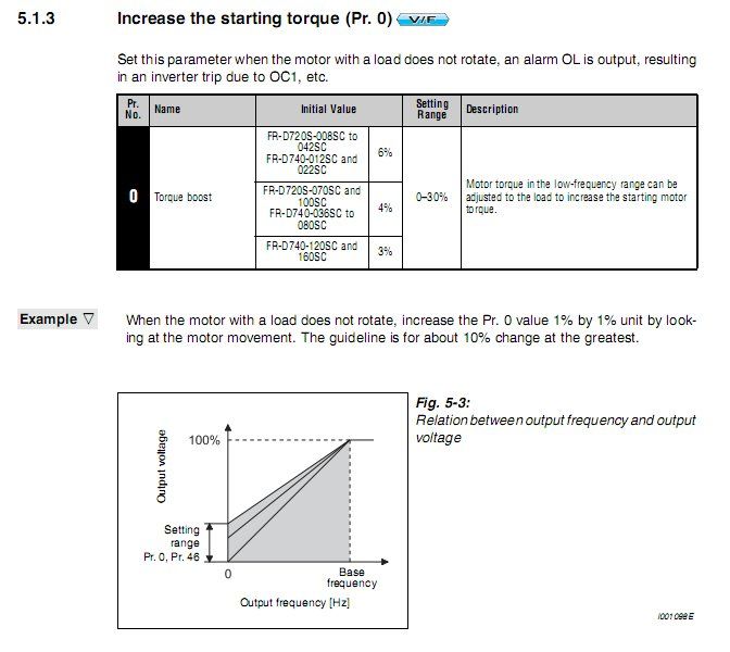

                                            This is what I have on torque boost Neil.
                                            To me this implies it still wont allow over current and it's main purpose is to get thing rotating when there is a significant mass to get rotating – in other words if a lathe for instance spins up don't use it.
                                            I've not found the constant speed section that explains why yet but I have found that this plays with motor slip so that the speed achieved is closer to the one demanded. It needs a self tuning facility to obtain the motor parameters. As I understand it this is what flux vector control is for.
                                            However it does mention 2 types of motor – high efficiency standard motor and constant torque motors. I read high efficiency motors as any standard motor. There are also setting to cause the inverter to change the drive frequency to avoid stalling and or over current.

                                              Found part of it !
                                              And a comment elsewhere
                                              **LINK**
                                              It also points out that load pattern settings which is what these appear to be don't function when flux vector is selected. Also add that mine defaults to 150% overload but there are tight time limits one it.
                                              Edited By Ajohnw on 28/07/2016 23:44:20

                                                Those are also in my manual.
                                                I think misunderstandings spring from the unfamiliar terms.
                                                I'd sum it up as:
                                                The graphs for constant/variable torque are for different types of load, while 'torque boost' is actually used with 'constant torque' and intended for things that require extra grunt to keep rotating at low speed – i.e. the torque/speed graph is pushed up a bit at zero and drops to normal at rated speed. While this is mainly intended for starting heavy loads, it's also useful for lathes etc. at the expense of more rapid heating.
