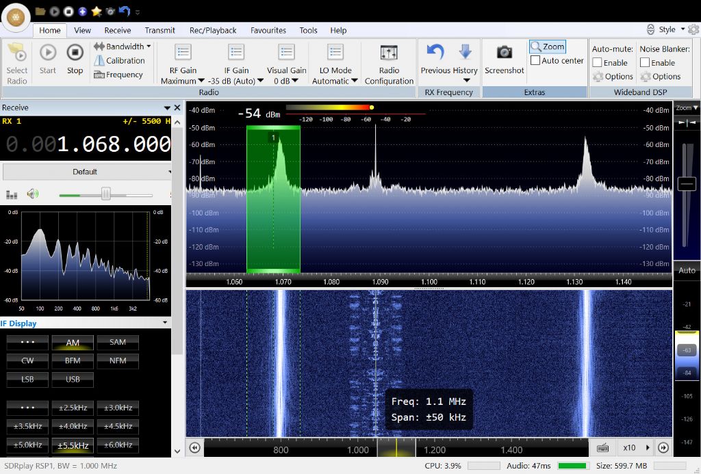

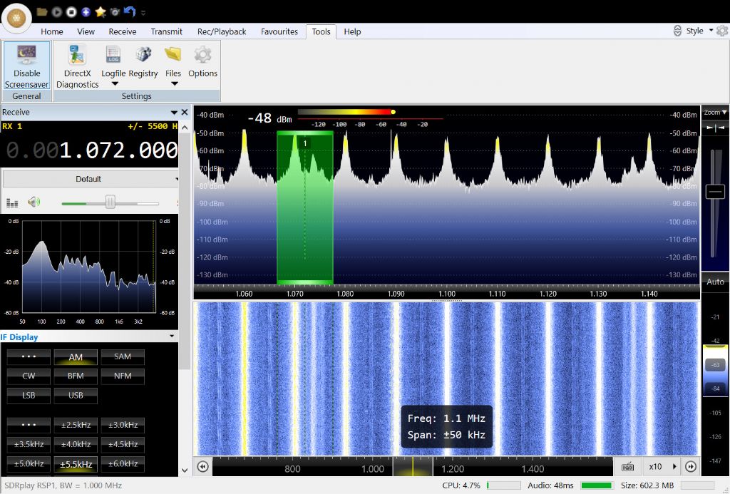

            John asked about Washing Machine Filters. Unlikely to be all that effective but should help a bit and wouldn't do any harm provided the one used can take the amps. I've thought of trying it.
            I can confirm comments about the inadequacy of domestic radios to detect RFI. DAB and FM both have strong signal characteristics – they're deaf to anything less powerful than the station they're tuned too, and also only listen in the VHF range. An old AM radio is  better, but testing EMC really demands the right equipment.
            Picture below is a slice of medium wave with the VFD on, but the motor off. The centre spike with fluffy sidebands in the lower pane is a local AM radio station, happily straddled by two powerful VFD noise peaks (one inside the green box.) These can only be found by tuning the radio to them.
            Driving the motor makes the interference much worse, effectively zapping the whole medium wave:
            Due to equipment limitations the images only show interference over a tiny part of the radio spectrum. Checking further shows my VFD puts out serious noise spikes all the way from about 25Hz to 150MHz. Not asked my neighbours if they have internet problems when I'm in the workshop, but …
            PS. After capturing the images I reduced the problem somewhat by fitting a shielded cable between motor and VFD. It's far from fixed though. I'd sort it properly if I used my lathe more often, only used it for less than an hour in the last week, so its unlikely to be a major nuisance. I hope!

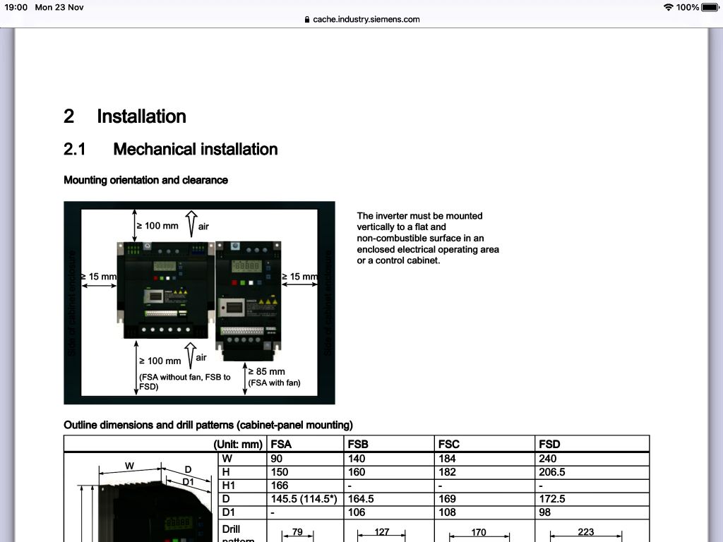

                  Siemens manual for Sinamics V20 inverter
                  Section 3 Mechanical installatiion, Sub section 3.1 Mounting Orientation & clearance :
                  "The inverter must be mounted in an enclosed electrical operating area or a control cabinet"
                  Seems quite clear to me ?
                  Section 5 Commissioning via the built in Basic Operator Panel seems to confirm that the BOP is primarily a commissioning tool.
                  Nigel B.
                  (sorry about the font change – cut & paste from the .pdf changed it and I can't see how to change it back).
