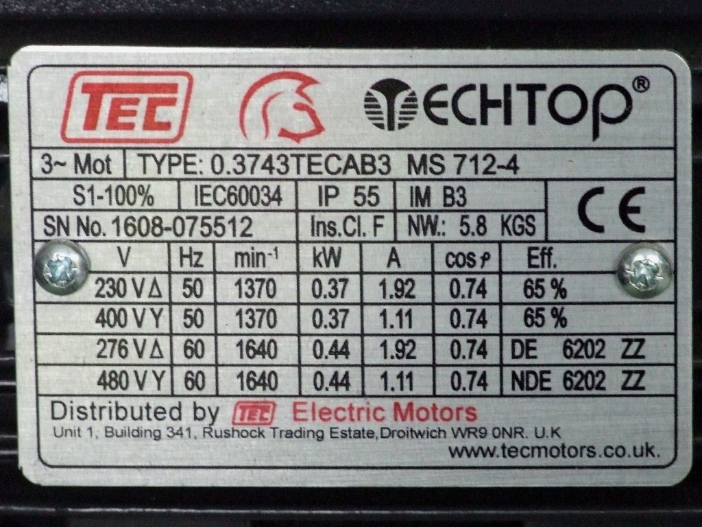

                Sigh, that is incorrect. Here's the plate from the 3-phase motor I bought to drive my Pultra lathe:
                The two lines for 230V delta and 400V star have identical powers.
                Andrew

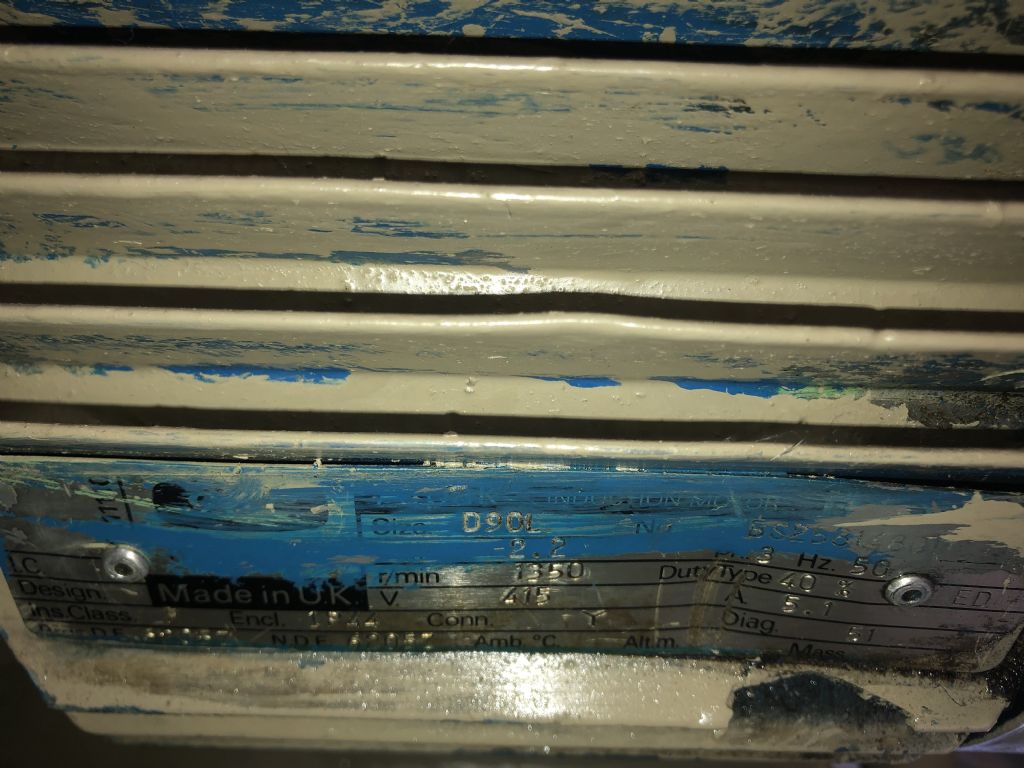

                  Thanks Andrew,
                  I am in contact with Transwave who said that unless it says 415/240 it's not suitable. It only says 415 and it's wound in a star (see photos, with apologies for previous owner's paintwork)img_1178.jpg
                  However if I can wire it into a delta configuration then presumably it'll be ok at 240?

                      Can you put up a photo of the motor plate? The experts can advise on the possibility of converting it. (I guess the star point isn't brought out to the terminal box, but it might still be accessible.)

                        Although the motor on the M300 is reasonably accessible my lathe is up against a wall. I've had a quick look but can't immediately see a ratings plate anywhere on my motor. Going on the experience of Alistair who has recently installed one the terminal block has six contacts which means it is dual voltage. Being a cynical old git I wouldn't put it past the manufacturer to buy dual voltage motors but mark them as 415V only in order to charge more for a dual voltage motor option.
                        A motor designed to run at 415V in star will expect 240V in delta, ie, divide the voltage by the square root of three.

                          Even if the motor is star only connection, you can modify the winding connections to give a Delta set up. There are motors where it isn't possible, but they are very rare. I recently converted a load of motors from star to delta even though the terminal connection block only had the 3 phases, neutral and earth The oldest motor was a dinky little 1/4 horse, BTH motor from the early fifties.
