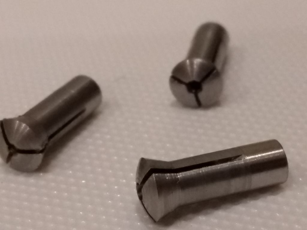

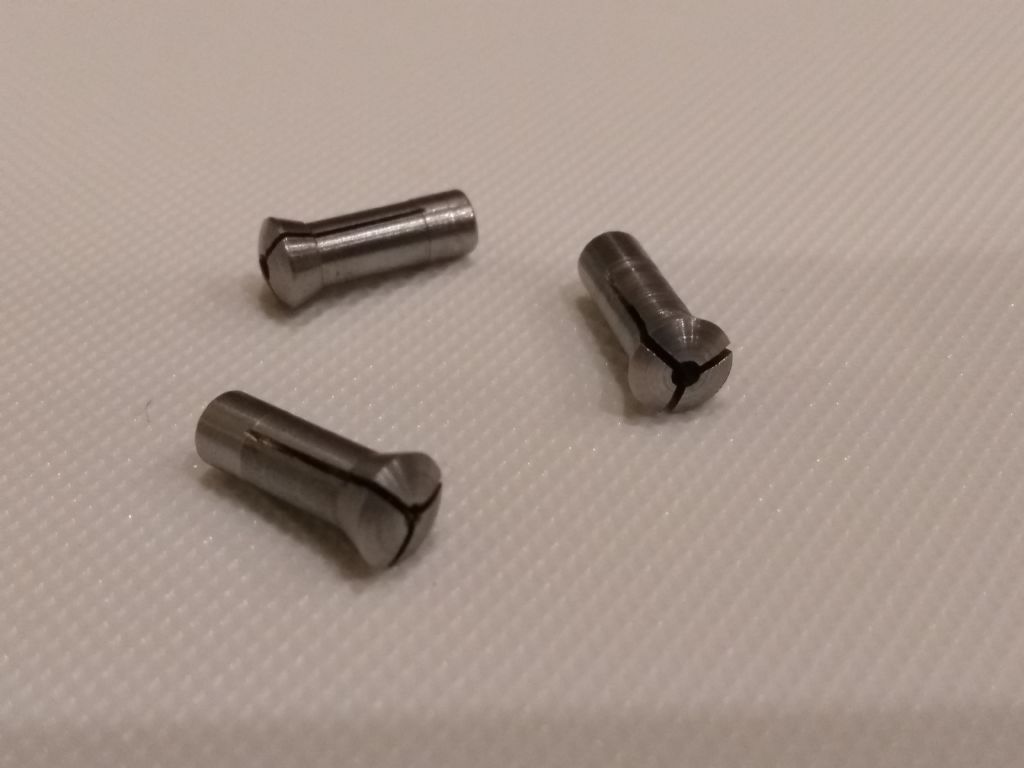

            I made some for a minature model stuart lathe recently 3mm 4mm and 5mm. I finnished the outside roughed the inside then finnished the in side by boring in situ in the lathe then hadened and tempered them. I got a friend to wire cut the slots.

                I made these 1/2" x1/8" collets and slit them with a 0.015" x 1" slitting saw which I purchased from my local Boyes general store for about £5 a set in various sizes.
                I drilled & reamed a piece of brass bar to 1/8" to accept the collet and used a brass grub-screw at the rear to aid location. It was straightforward to slit the brass bar and the collet in one go. Subsequent collets were held quite firmly despite the presence of slots in the brass bar.
