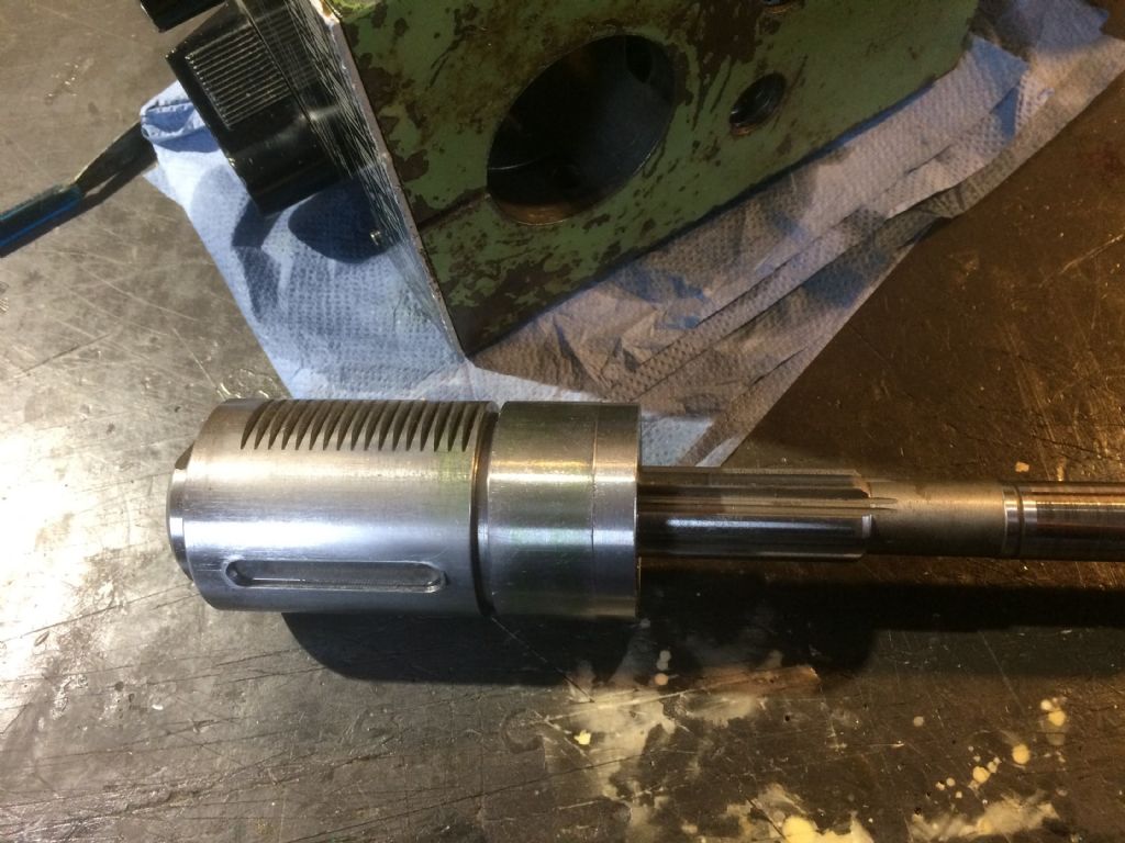

      Hi, I wonder if anyone can help me with a strange issue with my Emco milling head. Its actually mounted on a Maximat 10P, but the heads at the same – mine is the six speed one. The quill feed (not the main mill down feed) is very stiff – requiring almost both hands on the handle to move it, needless to say the return spring is not doing anything. By way of full disclosure and for maximum embarrassment I need to admit how it got to this situation – I left the my ER collet on it MT2 taper in place for many months – I hadn't needed to remove it. Needless to say it had jammed and after trying other approaches (I know what I should do….) I ended up with the hammer option. This was "ok" until I lowered the quill to its full extension and tried thumping it again. This caused the problem and also didn't free the taper, so I've disassembled the head which is remarkably easy – I'll write another post on how if anyone is interested. So I had it all apart and I can now say that it is NOT:
      1) The quill lock – this is backed right off
      2) The quill alignment screw on the left, which runs in a keyway
      3) the drive splines – the tightness occurs before these are engaged
      So I've gone over the body of the quill looking and feeling for any raised areas – like at the start of the rack perhaps caused by an idiot with a hammer. I've re-inserted and looked for scoring, I've applied engineers blue looked for obvious tight spots. I've used a light emery on any possible issue spots, but the thing is still tight.
      Anyone got any ideas?

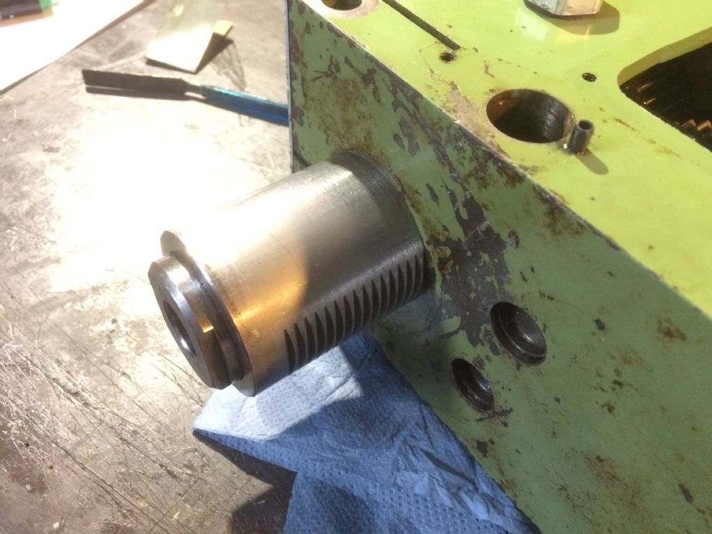

                          Hi, thanks everyone for your replies. Its been a wet weekend so by chance I've taken the mill apart again, actually doing almost all the things that Joe Noci has suggested in his post, even though I hadn't seen the post! This was motivated by checking the runout on the spindle and having found it to be more than +/- 0.02mm I was thinking I had indeed damaged the bearings. I've taken it apart more thoroughly, this time removing the main drive gear (Part 12 in the manual, called "sliding gear" – @Joe, thanks yes I have managed to find a manual online, however the numbering is plainly different, perhaps I could get a copy of yours…). This was prompted by the thought that the stiff quill might be caused by the top static bearings tat support this gear being misalligned due to my inappropriate earlier actions.
                          (Note: there are five bearings in total. The quill/spindle has three – needle rollers at the botton and two ball races at the top. Then there are two more ball races holding the slide gear in place (which itself doesn't slide).
                          This has revealed several things:
                          1) There is ample clearance on the splines – they aren't damaged, nor do they cause any resistance, therefore the chance of a misalignment .
                          2) The run-out on the splindle is unmeasurable when the quill is re-inserted without the drive gear assembly – i.e. the needle simply doesn't move, so better than +/ 0.002mm. This looks like good news, I assume it means these bearings have survived with little or no damage
                          3) The sliding gear bearings seem to be OK – need to do some more checking on this
                          4) The quill is still stiff – so having removed the quill locking mechanism, (I can confirm that it is nothing to do with that), This reveals that the quill locking body is permanently gripping the quill – it is a split collar type locking mechanism – either it is permanently bent inwards (i.e. in the direction the locking handle applies), or in a downward direction due to force from above. I've used a spreader to investigate the first option and this has made the bottom of the quill movement much easier. However I'm concerned about the second option – and this chimes with what you mentioned Joe.
                          5) I've inserted the quill from the top and the bottom, both the correct way and "upside down" and concluded that something is tapered. Either the quill tapers (narrow at the top), or the bore tapers. Generalising I'd say it goes in easily until the bottom of the quill meets the bottom of the body (regardless of direction. This again points to the split collar being bent slightly.
                          So I'm currently pondering what this means – the quill is now a little looser, having worked the locking arms apart slightly. The bearings on the face of it seem ok, its just when it is all assembled I get that run-out. It might be that the top bearings if put back in after the quill might assume a more cooperative position… I'm very reluctant to go anywhere near lapping compounds – these components used to fit together OK, so the question is what has changed? @Joe I will investigate your comment about the bugle in the quill. My attempts with the engineers blue indicated that there were no specific high points around the quill – but I was looking for vertical lines – where some single point (like the splines for the quill handle) had been damaged and therefore rubbing. Your idea would cause tightness all around and I thinking all I would see is blue everywhere – which is what I did see, but doesn't differeniate between normal and tight…
                          I'll update you on progress this week.
                          Chris

                          Henk Bonestroo 1
                            @henkbonestroo1
                            Hi Chris (Long1),
                            My name is Henk and I live in the Netherlands and new on this forum. Since I encountered the same problem as Chris. I'll post some photos of the spindle and quill. Checked for roundness of the quill and it is within 0,01 mm except for the top of the keyway. There I measure a few hundreds more thickness. Could it be that if someone (I got it second hand) tried to force the quill beyond the 40 mm down movement with extreme force and caused a high point at the end of the keyway?

                              Definitely looks bruised and like it's been rubbing at both ends, perhaps someone hammered the quill down to set the taper.

                                Hi Chris,
                                I have just been reading through your opening post for the first time today, As soon as I read you lowered the Quill in your attempt to extract the taper, I knew what had happened.
                                There is bound to be damage at the top of the Quill Guide slot as Henk shows above, but may be not as bad as that shown. You may have also damaged the locating bolt end where it fits into this slot. It may even be bent, and so may be rubbing on the bottom of the guide slot as there is not a lot of clearance here.
                                I suspect also that you will have damaged the Ball races in the Quill itself due to the hammering. Beware the circular nut in the centre of the quill is a LH thread, should you decide to take this apart. Unfortunately the ball races are not standard issue. They are specially made for Emco, in that they have to be assembled with the faces marked abutting. This takes out any end play in the races. Replacing these with standard races will probably lead to some play in the spindle vertically.
                                Hope these notes help,

                                Chris Long 1
                                  @chrislong1
                                  Hi Gray
                                  Thanks for your message, I suspected that I might have done this before my very first post, but at that point, on inspection there was no visible damage to the end of the slot. I had gently ran I file over the edge of the top of the slot in case, before embarking upon the engineers blue session… (BTW for others the slot is a keyway cut in the quill. There is a bolt on the left hand side at the base of the milling head, which engages with the keyway and keeps the quill from rotating. If you don't remove the bolt and hit the top of the quill it could burr the keyway, as in Henk's pictures, if you do remove it and hit the quill you will burr the quill splines instead… DONT HIT IT)
                                  Anyway, to double check I'd also got my surface table out and started looking for bulges, etc, based on Joe's suggestion. I couldn't find any. I got a light behind the table and quill and could see if there was anything out of true as I rolled it along the table. I could only see light when the splines or keyway were lowest, which was what I expected. The keyway has actually removed part of the circumference of the quill so you can see light at that point. That was yesterday. After your post I went back and had another l look, and discovered that on close inspection, when the keyway is lowest, the light stops momentarily at the top end of the slot! There is actually a high spot right where you suggested. So back on the bench I've very carefully removed this with a small modeling file and finest emery, taking about an hour to remove just the smallest amount each time. Result is that the quill now goes back where it should without much resistance. For others in this situation I think it is worth pointing out that this damage (a) isn't visible to the naked eye, (b) you can't feel it (it isn't a burr) and is (c) quite difficult to spot even with the surface plate and light. (d) Measuring with a height guage and using calipers both failed to pick it up.
                                  Anyway, I'll update on the reassembly results, but thanks for your suggestion. I'm hoping the bearings haven't gone…

                                  Dave Halford
                                    @davehalford22513
                                    Shows you how tight the quill tolerance is.

                                      The actual EMCO Quill drawing states a tolerance of g5 on the 52 mm diameter. This in terms of a measurement is -0.01 / -0.023 mm, or minus 4 to 9 tenths of a Thou.
                                      Emco in their infinite wisdom specify a chamfer of 0.4 x 45 degrees at each end of the slot to try and mitigate burrs at this point from affecting the sliding fit.
