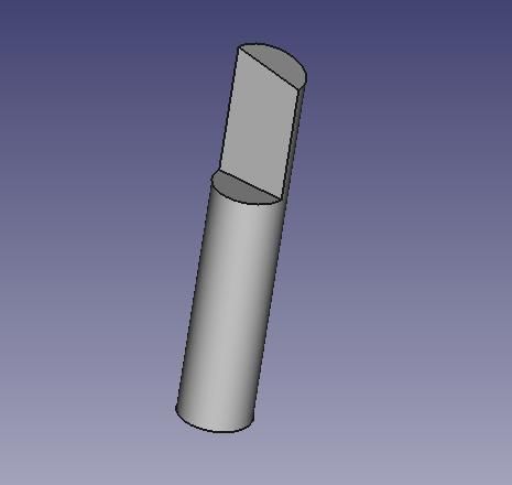

                Posted by Dave S on 30/07/2022 17:54:32:
                Drill 1mm and then make yourself a single flute drill from silver steel, also known as a d-bit.
                Dave got in first, but I have a picture!
                The silver steel is turned to the wanted hole diameter. Then harden the rod and grind half the diameter off to make the 'D' outline. Finally, the top is ground at a slight angle. Important the 'D' profile be exactly half the rod's diameter, or no more than a smidge under.
                D drills cut slowly and need a pilot hole and plenty of lube.
