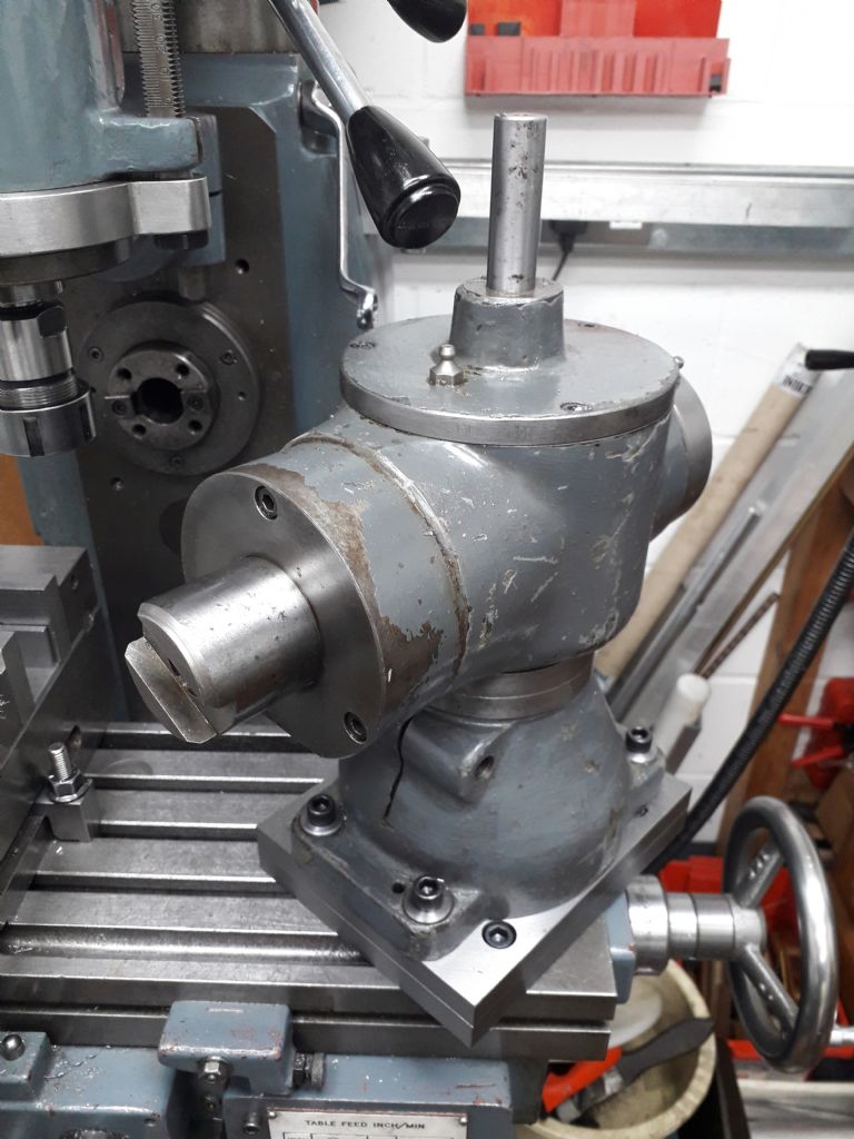

        I have a vertical milling head that I acquired a while ago and adapted it to fit the horizontal drive of my Elliott 00 mill, in the mistaken belief that it might make setups a little easier when cutting helical gears, as the normal vertical head swings way over towards the edge of the table leaving precious little room for a dividing head. Here is that head:

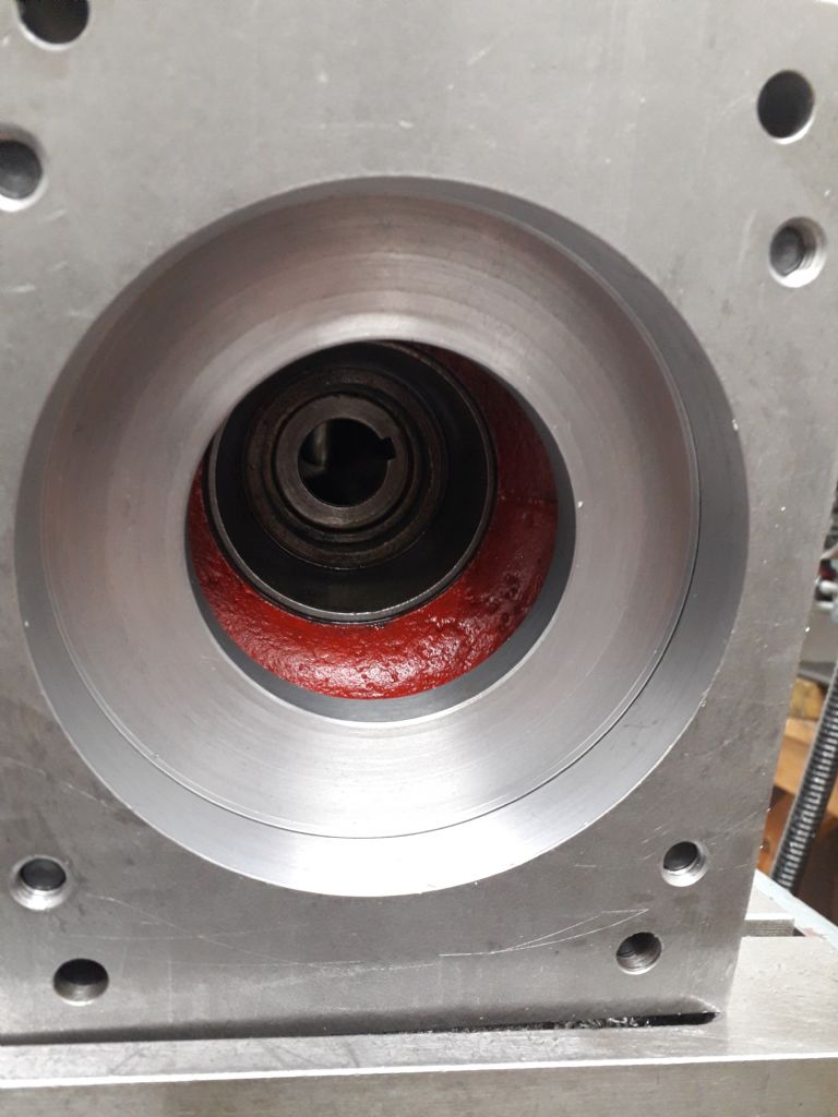

        If it's of any use, I could be persuaded to part with it for a reasonable sum. It's 3MT in the spindle end, the drive I believe is a keyed 1inch parallel shaft:
        The two steel plates make up the adaptor to fit existing screw threads in the mill – two holes partially overlap hence the two plates. I made up this drive shaft using an INT30 endmill holder off ebay:
        I never got any further than stripping it down cleaning, greasing the bearings and getting it running on the mill. I have too many projects on the go to do anything else to it.
        Please PM me if its any use.
        Rob

              Rob and I have now struck a deal over his unloved attachment above, which will still require some adjustments to work effectively on the Harrison, but saves a great deal of work compared to making the unit from scratch.
