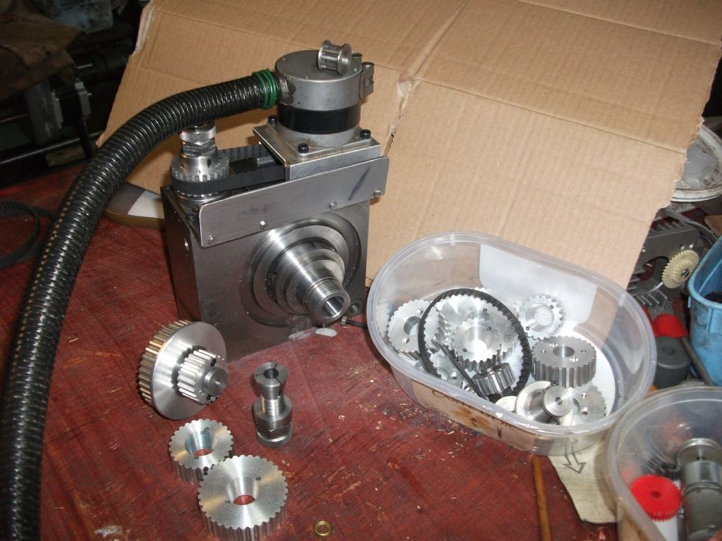

                        John P
                          @johnp77052
                          Going back to the OP original question .
                          "I'd now like to move the table through minutes and seconds
                          ( to be precise 19° 3' and 12". I can't work out how to do this.
                          Could someone please talk me
                          through it in a Pooh-Bear-of-Little-Brain-speak?"
                          I think there is little doubt from the many replies that there
                          would be a slim chance of obtaining an accurate position
                          of 19° 3' and 12" simply because of the mechanical errors
                          within the rotary table and also being able to count using
                          the existing hand wheel set up would be difficult to keep track of .
                          As has been mentioned before the stepper motor route would
                          be most likely to be able to count with some accuracy.
                          My own cnc rotary table has a worm and wheel ratio of 75 to 1
                          and connects to the stepper motor with a toothed belt ,as part
                          of some alterations which included regrinding the morse taper
                          some additional drive pulleys have been made, these also
                          have some secondary functions on some other machines.
                          In doing this the rotary table can be between 75 to 1 ratio
                          and 142.5 to 1 with the pulleys that i have at this time.
                          Just playing around with numbers on this table using a 10 tooth
                          pulley on the stepper motor and a 72 tooth driving the worm
                          would make the table 540 to 1 ratio in whole step (200)would equal
                          108000 steps per rev .Since there are 1296000 seconds
                          in 360° divide by 12 to equal 108000,so a single step now
                          equals 12 seconds . 19° 3' 12" = 68592 seconds divide
                          by 12 for 5716 motor steps .
                          It is unlikely the rotary table will be accurate but at least
                          the count will be correct.
                          For a 90 to 1 table the 72 tooth pulley is changed to
                          60 tooth for the same count.
                          Probably too much work to set up if you don't already have
                          something like this already.

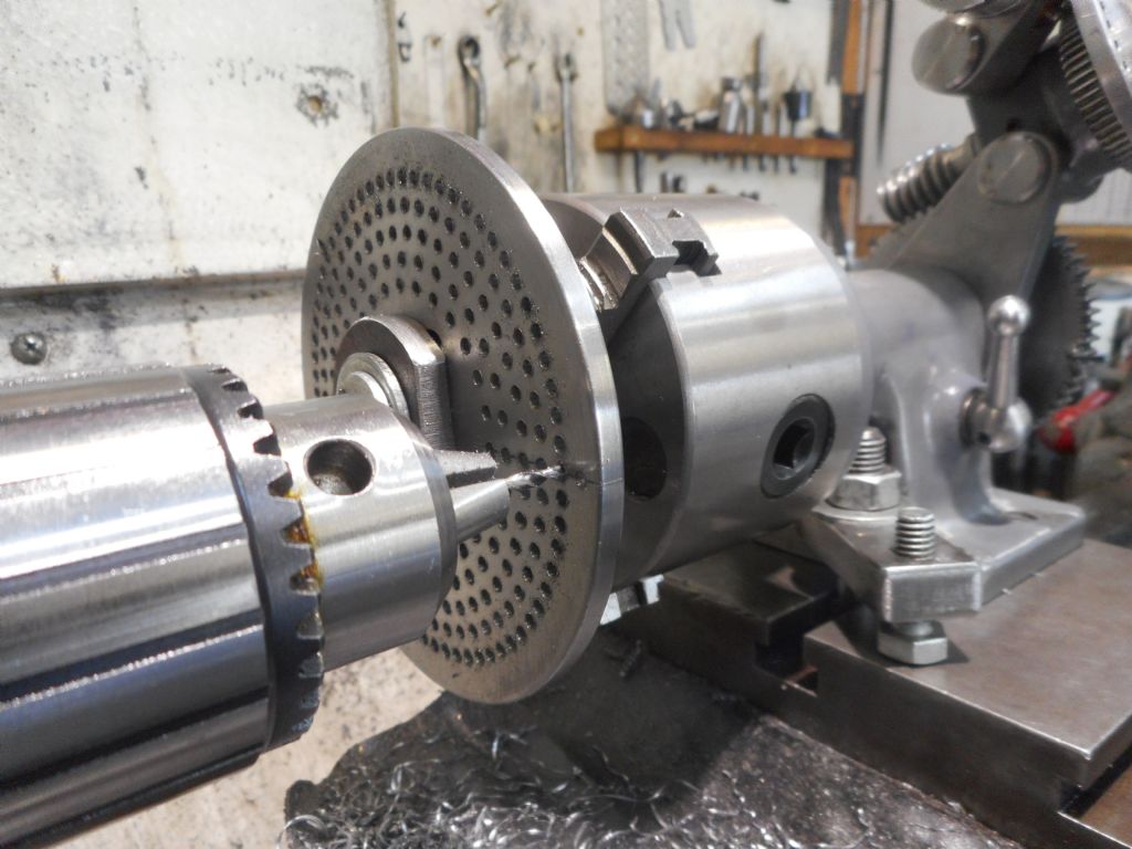

                                              Anonymous
                                                Posted by Hopper on 22/01/2021 10:09:55:
                                                Guess I was spoilt with a being able to just walk to the tool crib and get an index plate to suit.
                                                Lucky you. smile I had to make my own:
                                                Dividing Plate
                                                Andrew

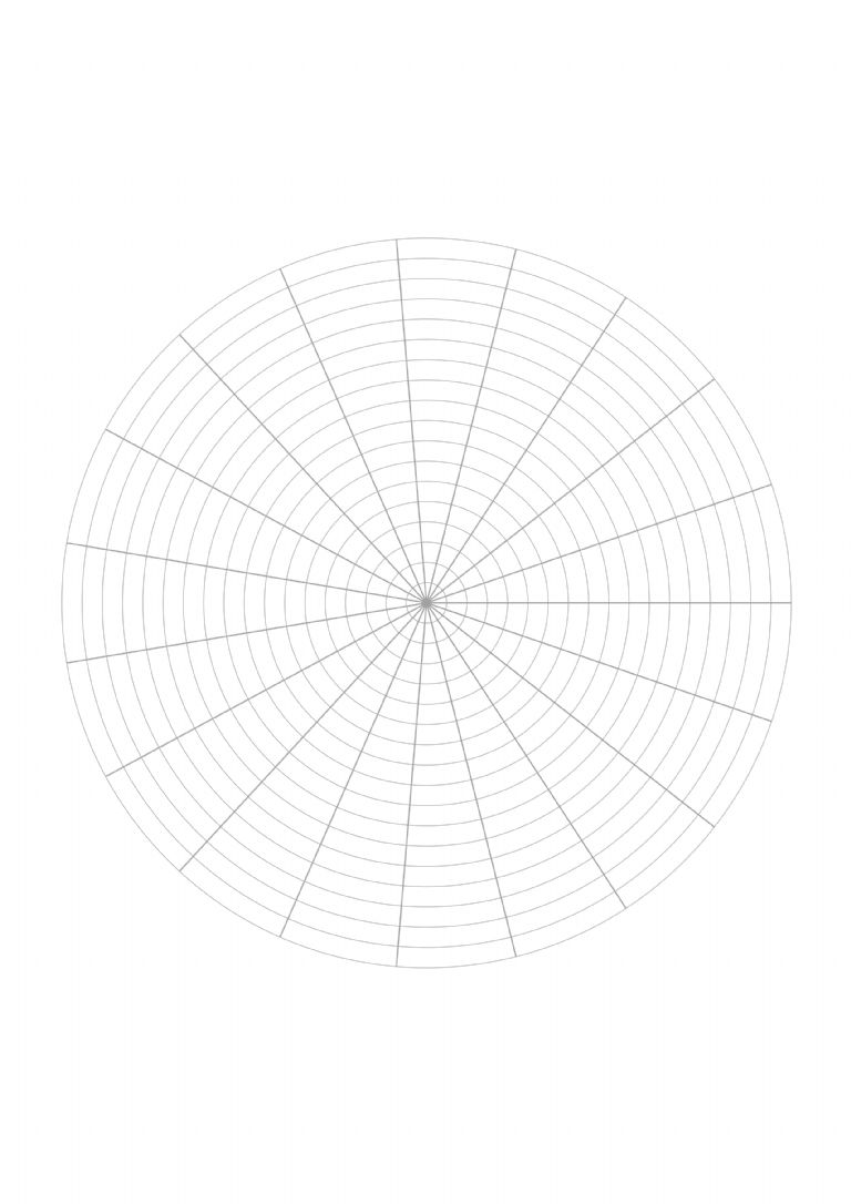

                                                  Now that we are aware that Martyn’s opening question was based upon a false premise, and he actually wants 19 ‘teeth’ on a plate, to engage with an elastomeric coupling …
                                                  Here is a template for the indexing:
                                                  Even as a paper print from a jpeg file … it is probably adequate for the purpose.
                                                  Just cut a suitable size circle and stick it to the handwheel on the rotary table … the worm reduction will even things out.
                                                  This has been an interesting, but largely irrelevant discussion.
