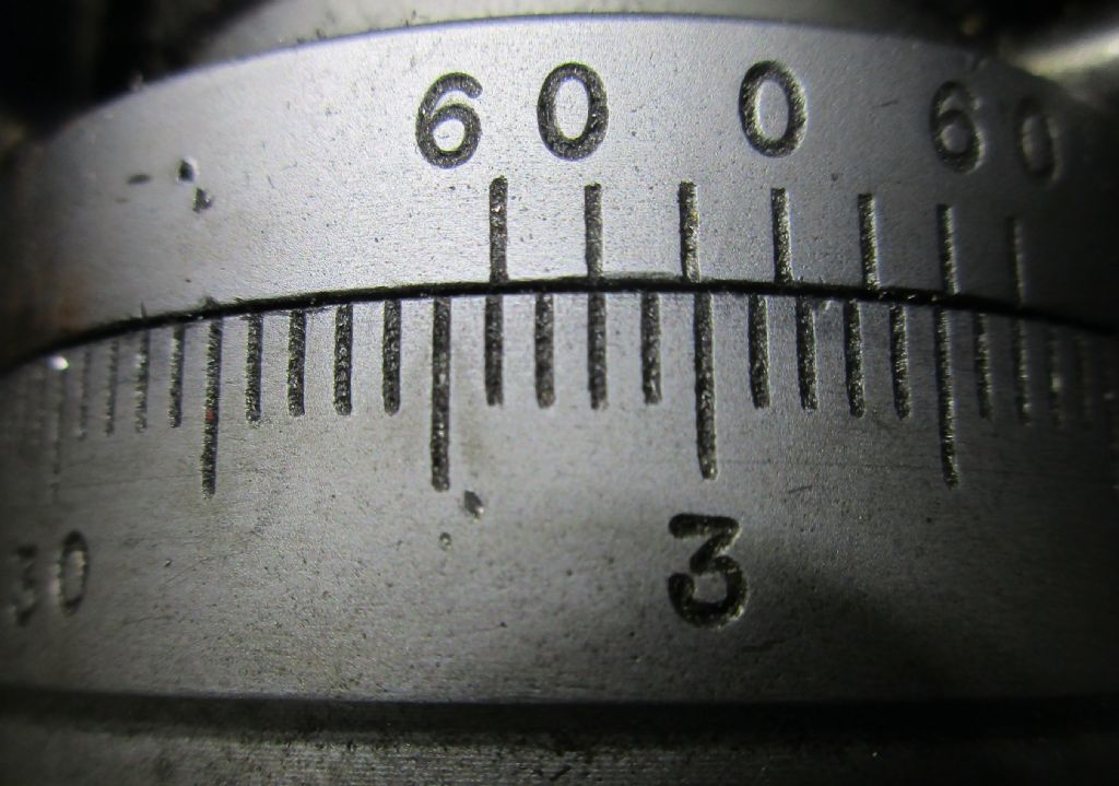

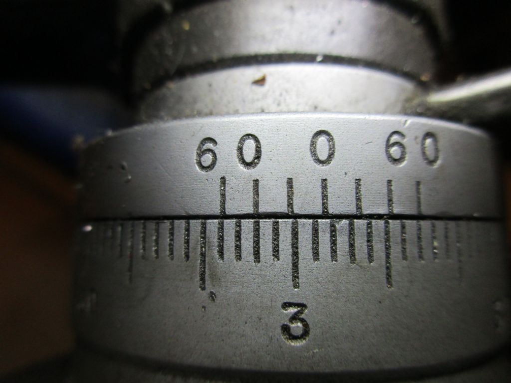

        Hi Martyn, showing my dials again at 1 degree 25 minutes and 20 seconds.
        Vertex HV6  RT
        You will notice on the 60-0-60 scale that there is almost 13 divisions past the figure 1 lined up with the 0, so that is 25 whole minutes. you will then see the only other line that is in line with the 60-0-60 scale is the 11th line from the figure 1 and seeing that it is only one line away from the 0 on the 60-0-60 scale, makes the 20 seconds. So in summary; when turning the handle, first of all you take note of how many degrees have past the 0, then how many whole minutes and finally the seconds counting away from the 0 on the 60-0-60 scale left or right depending on which line is in line with a line on the handle divisions. Just to add that the 60-0-60 divided be 6 = 3 x 20 seconds each side of the 0 but only one of them will line up with a line on the divisions on the handle at any one time.
        Hope that is as clear as mud as the saying goes.
        Regards Nick.
        Edited By Nicholas Farr on 19/01/2021 08:28:51

            Hi, I have to correct myself in the last sentence in my previous post, that is, the two lines on the vernier scale at both 60 marks will line up with lines on the handle divisions when the 0 falls midway of any of the divisions on the handle scale; i.e. if in my example it was 1 degree and 25 minutes, then the 0 would be between the 12th and 13th divisions away from the figure 1 and both 60's would line up with a division line and you would therefore read 24 minutes and one of the 60 seconds, making it 25 whole minutes.
            Regards Nick.

              Posted by Nicholas Farr on 19/01/2021 08:11:36:
              Vertex HV6  RT
              You will notice on the 60-0-60 scale that there is almost 13 divisions past the figure 1 lined up with the 0, so that is 25 whole minutes. you will then see the only other line that is in line with the 60-0-60 scale is the 11th line from the figure 1 and seeing that it is only one line away from the 0 on the 60-0-60 scale, makes the 20 seconds. …
              I'm indebted to Nick because I've been reading the Vernier on the wrong side. Thank goodness I've never used it in anger!
              Verniers are a clever idea but take practice and thought to get right. The usual decimal scales are straightforward enough but I have to think hard about any vernier working in fractions. My HV6 clone, as in Nick's photo above, has a vernier graduated in thirds of a minute, i.e. 20 seconds. Eh? And I have a vernier caliper that registers in ¹⁄₁₂₈" which is a right pain. Good job I'm metric and can use the millimetre scale.

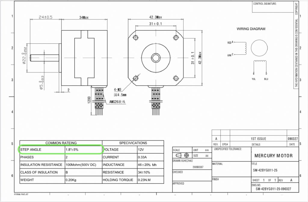

                      Just for general information : This level of positional accuracy is not unusual in mass market stepper motors, and needs to be taken into account when assessing the overall ‘measurement uncertainty’ of a stepper driven rotary table.
                      [ drawing from the SparkFun website … with my highlighting ]
                      Near enough may be Good enough … but don’t get lured into false confidence !

                        That's where the 90:1 of the table come in handy as that 1.8deg on the stepper then becomes 1' 12" at the table. That's assuming the usual direct drive to the R/t but use a 2:1 timing belt set up and it gets lower still.
                        Add in microstepping of say 2048 microsteps and you could theoretically get there.

                          dont know
                          Not quite, Jason
                          The ‘improvement’ with ratio is indeed a factor in the overall calculation [periodic error in the worm-drive may well be significant at the ‘affordable product’ level] … and, very importantly, microstepping is generally less predictable than the full-step increment.
                          Note: My comments were made in light of the ambition to resolve to ‘one second of arc’

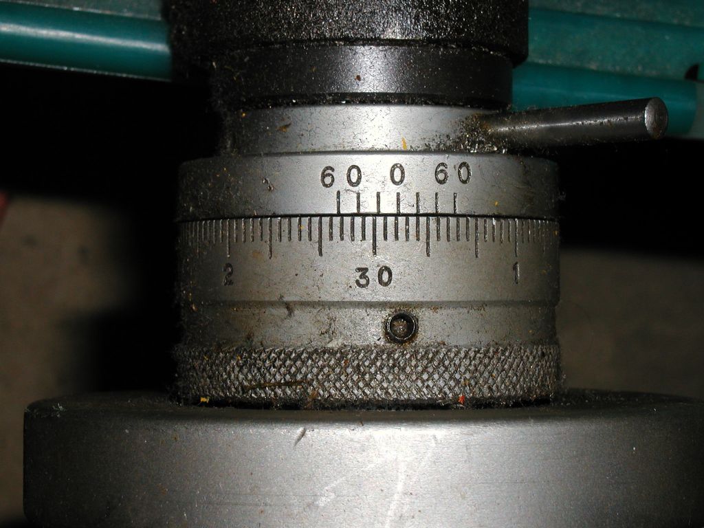

                              Posted by JasonB on 18/01/2021 17:07:14:
                              Posted by martyn nutland on 18/01/2021 12:22:05:
                              I find I can get 19 divisions (as per the originals) on the direct indexing scale of my new dividing head to about a one degree discrepancy over the 360°. Certainly good enough for this purpose. However, I did think I might be able to split that one degree inaccuracy using the minutes/seconds facility on the rotary table. It's probably possible to get a division of 19° 3', but not the seconds, because, as has been pointed out, the device is simply not sufficiently accurate for seconds. Yet, even if you achieved a segment of 19° 3' (or whatever) you would always need to fit (or make!) a dividing plate to the rotary table to proceed and index and cut all the divisions. Thus, you may as well try to do it by indirect indexing on the dividing head, using it's own plates, in the first place!
                              I'm still mot sure why you are talking about 19deg 3' as to get 19 devisions you what to move the table 18.947deg which is 18deg 56' 49" ?
                              Hi Martyn, following on from my earlier post and with ref. to JasonB's calculation above, I've taken a photo of what would represent that starting with the table set at 0/360 degrees and turning clockwise. The position shows the best achievement I could get at setting it to 18 deg 56' 50" you will see that it has just passed 2 deg 56' and that two lines on the division scale almost line up with the 60" and the 40" lines on the left hand side of 60-0-60 scale and the 3deg 6' line is in the middle of these two, but note, it's the two lines almost lining up, one on the left and the other on the right of the division scale lines, that are positioning the table. This is probably the closest you could probably get it and imagine doing this 19 times, which makes using an index plate much more convenient.
                              A photo taken more or less square on, shows neither of the two lines, line up exactly with the two other lines.
                              Regards Nick.
                              Edited By Nicholas Farr on 20/01/2021 12:23:46

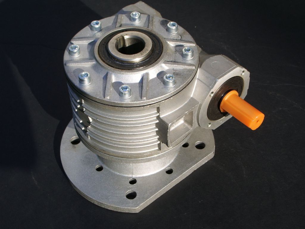

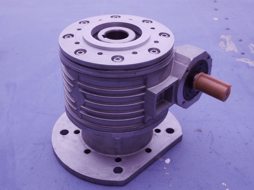

                                                Hi Nigel, I didn't say or knowingly imply the these tables are truly accurate, but I did say to the best I could achieve, meaning any short comings of the table were accepted. What I was doing is to explain to Martyn how to read what he was trying to achieve on the table he has, regardless of it's accuracy.
                                                As regards to the comment about the lines looking awful, they are not as bad as the photos make them look and are as good as many machines I've seen in industry. The lighting in the photo is only from a CFL bulb in the room light and they are distorted a little being taken as close as I could focus and there may be a slight hand shake also.
                                                As regards to my table, it is a Vertex and my index plates came from one of the Model Engineer tool suppliers and I have used them many times, although not every set of holes, but I have not had any issues of anything having any errors of any significance. Three photos below of a gearbox, which I made a new top end cap for mounting a plate for mounting a motor onto, bearing in mind that I don't like sloppy bolt holes and they were all drilled with the minimum clearance and every bolt went in without any hesitation, so unless the manufacturer has the same inaccuracy as my table, I think it is fair to say it's not that bad, but I not saying it is top end precision either.
                                                Gearbox as purchased above, new top cap below.
                                                New top cap fitted below.
                                                Regards Nick.
                                                P.S. just to add, my index plates were not manufactured by Vertex.
                                                Edited By Nicholas Farr on 20/01/2021 19:51:19
