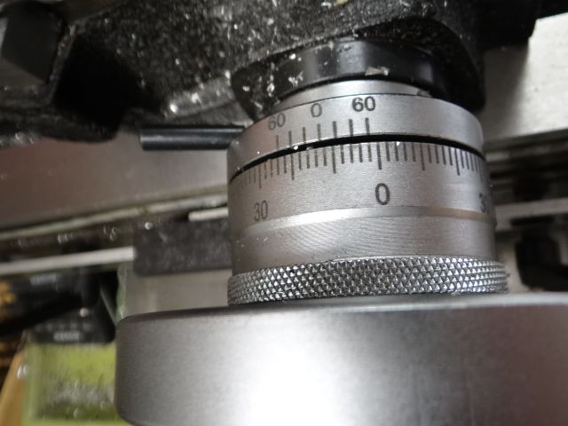

      I've got a Vertex rotary table. I think it's a V4 model. I've only ever used it to make incremental cuts (e.g. bolt circles) which is, admittedly, very easy using the main degree scale of the table and has been totally successful.
      I'd now like to move the table through minutes and seconds ( to be precise 19° 3' and 12&quot. I can't work out how to do this. Could someone please talk me through it in a Pooh-Bear-of-Little-Brain-speak?
      Apart from the main 360° scale on the table I have 120 divisions behind the hand wheel (two hours?) and then six divisions on the inner scale (tenths of one minute?). So…wind on 0-19° on the main scale…then what…?
      Also, could I ask, what is the pin/lever about an inch long that screws into the second scale ring for? All I can see that moving it ever does is reverse the direction of the table when you turn the handle (if you hold said lever it over!)
      Sorry to be so basic. But guidance would be much appreciated and, as always, thanks in advance.

          Seconds of arc may be beyond the capabilities of your table, my 6" Soba only goes to the nearest minute.

            I think you will find the table has a 90:1 worm so each turn of the handle moves the table 4 degrees. The hand wheel is marked 0,1,2,3 to give you the intervening degrees. Between the degree marks are thirty divisions with the middle marked 30. Each of these divisions is two minutes. You might be able to get to the nearest minute but I doubt you could accurately set to seconds.

                  Posted by martyn nutland on 17/01/2021 14:58:55:
                  There is a manual describing the parts here:
                  https://www.t4i.com.au/R005
                  As that is an Australian version, the table might go in the opposite direction when you rotate the handle.
                  As others have said, it has a 90:1 worm ratio. Hence, one turn of the 120-division wheel moves it 4 degrees.
                  At this point, your description and the manual linked to diverge as it claims the micro collar resolves to 1 minute, which implies 240 divisions.
                  In any case, if your inner scale has six divisions, it will not be tenths of anything, but sixths, more specifically sixths of whatever one division of the outer scale represents.
                  Mr not done it yet's post contains some serious typos, so should be read with caution. To correct it, substitute 'diameter' for the first mention of 'circumference' and '12 seconds' for '12 minutes'.

                      Is your table a HV4 or RT4?
                      What does the Manual say about these things?
                      Not much if it is like the one for my HV6! Seems more concerned with fitting and using the Division Plates.
                      The following comments are based on my knowledge of the HV6, and the assumption that your 4" table is a scaled down version. So it should be a 90:1 ratio. (90 turns of the handwheel for one complete turn of the table ).
                      So one turn of the Handwheel will rotate the Table by 4 degrees.
                      I am too idle to go out into the workshop to get out the HV6 and check, so am relying on memory! And it is a LONG time since I partially stripped one to adjust.
                      The units on the main scale, on the Rotating part of the Table are Degrees, the graduations on the Handwheel and the Vernier allow you to work to fractions of a Degree, Minutes of a Degree, and then,hopefully, to 1/60 of that, namely Seconds of a Degree, AT THE Table…
                      Most probably, the divisions on the Handwheel will be Degrees, and the divisions on the other scale will be a vernier, allowing you to work to Minutes of a Degree.
                      If you check, you will find that the six divisions on the vernier scale do not correspond exactly to those on the handwheel. Probably coinciding at the zero and fifth divisions on the handwheel. This is deliberate, to produce the vernier effect, so that moving the handwheel so the coincidence changes from the zero to the first graduation on the vernier needs only a tiny rotation of the handwheel.
                      If there are 120 divisions on the Handwheel, each graduation probably represents 3 degrees ON THE HANDWHEEL, or 0.0333333 degrees, or 2 minutes, OF THE TABLE.
                      Using the vernier scale, it is possible to rotate the Handwheel by a lesser amount and so obtain an ever smaller incremental movement of the table.
                      At an unchecked guess, (Which someone is likely to correct ) this movement of one division on the vernier scale will represent 3/6 degrees or 30 minutes of Handwheel rotation producing 0.33333 Minutes or 20 Seconds of TABLE rotation. Hence my being pessimistic over being able to obtain your final 12 seconds
                      You are looking for a HANDWHEEL rotation of 4.770833 turns to obtain 19.083333 Degrees of the table. This is dividing a circle into almost 19 divisions, but not quite, (18.864629 divisions ).
                      BUT, if it needs to be said, the backlash MUST be taken out., so I would recommend setting the table locks to drag slightly, and ALWAYS to rotate the handwheel in the same direction.
                      I would be surprised if the lever to which you refer reverses the direction of rotation. There may well be such a provision, but I have never heard of it. It would be more like;y to allow the worm to be moved in and out bof mesh with the wormwheel.
                      .This achieved by rotating the eccentric sleeve which carries the worm shaft. The position of this sleeve is locked by a small handle in the base of the table, just by the handwheel, behind the vernier scale. .
                      If the "Second scale ring" is on the Hnadwheel, this may be to allow the handwheel to be moved relative to the wormshaft so that the scale can be zeroed against the Vernier scale, before commencing rotation of the table
                      All these assume that the worm and wheel ARE accurate. (There have been posts on here of a table supposedly having a 48:1 ratio being found to have a 47 tooth wormwheel! )
                      You quote figures requiring a high degree of accuracy, (Possibly higher than the table can deliver ) so check everything!
                      HTH

                        Sounds like mine, which is as described by Roger.
                        The pin, shown disengaged, turns the inner scale to engage the worm to drive the table. Mine doesn't do reverse. The T handled nut behind locks the worm in or out of position. Undo it to move the inner scale and re-lock at each end.
                        Before turning the inner-scale with the pin also make sure the table's locking clamps are undone. Being relatively crudely made, the worm doesn't always mesh properly and it helps to turn the hand-wheel and pin together in the same direction. On my table the pin ends up on the left side with the inner-scale central on top.
                        As Roger says, each turn of the outer scale is 4°, and it is graduated in steps of 2 minutes. The inner-scale is a vernier going down to a third of a minute (20 seconds). Actually, mine isn't that trustworthy – I wouldn't claim better than half a minute, and that's optimistic! Assuming I've read it right, the dial above is set to about 13½ minutes past 0°.
                        Having zeroed the table, 19°3'12" is 4 full turns of the handwheel to get 16°, plus ¾ turn to get to 19°, plus 3 and a smidge small graduations past the centre line on the inner scale.
                        I guess Martin isn't making a gear because 360 / 19°3'12" isn't a whole number, but say he was after a 19 toothed gear. Keeping track of multiples of 18° 56' 51" is such a right royal pain that a dividing wheel attachment is available to help.

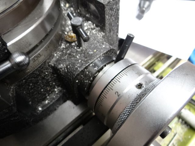

                                Hi, my 6" Vertex is the same as SOD's and like he says, has a resolution of 20 seconds at best, using the vernier scale, which is the 60-0-60 scale.
                                Vertex HV6  RT
                                Which is reading 1 degree 25 minuets and 20 seconds, with the table turning clockwise.
                                Regards Nick.
