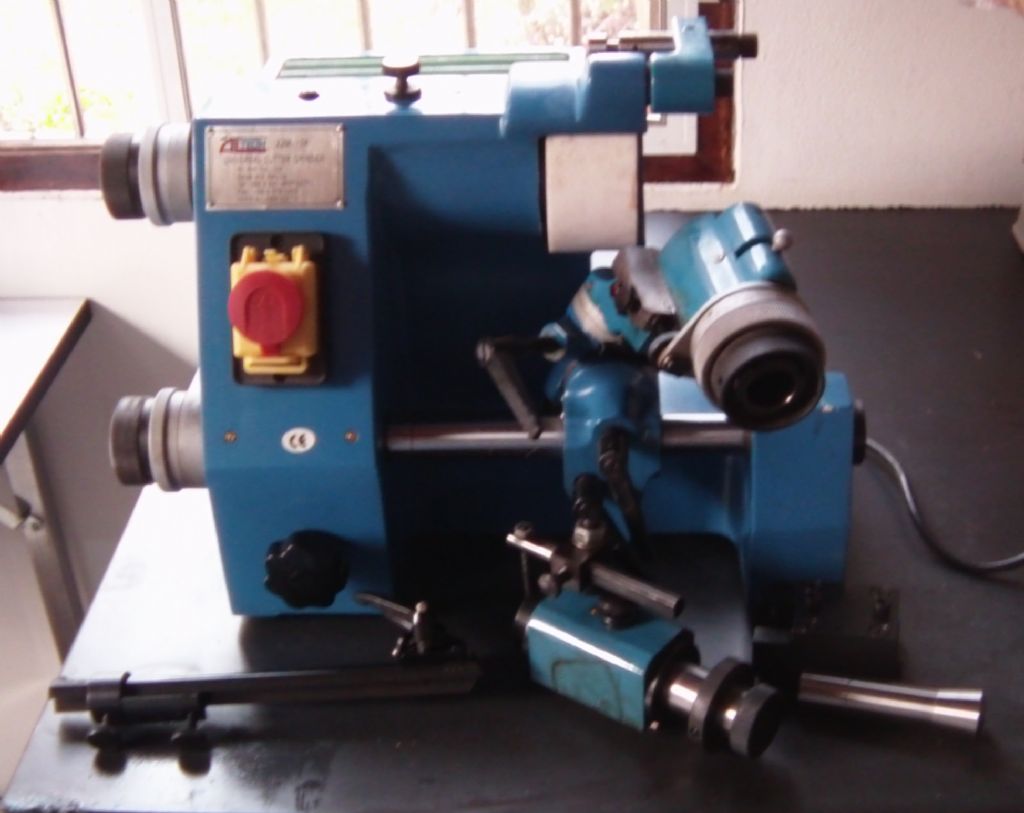

                                  Wow! I wish I had read this before I bought my 'Tool And Cutter Grinder' in Bangkok, Thailand. I probably wouldn't have bought it.
                                  In Thailand you can't simply buy another drill or end mill when one goes blunt. As a Brit retiree in Thailand my strategy to save on the cost (and difficulty) of renewing blunt cutters was this tool and cutter grinder.
                                  It came with the three main accessories, Drill Sharpener, End Mill Attachment and Lathe Tool Attachment. (Shown in front left to right)
                                  The collets are labeled R8.
                                  The machine is well built and very heavy. There was no manual with it.
                                  As to what all the handles do I have no idea.
                                  As I get it to do some useful functions I'll post the details including photos and videos on my ModelEngineeringInThailand.com website on the Buying And Using A Tool And Cutter Grinder In Thailand Page.

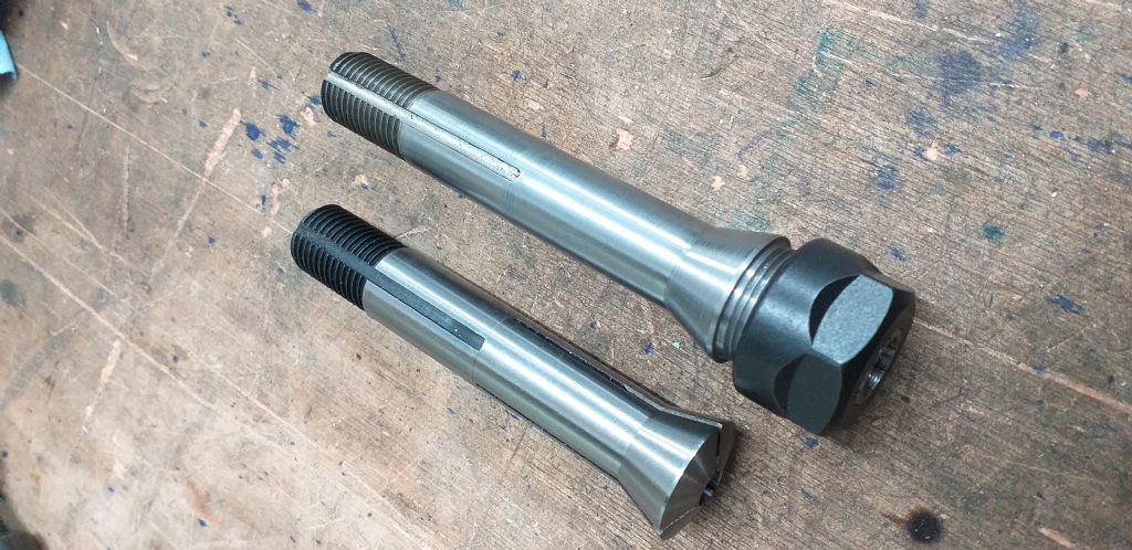

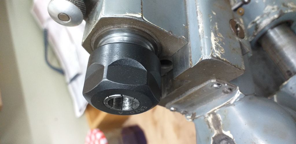

                                        I thought the U2 collets were very expensive in the UK at £20 each so I bought a cheapish set of ER collets from Arc and made a U2 to ER holder. It took longer to work out fitting the ER taper into the U2 taper than it did to make. The buttress thread was cut just like any other with the tool ground on the bench grinder. I am pleased with the result and the drills cut really well.
