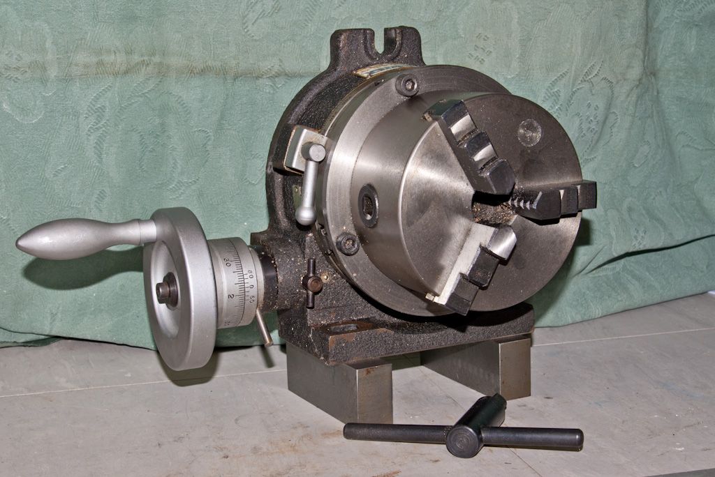

                It is the 6″ version and, as you will see, I have mounted a 5″ 3-jaw chuck to a plain steel backplate and fixed it via some T nuts to the table. This is how it lives most of the time. If I need to mount a component directly to the table it is quick to remove the chuck which can then be fairly accurately re- centred when refitting by putting a No 2MT blank end arbour in the center socket of the table and nipping the jaws onto it. ( Further precision can of course be achieved with your dial guage!)

                  I bought a 3 jaw 100mm self centering surface mount chuck and this bolts directly onto the table via the T slots. This is quickly centered using an MT2 taper bar and nipping up the jaws to grip and then the mounting bolts can be snugged up. If greater accuracy is needed then 4 jaw and dial gauge would be appropriate, see Norman’s post above.
