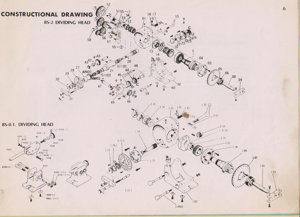

      I have acquired a Warco-badged Vertex BS-0 Dividing-head in immaculate condition, probably unused by its previous owner, a fellow club-member, before he passed away.
      It came with tailstock but no chuck (not a problem as Myford chucks fit), T-slot tenons or instructions.
      What I think is meant to be the official manual, on-line, is a pdf image of hopeless image quality, impossible to down-load, with illegible parts-diagrams and lacking key operating details. The text mentions parts that seem not to exist, at least not on this model.
      So, now I want to use the thing…. Help please, on its basic use.
      I have found so far…
      Changing the division plates – I worked that out by careful experimenting. I probably have generic instructions on using dividing-heads, but the pdf is short on identifying this one's individual controls.
      Of two levers on the side, one controls the the indexing-pin for direct indexing; the other, unidentifiable on the document, may operate the spindle lock.
      The text gives vague information on taking up backlash in the worm, from wear, but the photos are uselessly fuzzy.
      For direct indexing it instructs ' swing the worm out of engagement ', but not how! Removing the division-plate reveals a bronze disc with two cap-screws working through curved slots. The purpose is not clear and the screws are so tight I stopped, fearing damaging the tools or worse, the unit.
      For " Indirect indexing " (I.e. actual dividing) it tells you to ' swivel the worm carefully to the stop by means of the swivel lever, at the same time turning slightly the indexing spindle then the hand crank… Operate clamping device for hole plate.'
      Which ' stop ', ' swivel lever ' and ' clamping device for [which] hole plate ' ? Note that fitting the dividing-plate covers the slotted bronze disc and its screws. The rest of the instructions for this section are just as baffling, and the diagrams are barely readable.
      So I will be very grateful if someone can elucidate, please!

          There is a lever on the side that engages or disengages the worm. The other lever normally is the index pin engagement or disengages the quick select on the index plates, or is the spindle lock.

              The other lever on the side is as you thought the spindle lock.
              The bronze piece with the curved slots is how you would adjust the backlash and take the worm out of engagement. For direct indexing I find it easier to leave the worm in engagement, and just wind the handle until the pin will engage in the hole.
              I think the part about indirect indexing is just telling you to get the worm engaged with the worm wheel, you would do this before putting on the dividing plate. The main thing is to have the worm engaged well enough to not have too much backlash, but not so tight that it starts to bind. The two screws in the curved slots should be allan screws, and should not need to be done up excessively tight.

                    I've got the same dividing head, and can confirm that there are indeed two levers at the back face. The top one operates a spindle locking pin which engages with the circle of holes in the face plate, exactly as described above.
                    The second lower lever screws in until it is tight, by which time it has locked the spindle solid.
                    To the best of my knowledge (though you've got me wondering now) there is no mechanism for taking the worm out of mesh with the pinion.
                    HTH Simon

                      Well, I did think of editing my previous post so I could deny I ever made a fool of myself, but no-one would be convinced.
                      So my apologies for misinformation, but having just had a play in my (cold and damp) shed I can confirm that there is indeed a slotted plate behind the dividing plate, which, after loosening two cap head screws, permits the worm to be disengaged from the pinion.
                      It's a bit of a fiddle to set it back where it belongs with minimum backlash, but it does exist.

                          I cleaned and lubricated the slotted disc that had been puzzling me, and found that indeed it does disengage the worm from its wheel.
                          The main spindle is a bit stiff and "lumpy" to turn, which is probably a result of it standing idle for a long time.
                          So that's the first question sorted. I can now use the head for direct indexing. What of full dividing?
