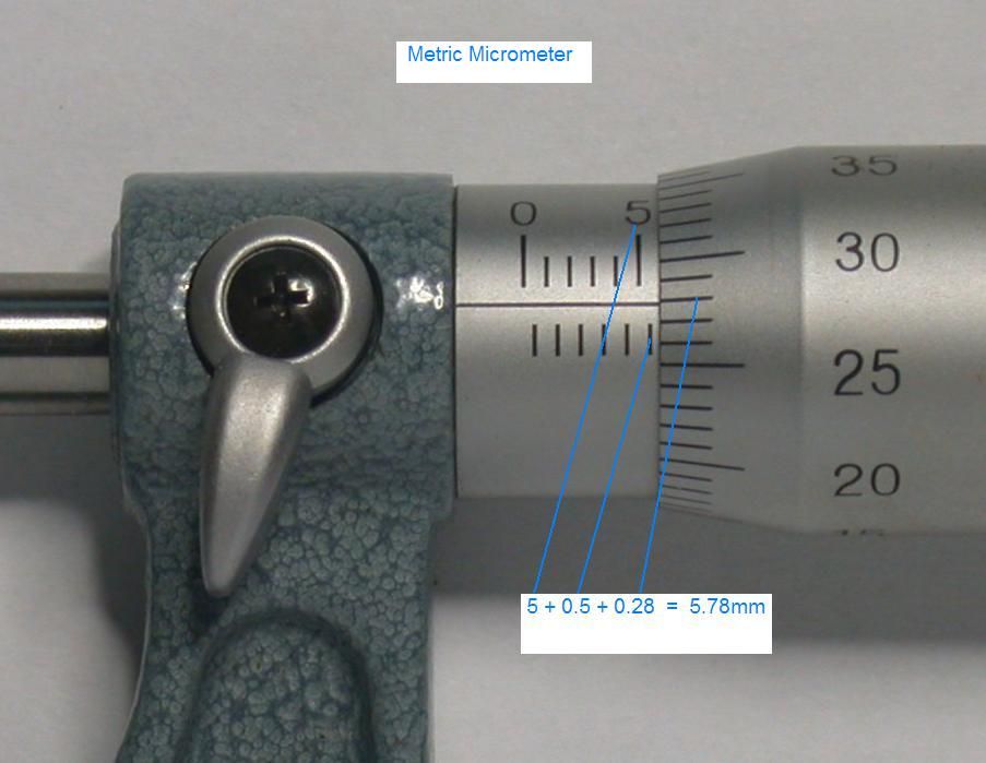

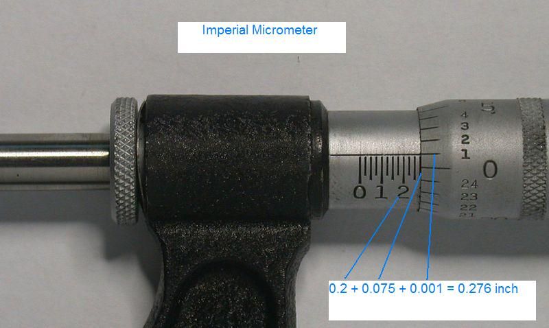

                                        Posted by Wolfie on 26/01/2012 22:06:50:
                                        OK so you have convinced me its worth getting out the drawer and de rusting it. Its probably been at the back end of the cow barn since 1875.
                                        Well OK its not rusted to death but its a bit stiff.
                                        So whos gonna tell me how to use it?
                                        Edited By Wolfie on 26/01/2012 22:07:25
                                        Hi Wolfie,
                                        Perhaps this may help. How to read imperial and metric micrometers. Click on pictures to enlarge.
                                        Imperial
                                        0.2 + 0.075 + 0.001 = 0.276″
                                        Metric
                                        5 + 0.5 + 0.28 = 5.78 mm
                                        Best regards
                                        Terry
                                        Edited By Terryd on 27/01/2012 05:34:32
