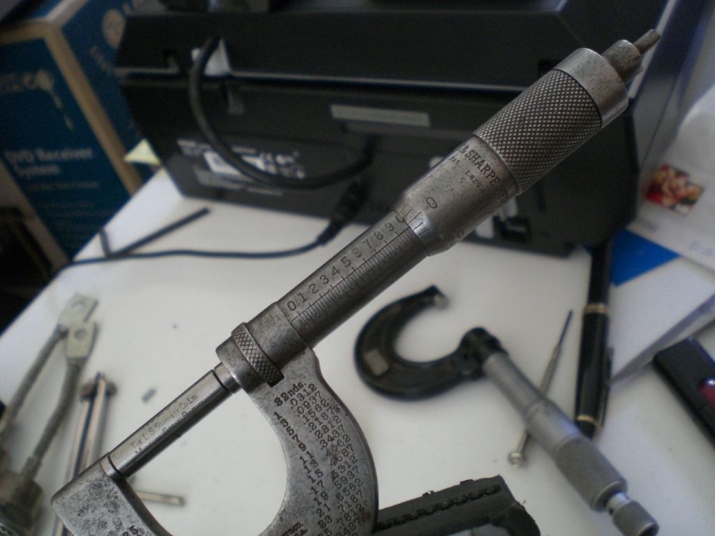

      Hi Jesse, not all micrometers can be totally adjusted to read zero. Below is a photo of the only micrometer that my late farther had and could ever afford, it is a Brown & Sharp 0-1" and has a fixed zero line on the inner sleeve. It was second hand when he bought it before I was born and I have never known it having a ratchet which is missing, it also reads approximately 0.0005" above the zero line and always has as far as I know. Maybe it was a marriage between two damaged identical mics. I just don't know, but it is shown here just holding a No. 234 1" L.S. Starrett standard and when it is closed it reads above the zero line by the same amount.
      There are more photos in this **LINK** of other mics I have holding the same standard by using the ratchet as described in the Mitutoyo instructions scanned with the calibration certificate for my 0-50mm Mitutoyo mic. There is also a photo just and only just holding the same standard in my inexpensive Vernier calipers and one of my cheap digital calipers, the digital one could not make it's mine up as to whether it is 1" or 0.9995" the photo caught it as the latter.
      All the results came out good enough spot on for me and as I keep all of these in the house, they are all at near as dam! is to swearing, the same temperature.
      Regards Nick.
