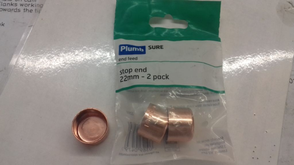

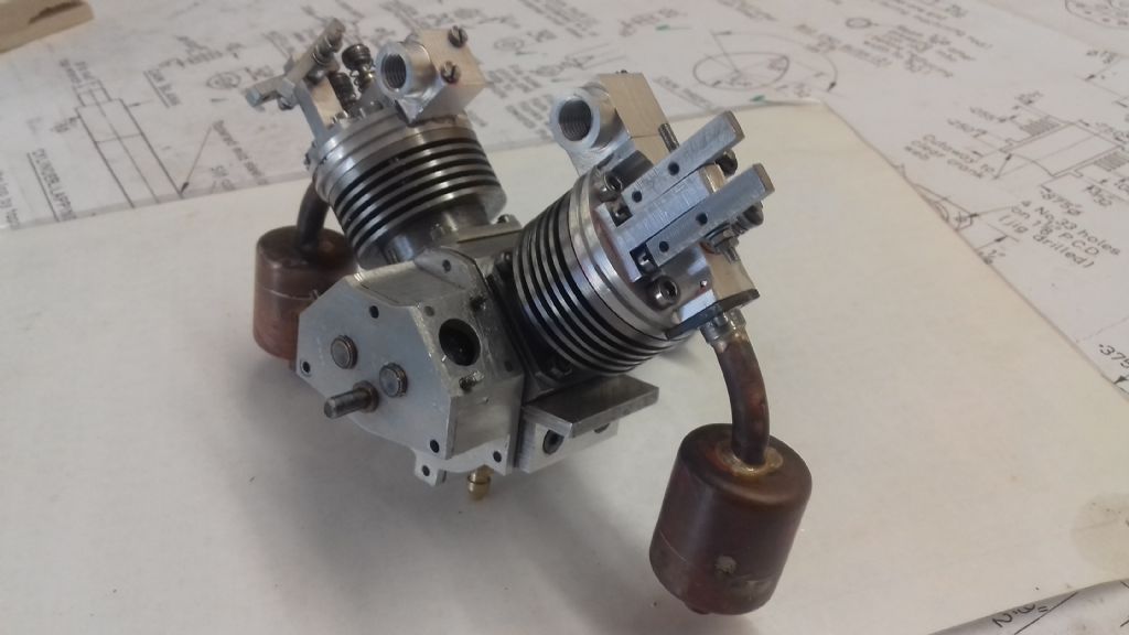

                    20210620_095613.jpg20210620_095538.jpgHi Guys, Thought I would post a few photos of the Vega progress. I struggled with making the exhausts so trip to B&Q and a visit to the plumbing section got me a couple of these 22mm copper end caps. I took each cap and drilled the 1/4" holes either end. I then cut one cap down to give me the required length as per the plan. I joined the halves together using a nut and bolt and silver solder together. Not as elegant perhaps but maybe a wee pollish will help.20210620_095503.jpg

                        Engine is looking good, a bit of black BBQ paint is another option for exhausts and silencers.
                        #550570
                        Alan Gordon 4
                          @alangordon4
                          Hi Jason,
                          Thought about that, but on the assumption that it will run !!!!! I was concerned that the paint would peel off due to heat,
                          However I was thinking about using a car / motorcycle exhaust paint which I assume would be more resistant,
                          If anyone has other alternative ideas ?
                          #550576
                          Emgee
                            @emgee
                            Nickel or chrome plating may look good but I would just use some black heat resistant paint.
                            Emgee
                            #550579
                              The BBQ paint is heat resistant. I use a stove paint and have not had problems with that coming off exhausts

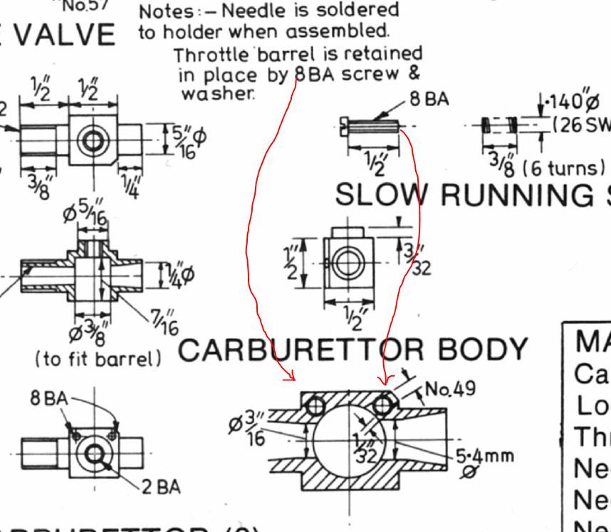

                                Good morning everyone,
                                Well, here I go again.
                                This I hope is the last query I have with regards the plan ? The plan shows each carb body having two 8ba holes drilled, again I cannot see what they are for, and like the mountings plates previous any advice would be gratefully received. I will post pics soon of the carb build if of interest. Thank you all in anticipation.
                                Got the stove paint Jason, thanks,
                                #553490
                                  One hole takes the slow running screw and adjusts how much of the air bleed hole is uncovered.
                                  The other takes the screw and washer to retain the barrel

                                    Ah, I see Jason, you know I looked at this and had brain fog, it's an age thing.
