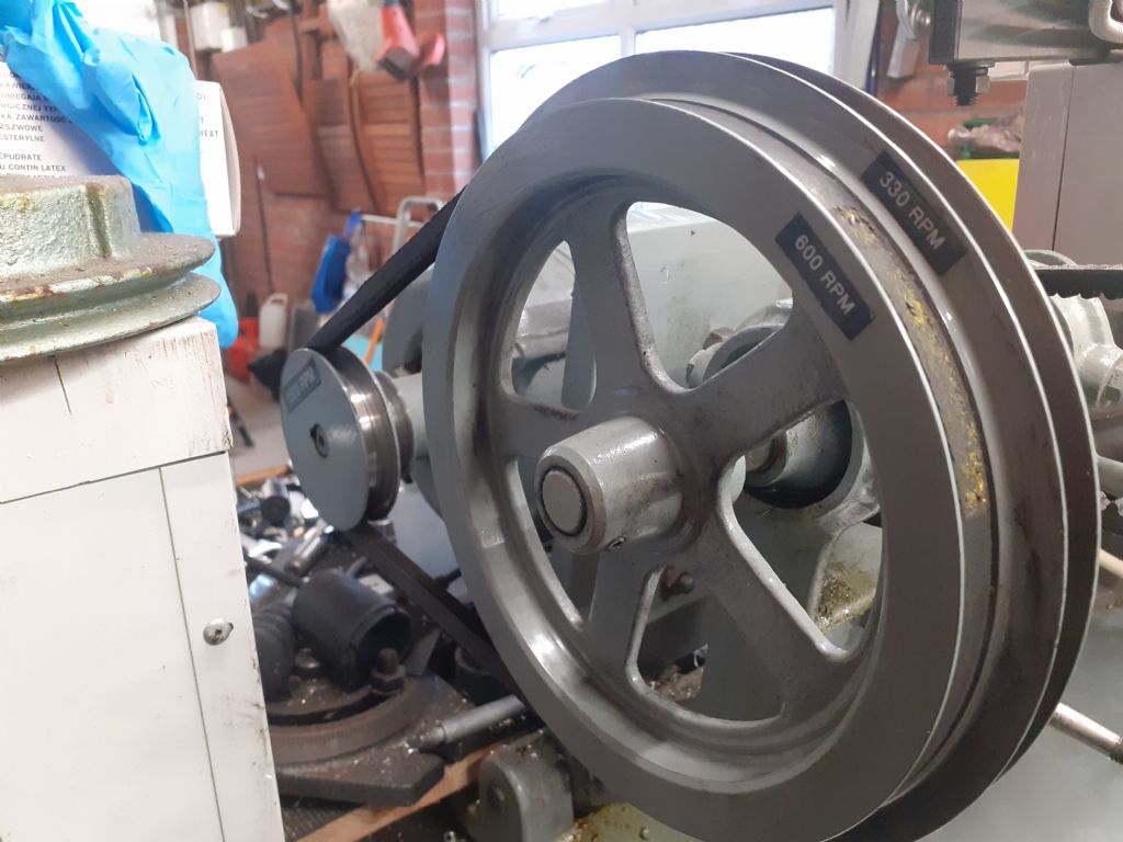

                                                David George 1
                                                  @davidgeorge1
                                                  Hi have you thought of just turning your own. I needed a new double pully for the motor on my M Type so just looked up dimensions on the web, made a V shaped form tool and turned it with correct bore for motor and correct pully sizes.
                                                  The small double one on motor.

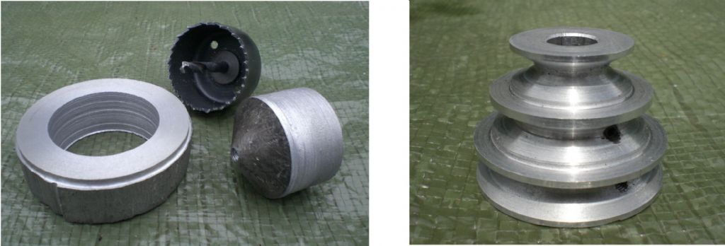

                                                  Nicholas Farr
                                                    @nicholasfarr14254
                                                    Hi, I made one from a piece cut out from an old lorry engine piston, it is a three step one, the largest being 44mm diameter and the smallest being 30mm and the overall length is 34mm. The vee's in my case though. didn't have to be absolutely critical, as they drive a round belt on an old Bonds Maximus Drill. It's held onto a 10mm motor shaft, with a small grub screw in the large and middle Vee, and has never come loose. Like Dave, I used a form tool to cut the Vees.
                                                    Regards Nick.
