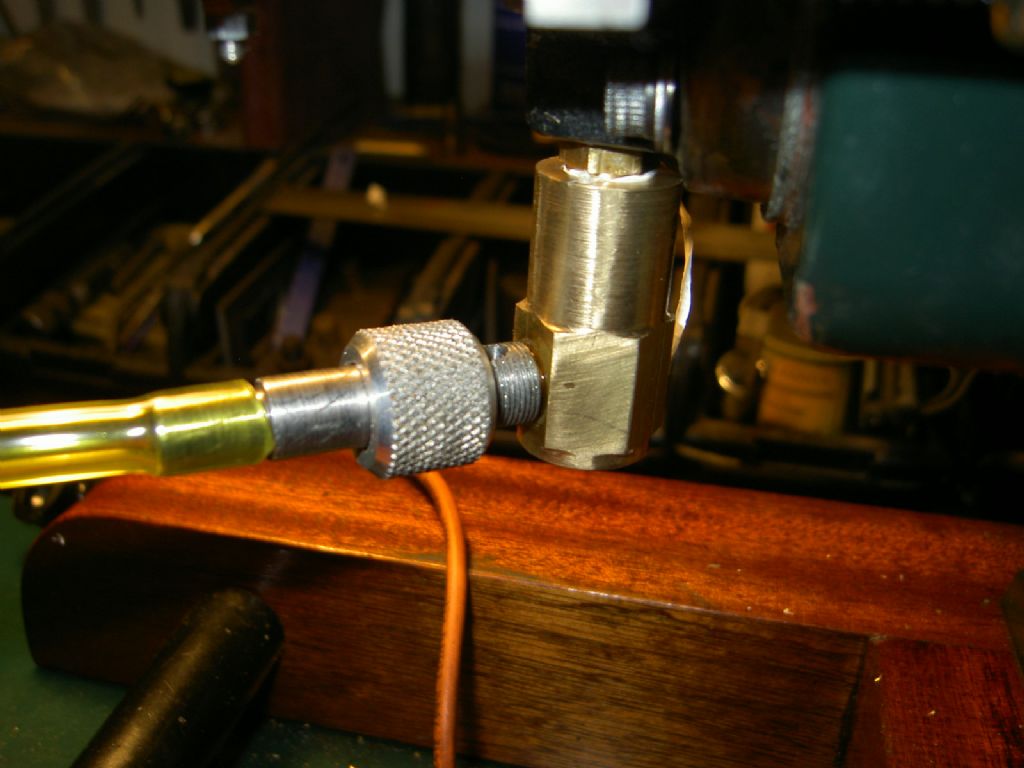

        What risk of flash back explosion might exist by adopting a glass jar petrol vapour carburetor? The engine in question is 1 inch bore, 4 stroke, with Hall effect ignition operated at crank speed. Petrol vapor will be drawn to the air inlet of a Nemett designed barrel throttle carb through a clear plastic tube. Of concern is possible leaky valves, valve overlap period, valve timing events in general, and also the extra spark in the valve overlap period. Thanks in advance for any comments. Patrick Cubbon

                            Hi Howard – Yes, I have a copper tank that could be used though I like to see what is going on with petrol levels. Wished to add a picture of the problem engine for general inteterest but did not succeed. I see MichaelR managed with his photo.

                                        Problem engine, thanks JasonB for photo guide input, quite a bit of time for the result to appear.
                                        David standing – canon/cannon that really provoked more than a smile a real laugh!
                                        Will be pressing on with a vapour bottle, the photo shows petrol supply to a Nemett carb. on the other side.

                                                Hi Howard, Felt pad above petrol – thanks for a good suggestion. First rushed attempt with surface carb was not a success. Vibration resulted in a haze of petrol droplets from the exhaust. Blutac, to secure plastic pipe into tapered mouth of emett carb, does not take kindly to petrol! Next step is to be more professional with a remote petrol container and plastic feed pipe directly into inlet port via a proper adaptor. Still to be done is to position the spark plug gap within the combustion space. The engine has a reprieve from under the bench for now!!

                                                    Just to close this forum thread. Re positioning spark plug made no difference. Engine remains a non runner. Problem is LEAKY inlet and exhaust valves with little compression. New valves, re-machined seats, and better cams needed. The challenge presented with this engine was to complete the build and then see if it was a runner. The engine moves to display only! Now it is a return to steam – a single cylinder version of Bertinat's Borderer ME 1989 issue 3862. A year has passed playing about with this engine and an enjoyable time spent in the workshop.
