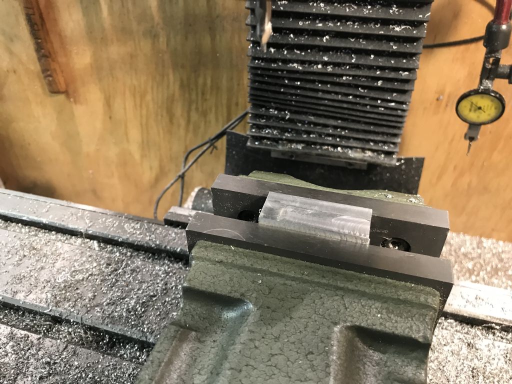

      It's coming along nicely Craig and just goes to show you can hold milling cutters in a drill chuckdevil
      Ignorance is bliss. I guess as a newbie I can get away with it..wink
      I presume now that you've hinted that the milling bit should be held in a collet instead for better accurancy?
      #424782
        It is not just accuracy, the main reason is that a drill chuck does not hold the cutter very securely particularly when side load is applied and there is a risk of it moving. If you are lucky it will just ride up and not cut but due to the angle of the helix that the flutes follow the cutter is being pulled down when cutting, it would be a shame if this happened to a part that you had previously put a lot of work into.
        I think we have all done it to start with or for the odd little cut where it's a faff to change from chuck to collet, (well at least I have) but would be worth investing in a collet chuck such as ER25 or 32 depending on what machine you have.

          Posted by JasonB on 18/08/2019 06:53:34:
          J
          Thanks for the info Jason, that's something new i've learnt.
          I do have a collet set that i use for the larger (16mm bit), but will look to use them for the smaller also.

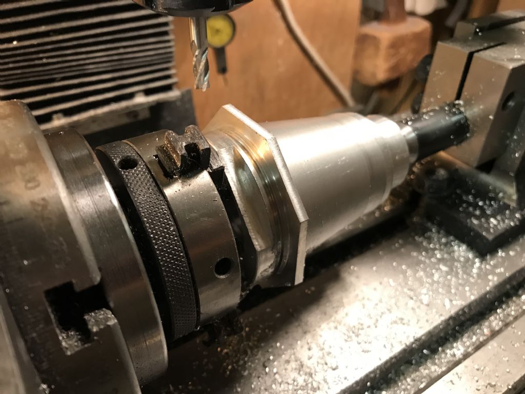

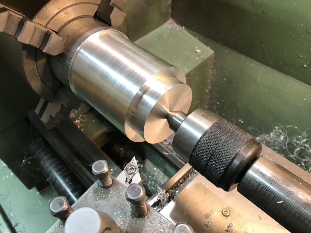

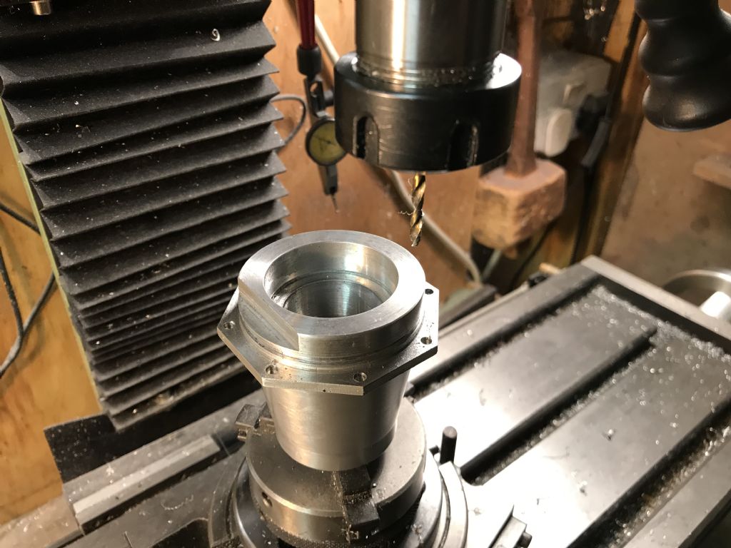

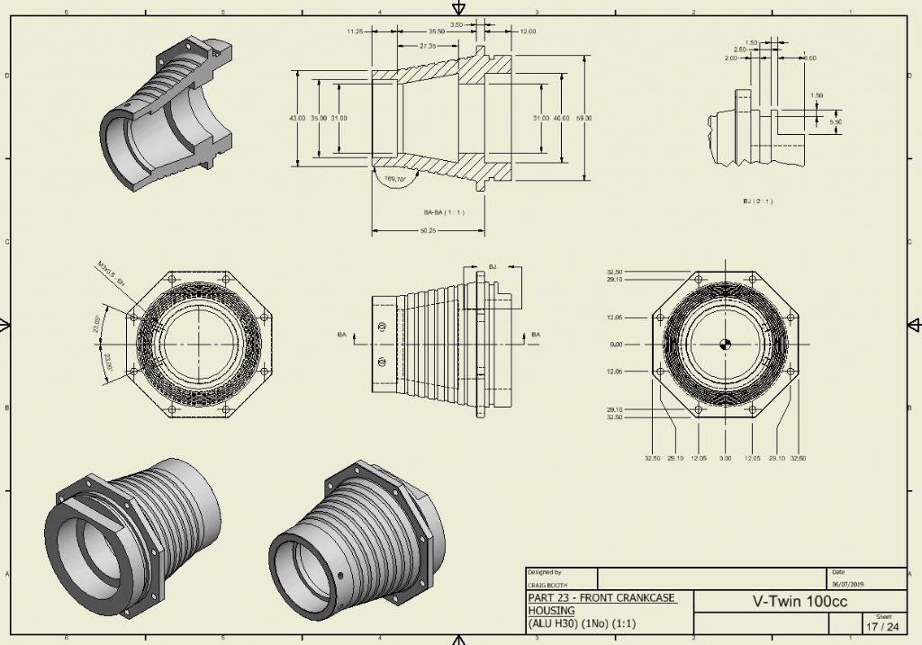

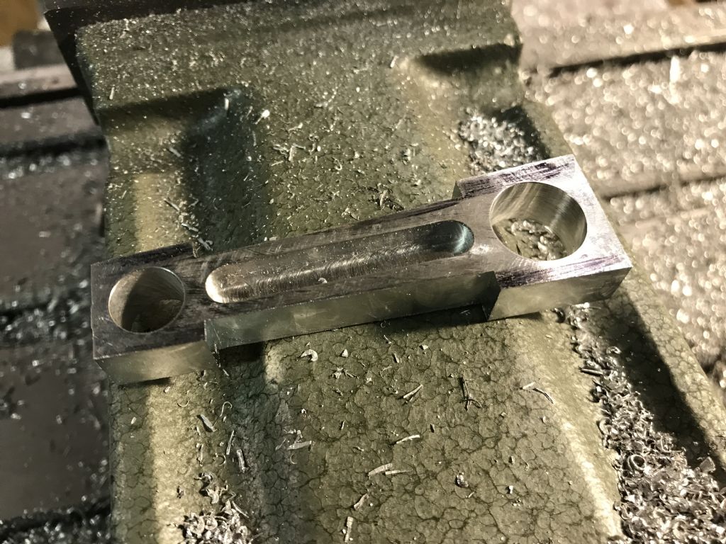

              #439555
              Craig Booth 1
                @craigbooth1

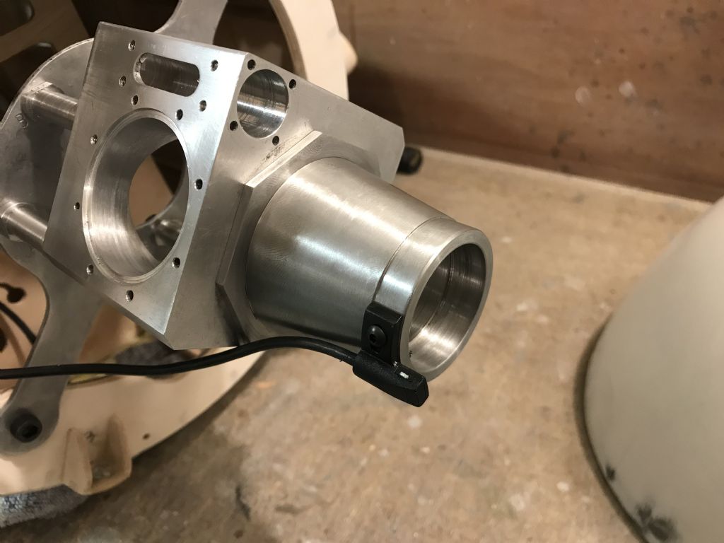

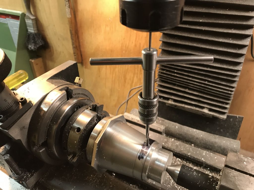

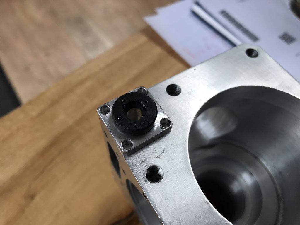

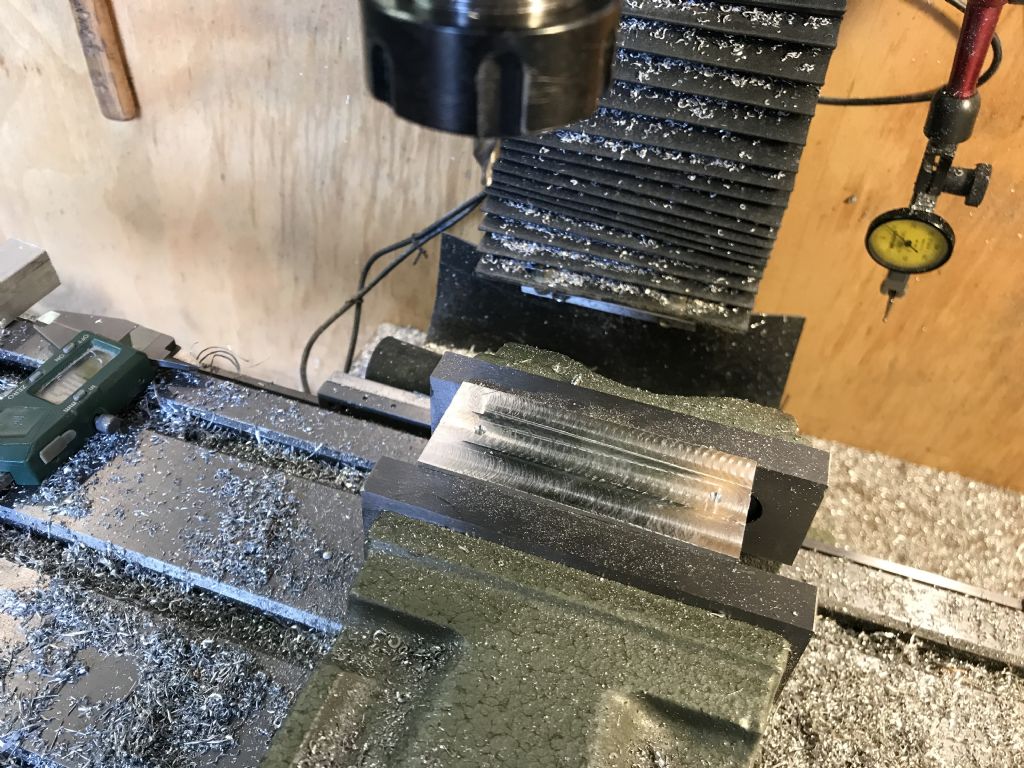

                Hi all, well its been a few months and I been concentrating on the plane rather than the engine, but now that winters here starting to get back into it.
                Finished off one of the rocker supports.
                and then started on the front crankcase housing.
                lump of aluminium turned and bored to shape. Main bearing will be a press fit, front bearing a push fit.
                on the vertical rotary table on the mill I cut clearance for the valve sleeve and octagonal face plate.
                and drilled and tapped holes for the magnet sensor
                drilled the holes for fixing

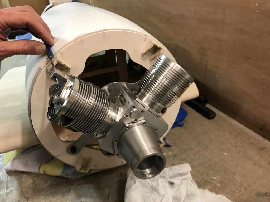

                  and I couldn't resist putting it together and seeing what it looked like on the plane laugh

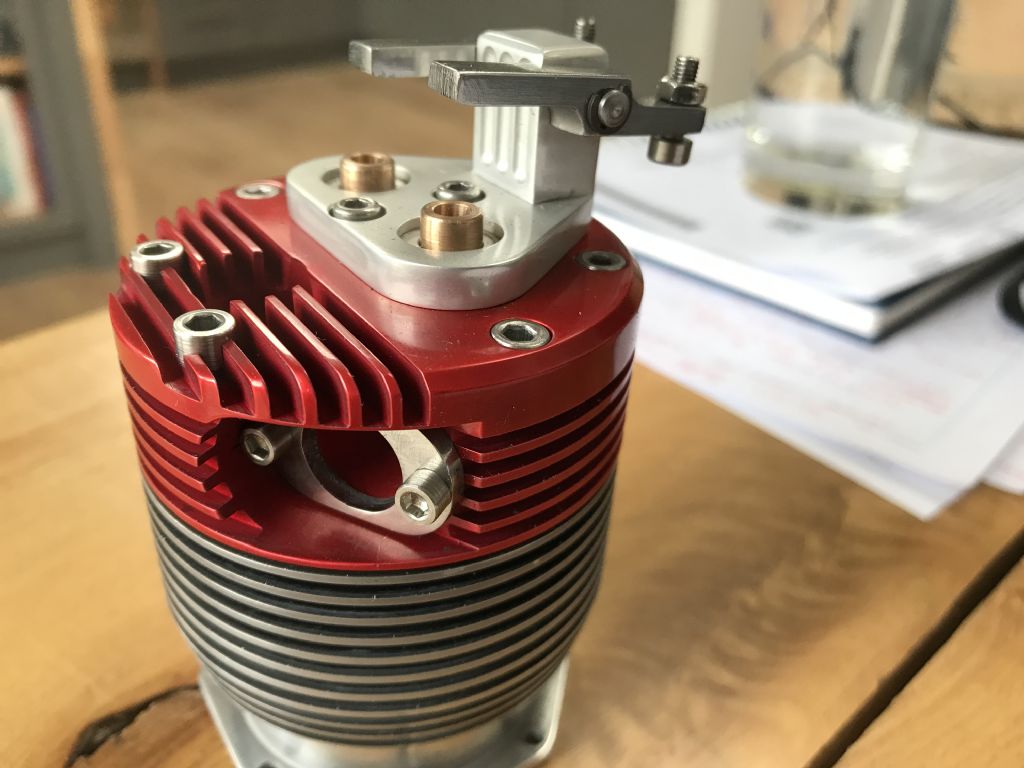

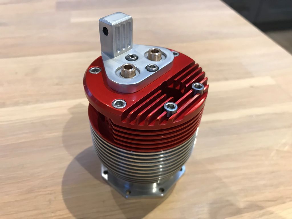

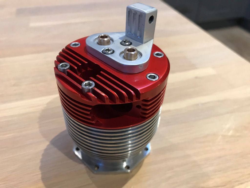

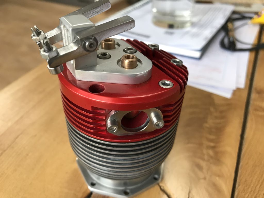

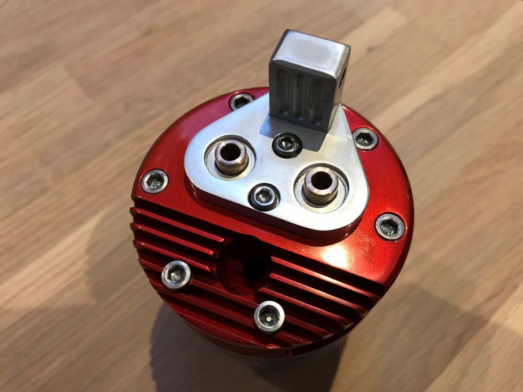

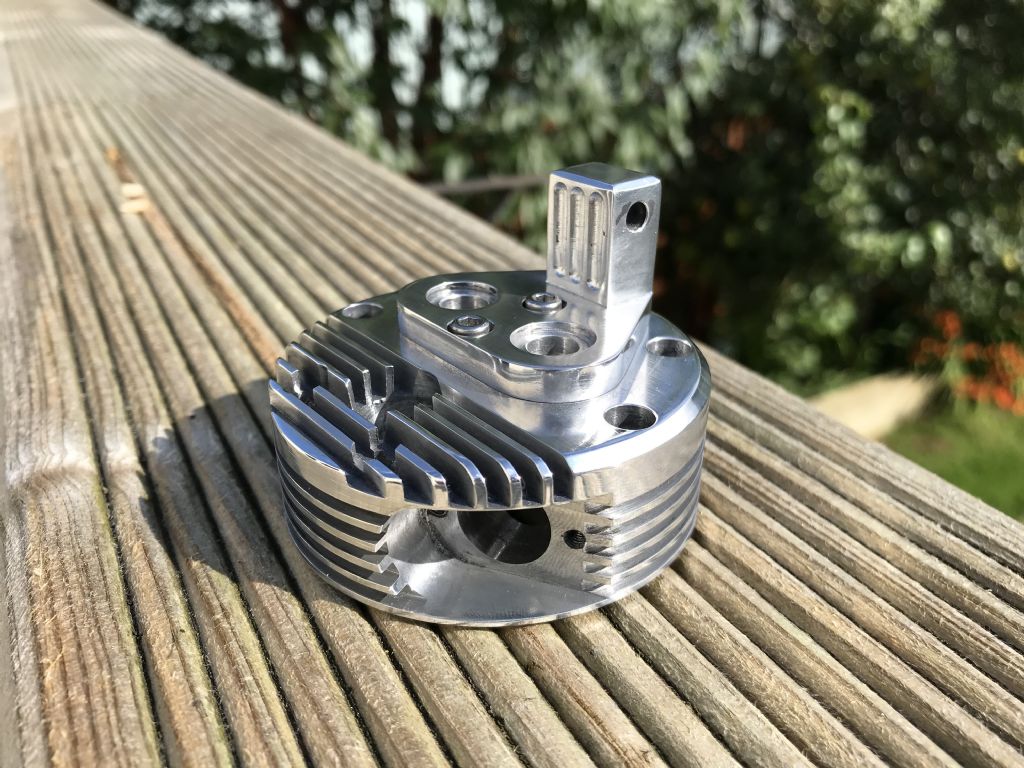

                    Today I anodized the cylinder head and made the valves sleeves from Colphos. Pretty happy with the results.

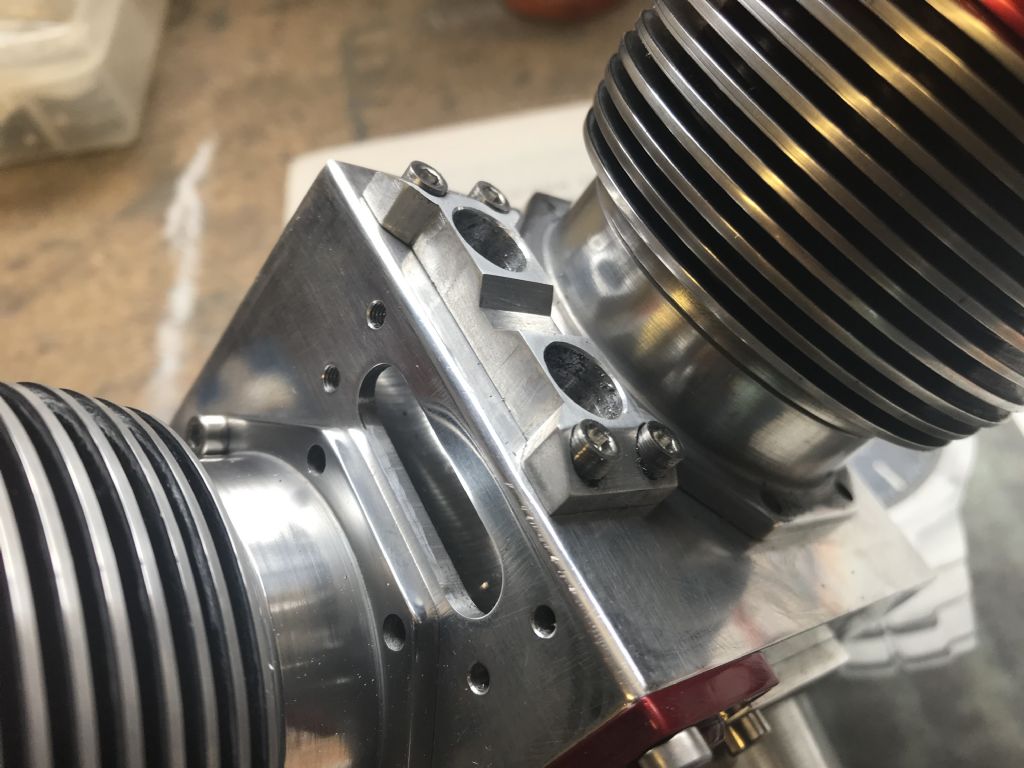

                      #463401
                      Craig Booth 1
                        @craigbooth1

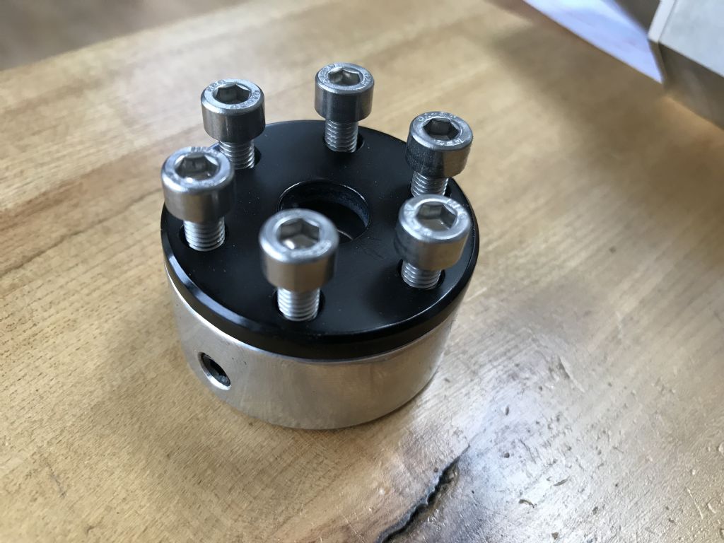

                        The last couple of days has been work on the tappet guides and sleeves. I had to redesign these as I made an error in making the space available for the cam lobes to small a diameter. This has meant that I have needed to make the tappets much larger diameter 8mm diameter to meet the minimum calculated in the "cam with draw" spreadsheet I have been using. The main guides from aluminium H30 and the sleeves Colphos. Guides then anodised.

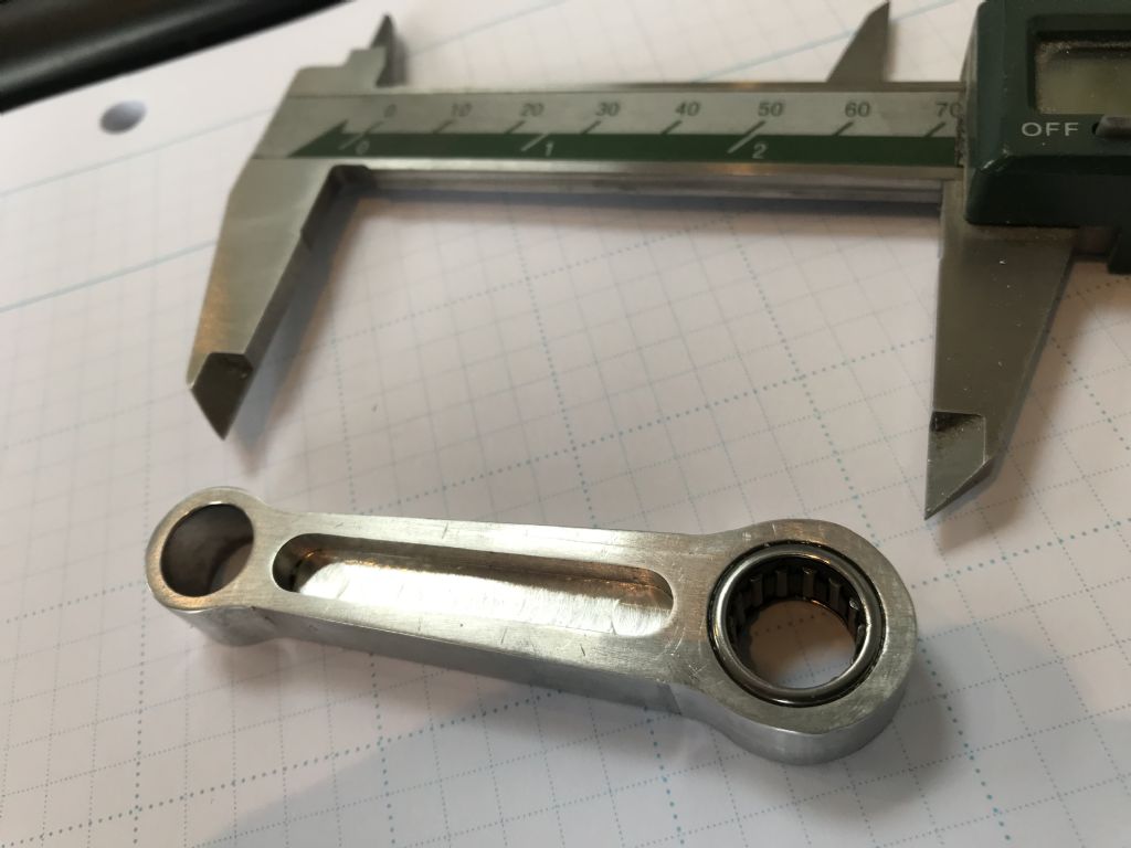

                          also made start on the first conrod (alu H15), with a needle bearing on big end. Small end will have a colphos bushing.

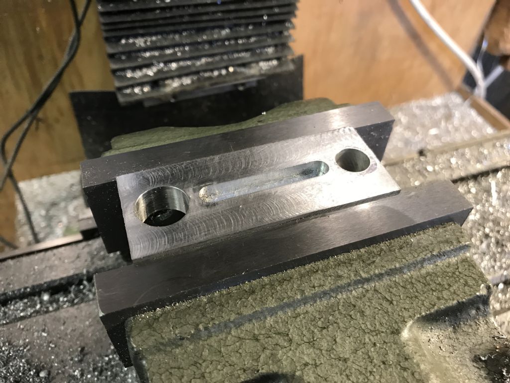

                            Today was a mix of things. Finished off 2 of the rockers in Silversteel, later to be hardened, rocker pin also from silver steel with circlips.
                            Made 2 of the port plates from stainless steel. I'll be silver soldering a sleeve onto these which will project into the port with an O-ring for sealing and will also allow the tubing to be soldered on.

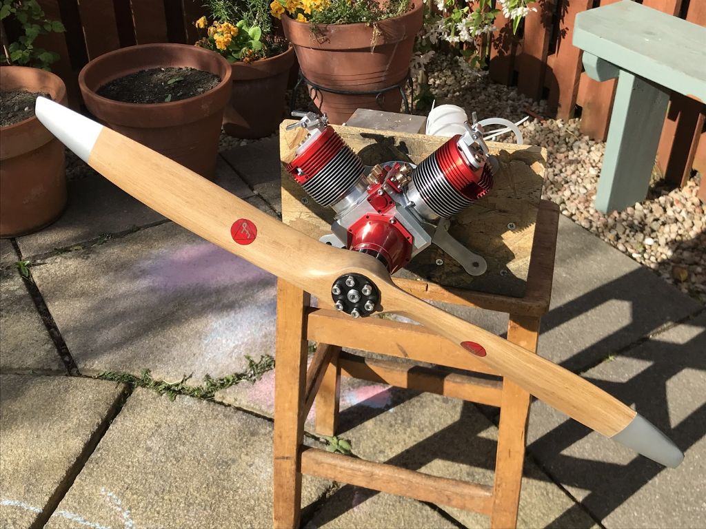

                            Emgee
                              @emgee
                              For some reason Craig stopped posting here on his build but the engine is now completed and has been test run.
                              See it at this link **LINK**
                              Sounds good and seems powerful by the stats provided.

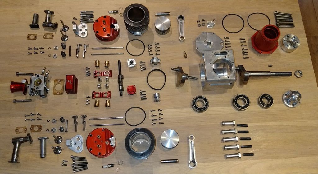

                                  Craig Booth 1
                                    @craigbooth1

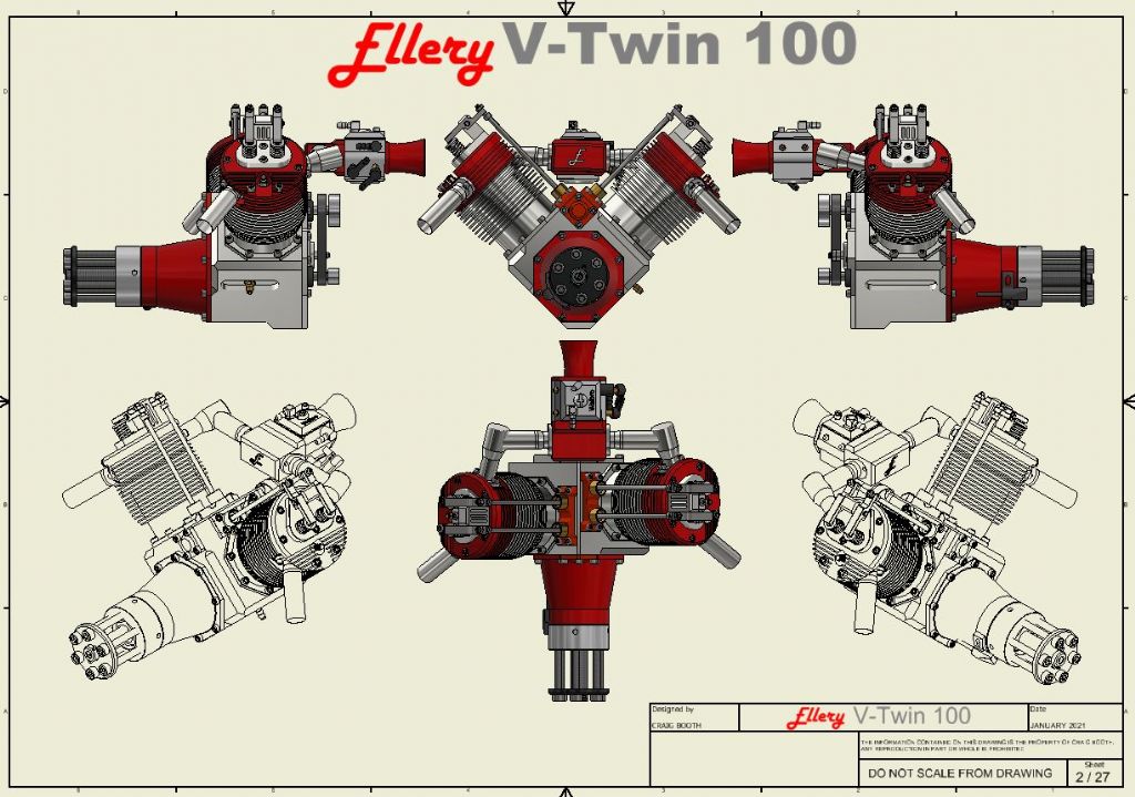

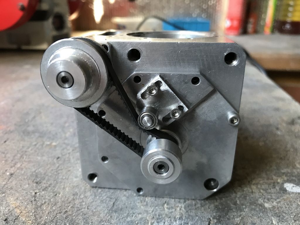

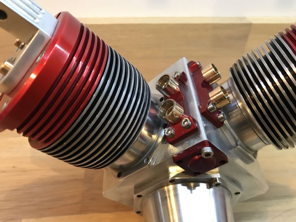

                                    Hi all, apologies, with everything happening last year a lot of things changed and I didn't get around to posting here. To close off the post, the engine is now complete and i've had it running a few times. I'm pretty happy with the design and performance so far. Range at the moment is around 1300-5500rpm (on a 24×10 prop). I've now got it stripped down to check for any issues.
                                    Hopefully if I can be confident in the performance I will get her up in the plane later this year. A few quick photos to close off.
                                    But for now I am starting to dream up a single cylinder 50cc version using similar geometry
