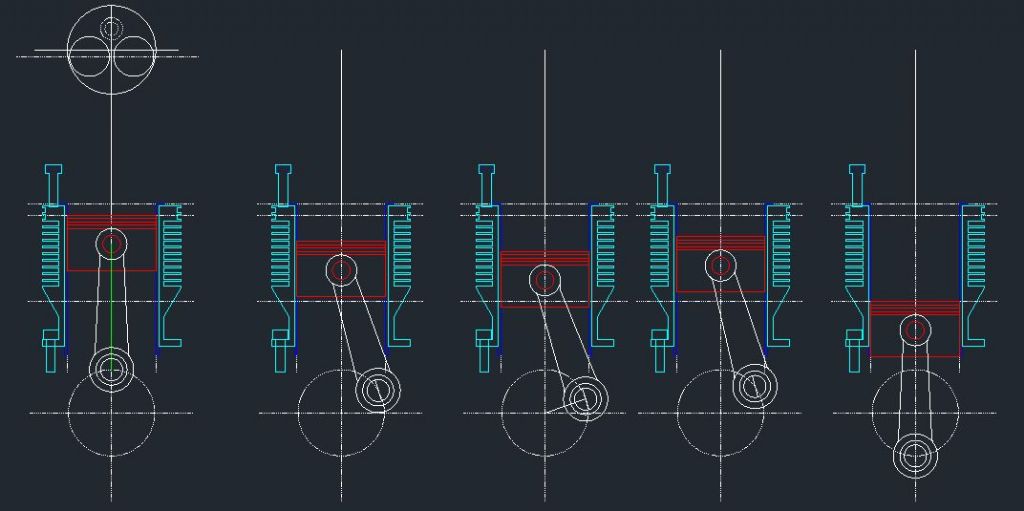

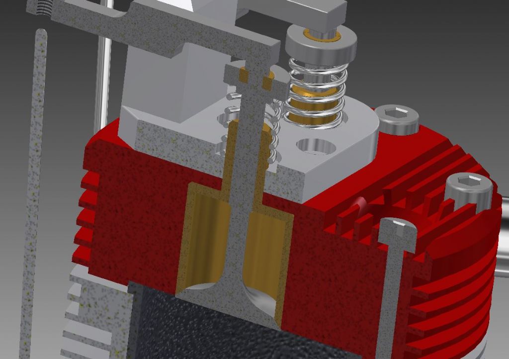

      Hi all,
      and so on to my next project. This is going to be a big challenge but have always wanted to design my own engine, so have made a start using some spare time this summer holiday.
      The engine type and size is based around a new RC plane I am also designing. The engine specs so far are:
      Type: V-Twin gas
      Capacity: 100cc (2 x 50cc)
      Stroke: 3.9cm
      Bore: 4.0cm
      Compression Ratio: 8.5
      Ignition: Spark

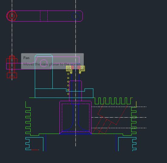

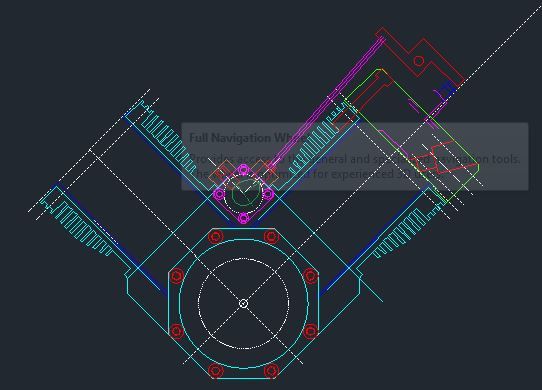

      My starting point was to draw the basic geometry in Autocad to check the key dimensions. Hopefully the time spent on this will reduce the problems I have later.

        #418099
        Emgee
          @emgee
          Did you consider less than 90 deg Vee to keep width less ?
          Emgee

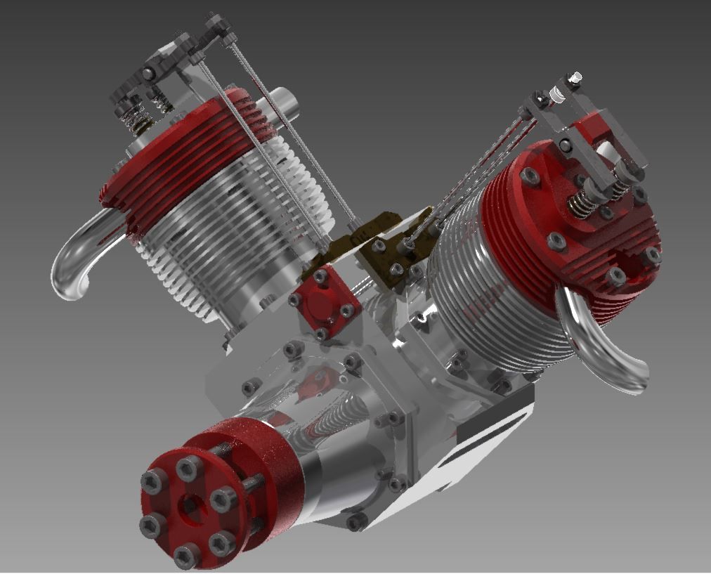

            next step was to draw everything in Autodesk Inventor. I am learner to this software but it is proving relatively easy to use and extremely useful in checking clearances, parts fit, and also checking the moving parts. Each part right down to the bolts are drawn as individual components and then "assembled" using physical contraints. Any subsequent changes to the components is automatically reflected in the assembled model. A big plus also is the it is extremely easy to output working drawings (and again these automatically update if any changes are made in the model).
            Below is rendered version from the assembled model, plus a series of screen grabs.

              Posted by Emgee on 09/07/2019 22:19:50:
              Emgee
              Hi Emgee, yes I did, but was struggling to get the cam shaft housing to work, plus the 90deg actually works well with the plane I am designing. The cylinder heads will intentionally project out of the cowling as I want them on show to suit the style of plane. (I will try to get a drawing of the plane uploaded soon)
              #418104
              Tim Stevens
                @timstevens64731
                Might the valve guides be on the short side? – resulting in valves not seating firmly, perhaps.
                And is the plate through which the valves work a separate part as drawn (but not illustrated in colour) – (increasing the problem, perhaps)?
                Regards, Tim

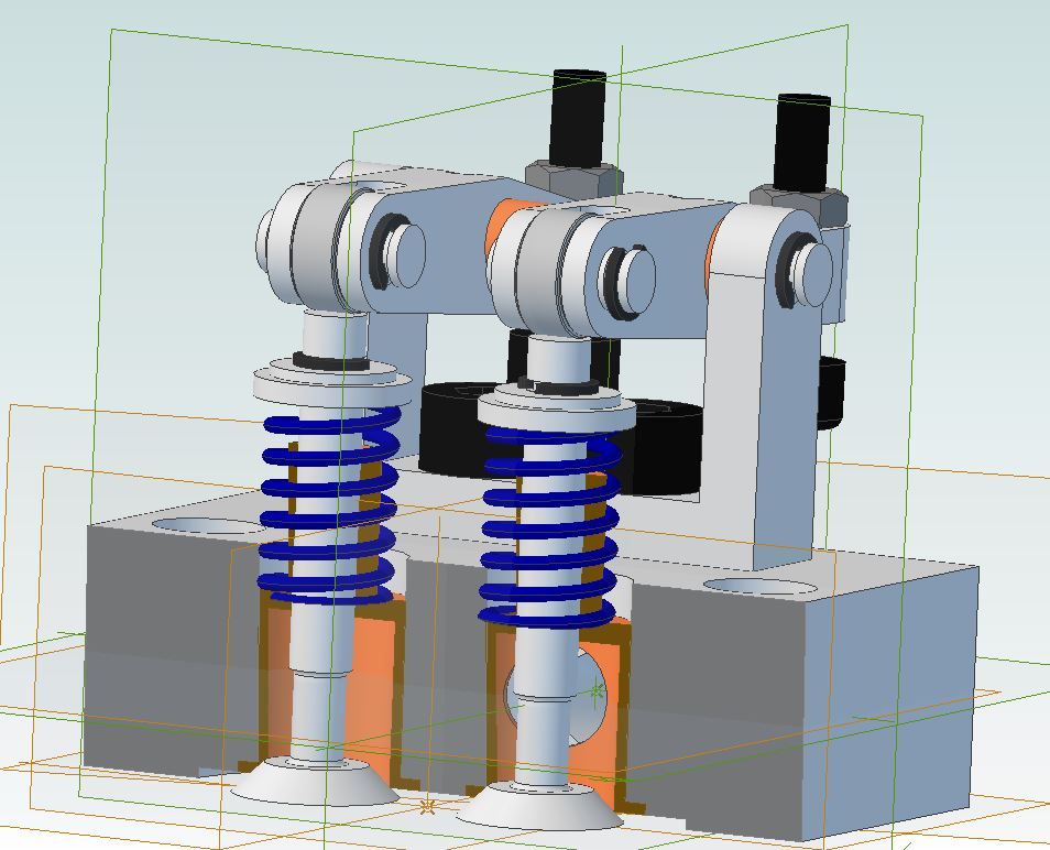

                #418108
                Hopper
                  @hopper
                  Big advantage of a 90 degree V-twin is perfect primary balance. Start closing the V up and they start vibrating. Vis: 90-deg Ducati motorbikes vs 45-deg Harley-Davidson.
                  Looks like a nice engine in the drawings there. Should look pretty cool in the plane with those exposed rocker arms sticking out in the breeze on full view.
                  Edited By Hopper on 10/07/2019 01:31:12

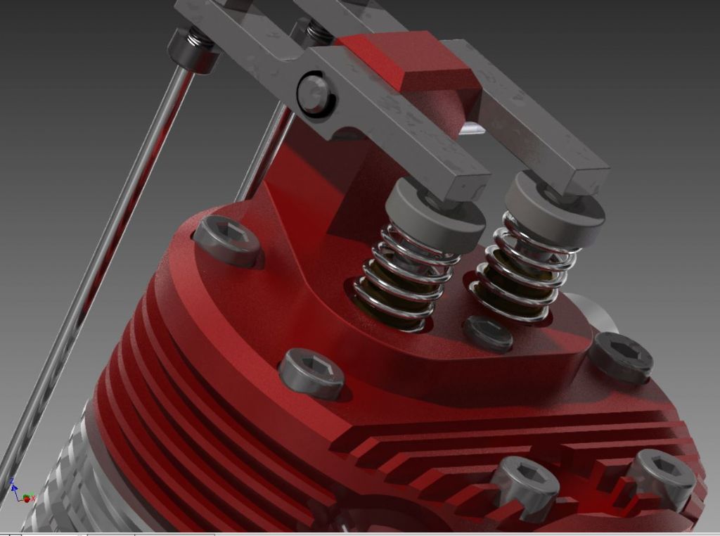

                  #418121
                  Craig Booth 1
                    @craigbooth1
                    Posted by Tim Stevens on 09/07/2019 23:09:27:
                    Regards, Tim
                    Hi Tim, thanks for the comments. I've shown a closer cut away below. The valve guide in contact with the valve is 13mm in relation to a 4mm diameter valve. The sleeve (colphos) also passes through the rocker arm bracket (aluminium), but the valve does no come into contact with it.
                    Let me know what you think. In my head 13mm feels about right to keep the valve aligned, but I don't have any reference to go by so happy to listen to experience.
                    While we are on valves, I am going to use a split collet/collar to retain the spring. My last engine used a circlip which makes me nervous about failing.
                    Cheers Craig

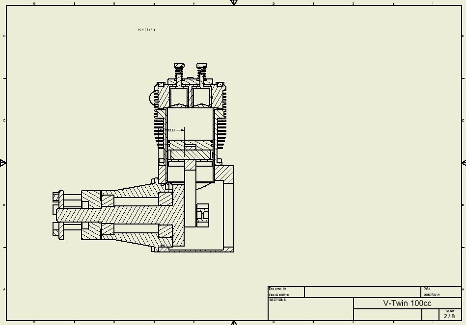

                      #418129
                      Niels Abildgaard
                        @nielsabildgaard33719

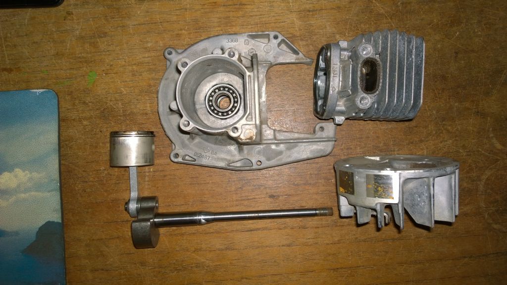

                        I think You need to reserve more space in crankcase for crank,counterweigth and conrod big-ends.
                        The crank shown from a leaf-blower engine balances all rotating and half reciprocatory forces.
                        To achive primary perfect massbalance i a 90 degree V-twin You shall balance all rotary and one reciprocatory totaly.
                        This means that Your crank will be two times as voluminous relative to piston as shown on picture.
                        Real production engineering
                        Edited By Niels Abildgaard on 10/07/2019 08:30:57
                        #418145
                        Emgee
                          @emgee
                          Niels
                          Isn't the greater weight of the counter balance shown in your pic a result of the heavy fan unit, on the model engine it will only be a much lighter prop driver.
                          Craig. You could extend the valve guides into the port if further guide length is needed.

                          Niels Abildgaard
                            Posted by Emgee on 10/07/2019 10:01:57:
                            Niels
                            Emgee
                            Nope.
                            The fan unit/flywheel with ignition magnets etc balances very nicely on the rotation centerline.

                              Posted by Craig Booth 1 on 09/07/2019 22:21:06:
                              You need to sort out the crankshaft bearing arrangement, I assume they are ball races.
                              #418158
                              Dave Halford
                                @davehalford22513
                                Niels
                                Emgee
                                prop driver plus prop.
                                I still think the valve guide is not supported firmly enough in the head.
                                The spring plate, being separate will have to be a clearance fit would it not?
                                That gives approx. 3mm of guide supported by the head, I would have thought that there would be a high chance of a crack forming at the base given the rotary movement of the rocker 'working' the top of the stem sideways over time.
                                But then I could be wrong

                                  Posted by John MC on 10/07/2019 11:41:51:
                                  Hi John, can you please expand more on the crankshaft arrangement. Yes, they are deep groove ball bearings. Main bearing open, nose bearing sealed only one side, what is not shown yet is the rear bearing and second crank web.
                                  cheers Craig

                                      #418166
                                      Tim Stevens
                                        @timstevens64731
                                        My concern about valve guides is only partly to do with strength – and others have commented on that aspect. The other part of the problem relates to heat transfer. The exposed exhaust valve stem takes in heat from the exhaust gas, and the part in contact with the guide loses heat into the cylinder head. In your design there is too much exposed and not enough in contact.
                                        Another heat concern is the cooling of that area of head, which is exposed to a large area of exhaust port, and has no fins. You might think that modern engines don't seem to need fins here, but they are drenched in oil, which carries the heat away. Your system relies on no fins and next to no oil …
                                        It may also be a problem with the whole exhaust port as a separate insert of bronze. This adds an extra joint where heat must be conducted, and this relies on real firm contact at all times. The port will heat up faster than the surrounding metal (although its coeff of expansion is going to be similar), so even if everything is tight on manufacture, the joint will soon cease to fit firmly everywhere. If you are reconsidering this area, I would suggest that the sides of the port are directly in the head aluminium, with a lid comprising the guide and a flange, in bronze. If the flange extended as a fin, that would be an advantage.
                                        But then, what do I know?
                                        Tim Stevens
                                        [Silver medal, motorcycle engineering C&G]
                                        Edited By Tim Stevens on 10/07/2019 12:32:49

                                            @johnmc39344
                                            Craig, the bearings need to be constrained correctly. Its a rotating shaft so the inner races need to be clamped to the shaft. As drawn, when the engine gets hot axial load from the expansion of the bearing housing (al/alloy?) will put extra power absorbing axial load on the bearings
                                            One of the outer races needs to be fully constrained so an interference fit in it's housing and one side against an abutment in the housing and, in this application, a circlip (space/weight considerations) for the other side, that is to say the bearing cannot move axially and therefore provides the axial location for the crankshaft.
                                            The other outer race needs to be able to move so a transition fit in it's housing but not against any abutment. This is so the bearing can move (a very small amount) as the engine gets hot. This will stop the bearings taking unnecessary axial loads.
                                            The SKF catalogue has all the information on tolerances.
                                            You could consider a fully constrained ball race for axial location at the drive (propellor) end of the crank, that would locate the shaft and a drawn cup needle roller (hard steel sleeve pressed on to shaft) at the other end, absolutely no risk of excess axial loading.
                                            I see the incorrect mounting of rolling element bearings in the model engineering world all too often, has there never been an article in ME to show the right way?

                                              #418199
                                              Dave Halford
                                                @davehalford22513
                                                The much more substantial roller rockers in the Stride design would help a lot, though guides seem to be stronger than I thought they would be

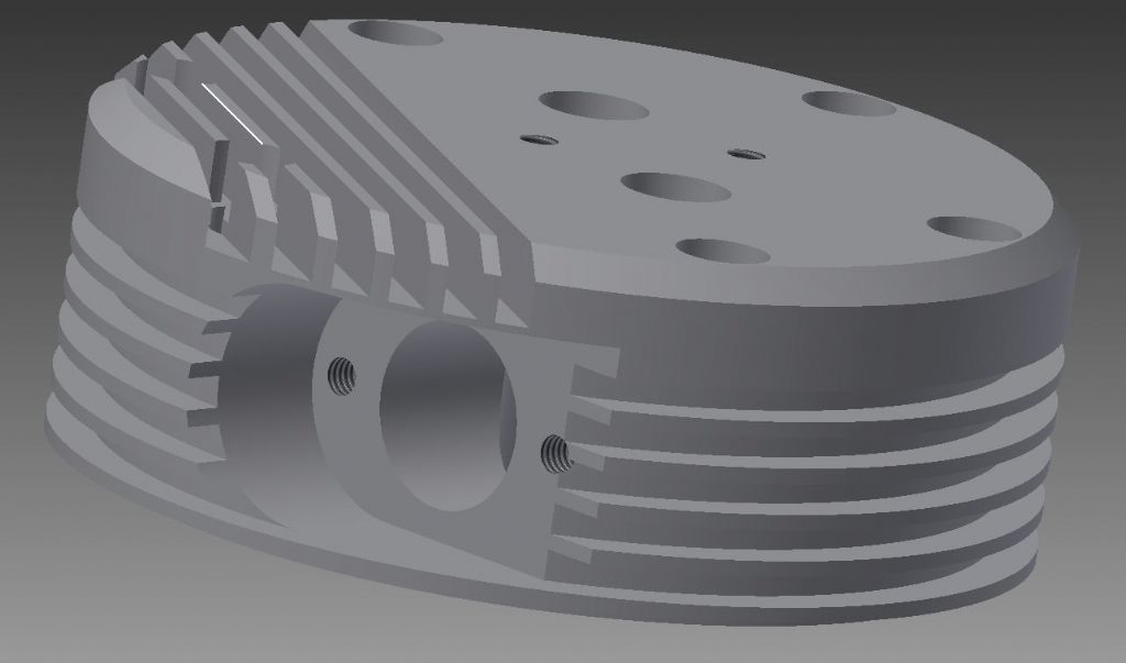

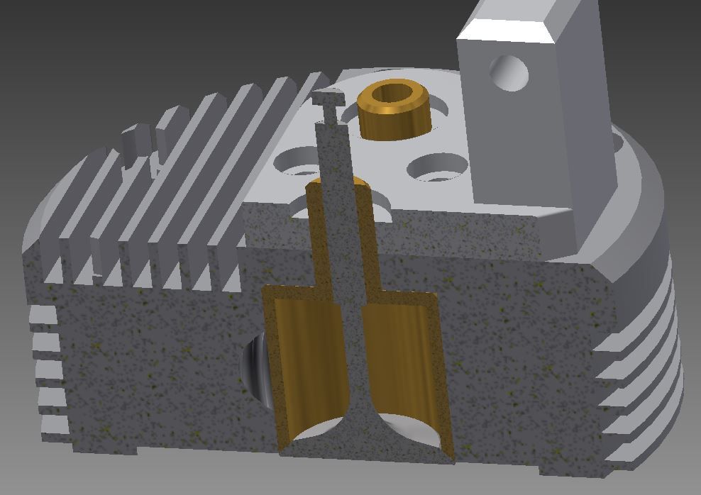

                                                #418300
                                                Craig Booth 1
                                                  @craigbooth1

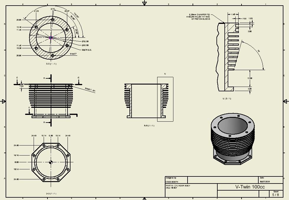

                                                  Cylinder head altered a little, increased height by 2mm which allows better sleeve support and also slightly larger fins.

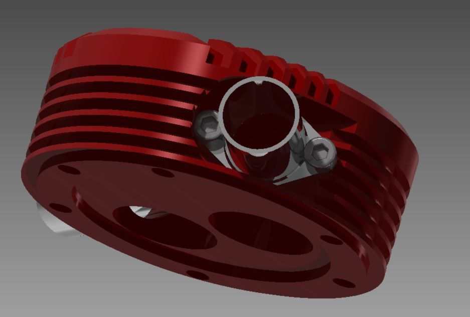

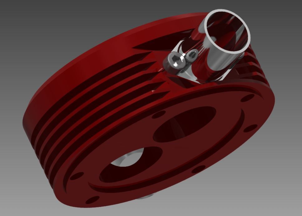

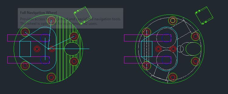

                                                    #418407
                                                    Craig Booth 1
                                                      @craigbooth1
                                                      Some more work on the head to change the inlet/exhaust connection. I now have a plate connection which will allow me to easily make the manifolds that will be need to be bent to shape to suit the cowl. Manifold will be copper, silver soldered to flange. The lot can then be chromed.
