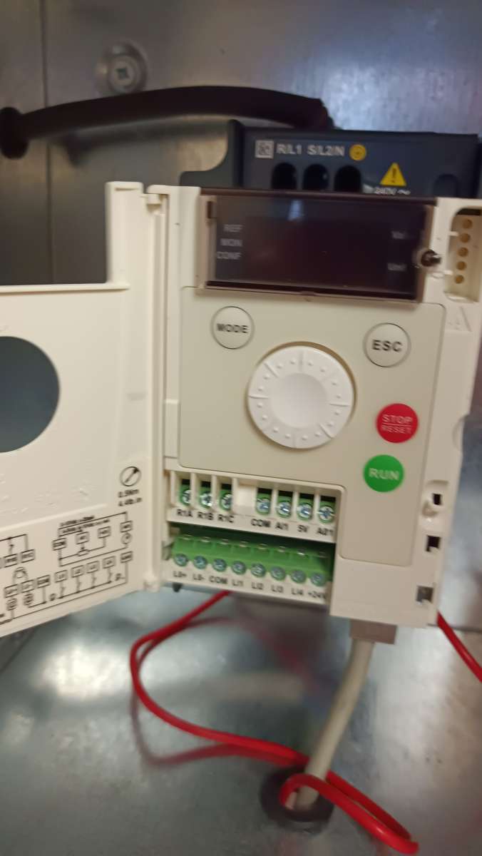

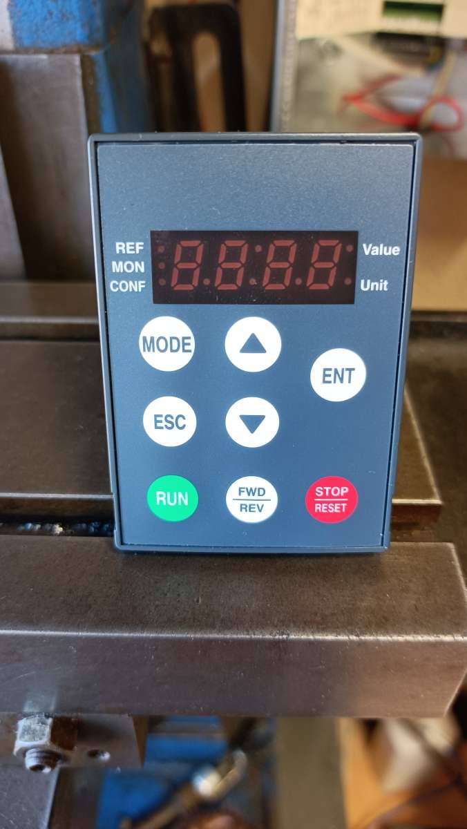

      The remote (RJ45) terminal used to work perfectly, all buttons operative.
      After a reset to factory defaults and entering motor details the ATV12 works and the jog dial is fine.
      All the buttons on the terminal work except ‘run’ and ‘forward/reverse’.  I must have previously altered some parameters on the ATV12 but have forgotten which.
      Any help greatly appreciated.
      Chris

          Thanks for that.   I already had those manuals from IDS but had not found anything stated about having both the remote and local control available.  I know it’s possible because I had it set up before.  The wiring is as simple as it gets as there is just an ethernet cable between the ATV12 and the display.   The parameter settings are another matter.
          ATV12VW3A1006
          Chris

                  I have tried using a different cable, no change.
                  The remote display communicates with the ATV perfectly as regards setting parameters, stopping, changing values.
                  Page 34 of my Altivar-ATV12-Manual describes using SoMove, what do you see on page 34?
                  The only two buttons which do not work are ‘Run’ and ‘Fwd/Rev’.
                  Looks like I’ll have to try Schneider direct.
                  Regards,
                  Chris

                      Yes, I’ve seen that page relating to the remote unit.   Those values are set correctly and all remote buttons work as expected except ‘Run’ and ‘Fwd/Rev’.  I have a copy of the modbus manual but that doesn’t help me much either.  I tried the links as well but nothing helped so far.
                      I’ve had the unit functioning correctly but after a factory reset of the ATV12 I must have forgotten an important change!
                      Kind regards,
                      Chris
