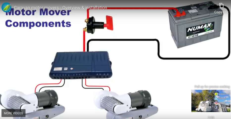

Graham says he’s repurposing a Caravan Mover, so I think the answer boils down to how many amps have to be switched. Here’s an example of the beast (two movers needed per caravan, with one controller):
The circuit shows the movers are powered by a 12Vdc battery, and judging by the size of the wires I guess 10A to 20A.
Fitted to a caravan, there is only one switch fitted in the red positive lead. But this is an isolating switch and most of the serious switching is done inside the blue/grey controller. It obeys orders from a hand-held remote. As the controller is slim, I guess it’s semiconductor switched, not by a relay. No matter: Graham can switch his motor however he wants, provided the contacts in the switch or relay can cope.

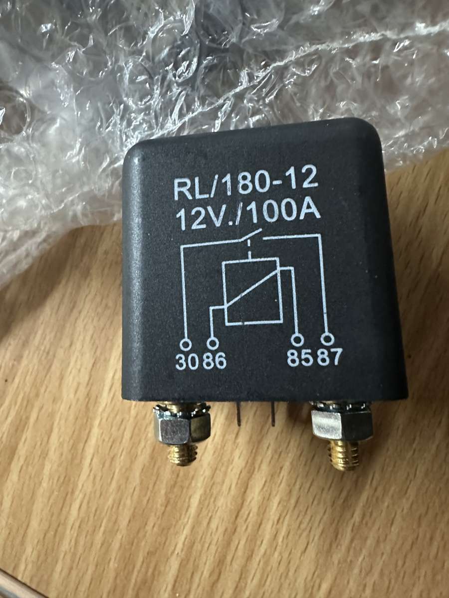

High-current DC switches are a little difficult to find, in which case it might be necessary to use a relay, or same thing, a contactor. (Folk with an electronics background tend to call them relays, chaps who do power tend call them contactors: same difference!) Relays allow a small or remote switch to control a big current, just make sure the contacts are rated for it.
