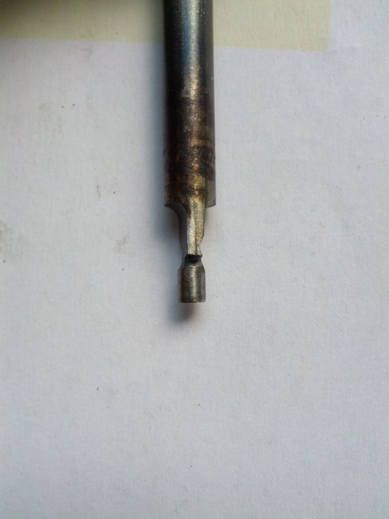

                                        Paul Lousick
                                          @paullousick59116
                                          Home made counterbore made by AdrianR in a previous post
                                          **LINK**

                                                    #487050
                                                    AdrianR
                                                      @adrianr18614
                                                      How embarrassing, having my counterbore quoted. Don't make one the same as mine, it has a numpty mistake, it runs backwards. What is worse I sharpened it three times trying to make it cut, before I realised my mistake.
                                                      Once the reverse button is pressed it cuts a perfect counterbore, lot cheaper than buying a set too.
                                                      Adrian
