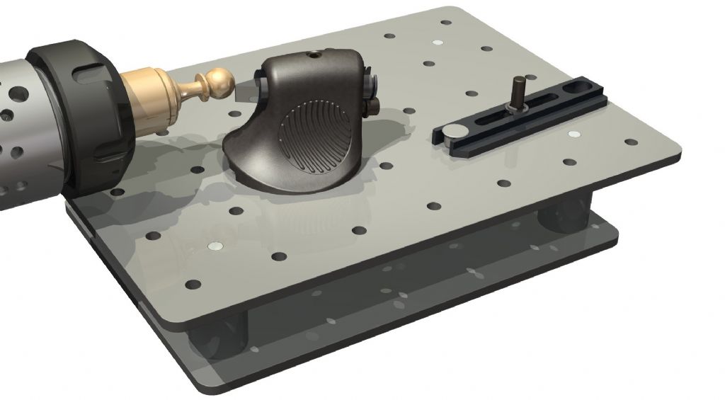

          If the work is larger – then perhaps something like the Eccentric 'Turnado' system might be better. I've considered making a simplified version of this device for a particular job where I need to make a few awkward items all the same and the use of a template would be useful.

                    An option is to make/buy a tool like the "Turnado" made by Eccentric Engineering. (advertised here on MEW)
