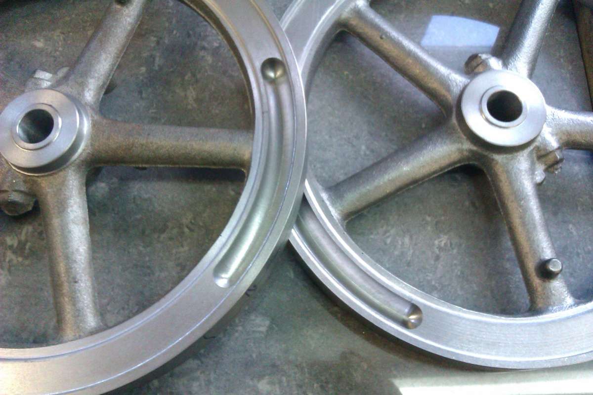

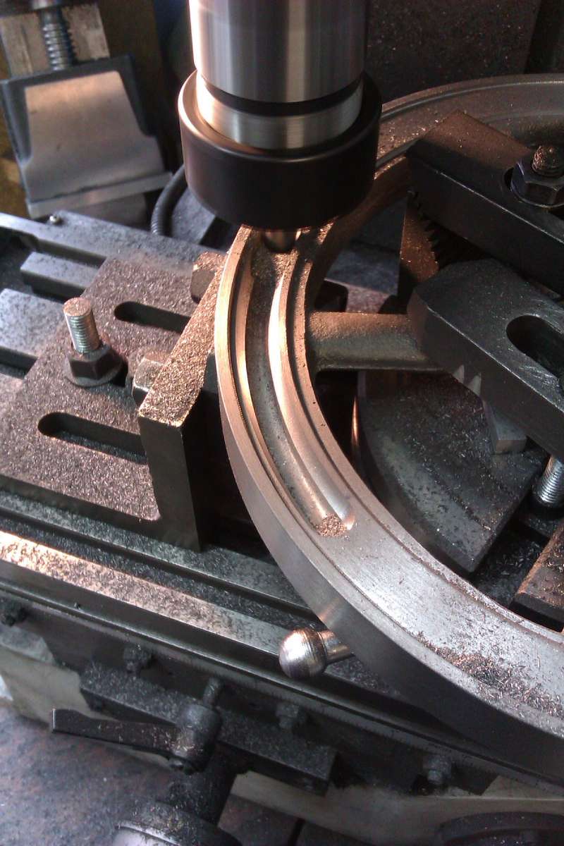

          #774299
            Not easily seen but there is a piece of metal clamped to the angle plate which gave a bit more support to the overhanging rim while the half round balancing grooves were cut with a 7/16″ ball nose cutter.
            IMAG2471
            Not too shabby
            IMAG2484
