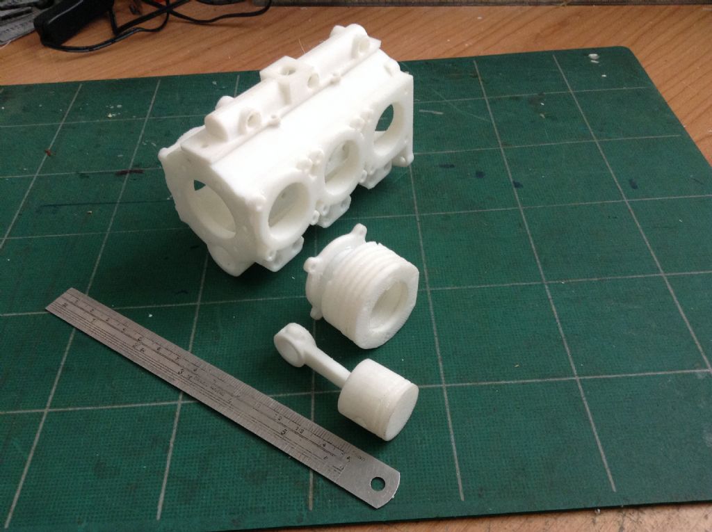

                  Having just acquired a 3D printer thie last 7 days has been a big learning curve but also great fun. I am looking forward to developing the prints as patterns and core boxes for sand casting. The photo shows my efforts with parts for an IC engine ( a flat six) . The engine was a "theory" design and was never made but it's good to see it in 3D.

                    My interest in casting has led to an interest in using 3D printing to make patterns for sand casting. There are some caveats. The machine at the price I am likely to spend will probably break from time to time and will also probably need some sensible modifications. Going on results produced by various people there is clearly a learning curve as well especially related to machine settings.
                    3D printing can be used to make all sorts of things. It's another area where just like a lathe it fits in with an interest in astronomy. That's just a for instance. I'm also interested in model aircraft and helicopters at times. From my product design days I know that ABS is one of the more interesting plastics but it seems nylon and polycarbonates are also possible but have their own problems.
                    The main problem with 3D printing really is that it's incredibly slow otherwise it would probably be used to make all sorts of things. As it is it's basically most suitable for prototyping.
                    Looking at previous posts – pay some one to do it. I suspect that would be a none starter compared with owning one of the cheaper one such as rep rap etc. The process also has some limitations on what can be printed but things like twin extruder printers are available –frown I wonder if they are any good. I suspect I may be finding out at some point but gluing 2 parts together is probably a more sensible approach.

                                    Many ways to skin a cat, as have already been mentioned, and all have their place, but quite often just because you can use a particular approach does not make it the best or most cost effective.
                                    I could have made the plastic parts for my Buildlog laser cutter by milling them from Acrylic or HDPE or laser cut them from acrylic, but chose to 3D print them, time taken to produce them was much higher, but the material cost dropped from £20+ to pennies, plus I did not need to babysit the printer. The other manufacturing options were all available to me, just as viable for making the parts in question, and would have taken less time but I chose to base my choice on raw material cost.
                                    3D printing for investment casting or mold making are both viable options.
                                    I believe 3D investment printing makes more sense for smaller detailed items where the time taken and filament required to print is low – a friend of mine has had great success with his cuff-link designs, sending them to Shapeways, he uses the various plastic options for proofs of concept and fine tuning the design, then various metals via lost wax investment casting for the finished items, all at reasonable costs (small items).
                                    For larger items, like say a flywheel other methods may make more sense, your more typical wooden mold, or possibly a polystyrene foam investment option.
                                    Building a polystyrene foam investment from regular shapes and gluing them together (mikesworkshop), mill them from foam or use a CNC hot wire cutter for more complex shapes again with the option of gluing on sprues, etc, all with a cost of pennies for the foam even for quite large items.
                                    If you want better surface finish, then try coating the polystyrene in plaster for a smoother finish, then simply bury the item in play sand and cast directly as shown at buildyouridea
                                    Just some more ideas for the pot
