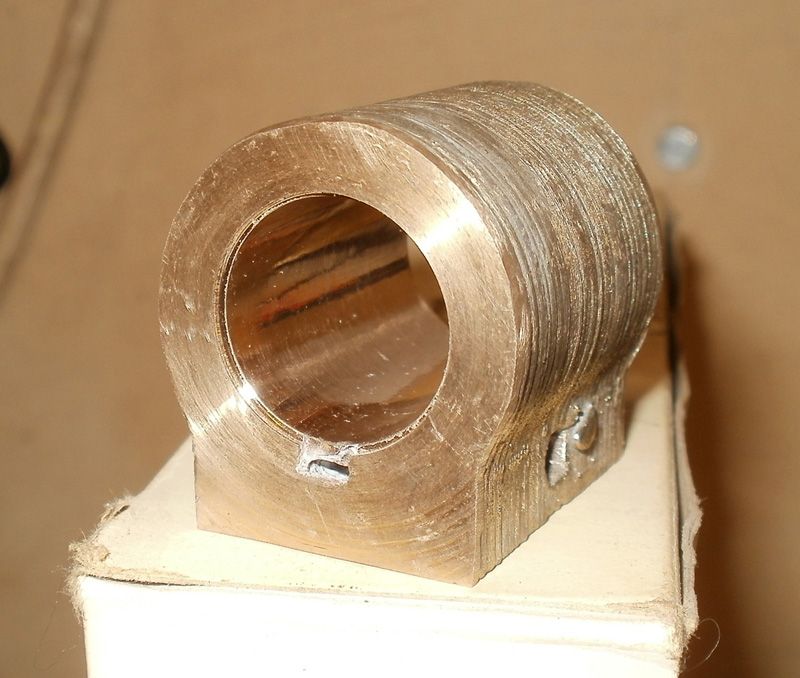

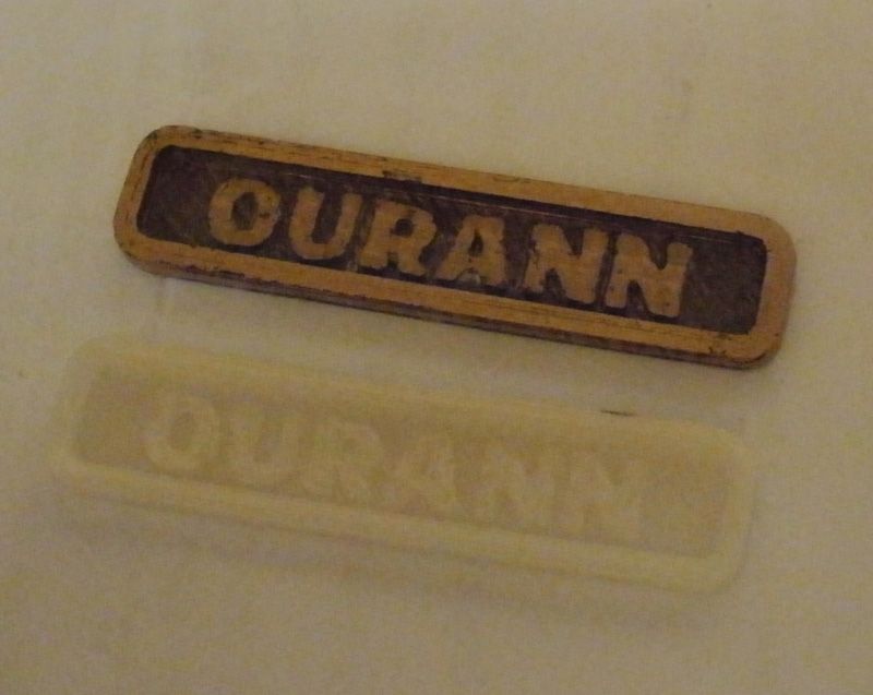

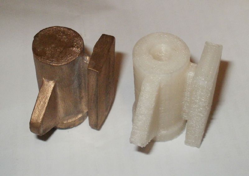

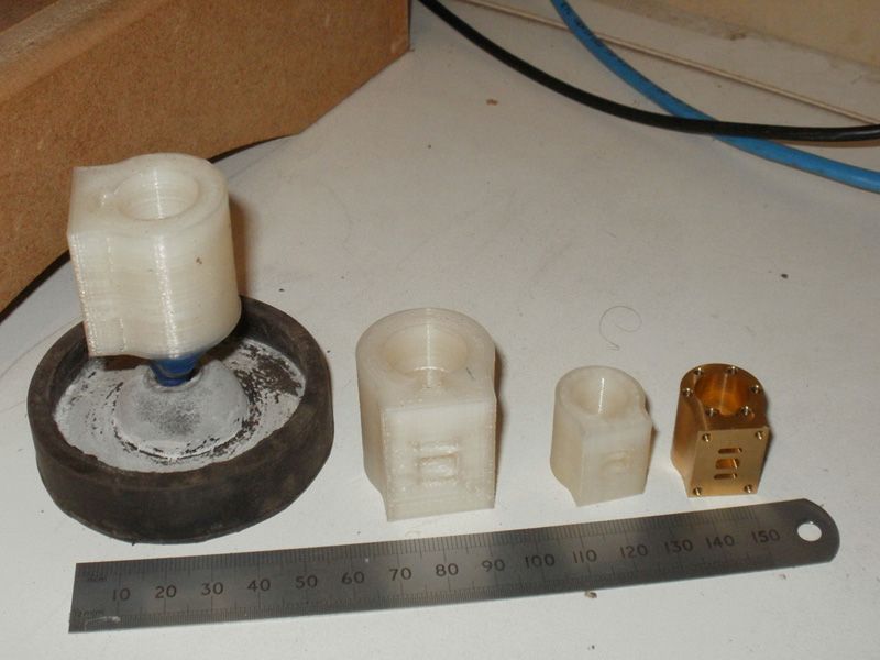

        I have found pla burns out nicely when printing lots of precious metal items (it's the day job) but more importantly things like this:-
        or
        which is the pump body for a sweet pea so I could practice on one before butchering the the real thing on the left since it is for the new club loco.
        This shows the model sprued up ready to invest with another scaled up model and the original brass cylinder with a 1 to 1 copy in pla. All steam passageways are cast in but I should leave some meat on the valve openings to clean them up.
        cast in gunmetal as a test and the brass pair now adorn my MarieE, it is the normal method of address for my particular SWMBO.
        Now if I could just melt cast iron ………
        Andy
        Edited By AndyP on 19/02/2015 21:43:00

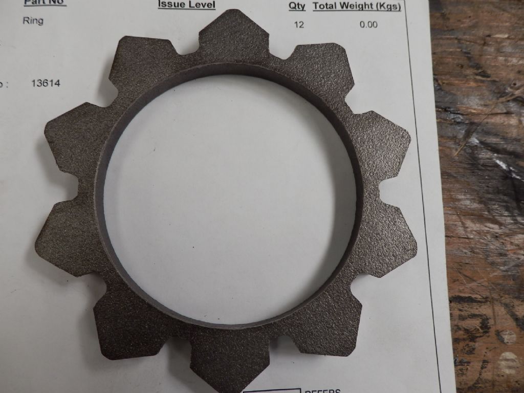

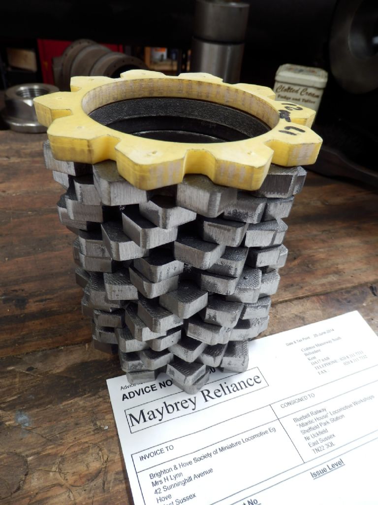

          Hello all,
          Following on from DMB's post re the Brighton and Hove SMLE brake shoe rings please see attached photographs of the said shoes, including the CAD 3D drawing, the CI rings and pattern and an as received cast iron ring.
          Regards,
          Bob Youldon

          #180483
          Chris Pattison 1
            @chrispattison1
            Bob,
            Personally, I would have gone the laser cutting route for those brake shoes. It may have been easier. Provided of course that you could get cast iron solid, to then cut into slices of appropriate thickness.
            Regards,
            Chris P

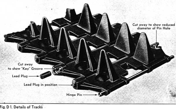

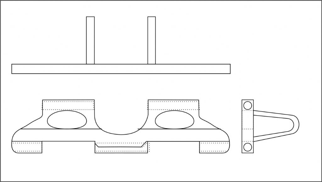

                I fancy printing tank tracks. The thought of milling 200 links from aluminium and then having to anodise them to make them a decent colour fills me with dread.
                A dark grey ABS print would be fine for what I want, and only a few holes to drill in each one.

                Bob Youldon
                  @bobyouldon45599
                  Good morning all,
                  Re:
                  Personally, I would have gone the laser cutting route for those brake shoes. It may have been easier. Provided of co urse that you could get cast iron solid, to then cut into slices of appropriate thickness.
                  Chris, laser cutting was considered and in the prototype passenger car the shoes were originally laser cut in steel, but it was the opinion of the building group cast iron against the steel bogie wheel is a much better propersition so therefore the decision was taken to go the cast iron route.
                  Seems a shame getting a pattern done like that without taking the opportunity of getting a bit more detail into them.
                  Eric, as the shoes are destined for use under passenger cars, there was a need to produce a simple repeatable component, there was a requirement for in excess of a hundred and in normal use they will never be seen.
                  I will say the effectiveness of eight shoes per car in stopping a loaded vehicle is very impressive.
                  Regards
                  Bob Youldon

                          Hello Bob.
                          Wrt to the castings – they look very clean and tidy. This is probably a silly question but I can’t see any signs of risers or sprues on them – any idea on how they were cast ?
                          Thanks.
                          W.

                              Bob Youldon
                                @bobyouldon45599
                                Good evening Wallace,
                                Re the castings, as received from the foundry they had been fettled and any risers or in gates had been removed, they must have spent some considerable time on them; the photograph of the stack of brake shoe rings is exactly as we received them from the foundry. I'm afraid I cannot help with their moulding and casting process, off went the pattern, back came the rings, simple as that!
                                Regards,
                                Bob Youldon

                                    #180645
                                      They would be anything from 3/4" to 1 1/2" long, I haven't decided on a scale yet.
                                      I reckon it would be possible to print them in quite big batches at a time. As Jason says I could get on with real life while they printed and anyway the length of time is irrelevant as it's something I've been musing on for years – a Vickers Light Tank, My main interest is in making working suspension units, but a bit pointless without a route to a full model!
                                      I also want something a bit more space-friendly than TIger tank.

                                                #180725
                                                  Neil, biggest problem I see with your tracks if printed on a home machine is that the "teeth" that stick up will be very weak as the print could fracture between layers a bit like short grain on wood.
                                                  Is it for a static model or RC?
                                                  As I said if you are not going for a perfect match (two different drawings) then you can buy aftermarket tracks for the RC tanks, about £10 for a set of plastic and from £40 for metal at 1/16th scale which would fit within your scale range.
                                                  Edited By JasonB on 22/02/2015 08:01:41

                                                      > I wonder if Neil conducted his recent survey with that possibility in mind.
                                                      No…
                                                      R/C. The crude drawing was to help me figure out what a link looked like from photos of the outside of the track, the lower drawing is obviously from a contemporary manual. It's surprising how different the links look from the inner and outer faces – the major one being that the central hole is a large round scoop on the outside with another 'layer' on the inside with a smaller, squarer, hole. I misinterpreted this in the pictures as part of the sprocket wheel, and I hadn't understood the 3-D shape of the teeth at all well. I'd obviously have to redraw it in much more detail.
                                                      I don't think it would do any harm to make the 'pyramidal' teeth a bit broader at the bottom and rather less hollow to make them stronger
