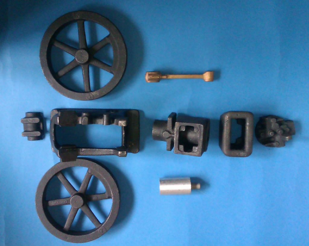

      Here in NZ, if I were to order castings from the UK, not only will these be very costly, but I suspect that their shipping weight will add substantial cost to their purchase. So, with the advent of 3D printing, I wonder if anybody has explored making patterns for either sand casting or lost-wax casting of parts? In the long run, these 3D programs could be exchanged across the world at minimal cost.

          3D printing of patterns, and direct 3D printing of wax is becoming commonplace in commercial casting.
          Compared to hiring a pattern maker, 3D printing is quick and relatively cheap. The 3D file can very easily be derived from CAD design files – a scaling operation and add draft where required.

              David, what sort of cost would one be looking at to print out say a set of castings like these, thats a 6" flywheel for size. I know what they cost me to get shipped from the US, cost of casting would be comprable in either case.
              I know of a few Builders in Australia that have made their own patterns or fabricated the simpler parts but still found it more cost effective to have the complicated castings like cylinders shipped fropm the UK. Also know of a crake containing about a tonne of castings that has recently arrived over there.

                    Sorry – can't help with pricing of 3D prints. Depends on system used, how you factor the capital cost of the printer, size, any support materials needed in the print process.
                    One way to get a feel for price would be to upload part files to one of the bureau services that now abound. That would obviously include delivery and a profit margin.
                    For fine scale stuff – optical or inkjet based systems are probably the way to go, for larger stuff fused filament printers might be OK.  There are a few 'castable resins' or waxes available.

                          One problem I see with using printed parts as the master or to burn/melt out is that nowhere is there a button on a CAD package that gives you the experience of a good pattern maker.
                          If you print out the item as you want it to look with scale, draft and machining allowance added then have it printed in say wax and then cast what happens if there is excessive shrinkage in a bulky part that a good pattern maker would have forseen and added extra material or larger gates to fill this part as it cools.
                          Now with a wooden pattern at least you get a second chance as you can add a bit to it or just cast it again in sand with suitable feeders. If burning or melting it you would have to print the part again.

                              Well did a quick look at costings from a couple of googled sources. Based on just one 6" flywheel
                              Sent a STL file to one with instant online quote, choice of colours, done on Ultimakers, from photos on their site looks quite basic quality but came in at £101.
                              Using a basic guide for the volume on another site in white nylon with a good quality surface finish cost would be £112.50.
                              Given that I got that whole set of castings posted from the states for $105 it may just work out a bit cheaper if I want a poor finish on the parts.
